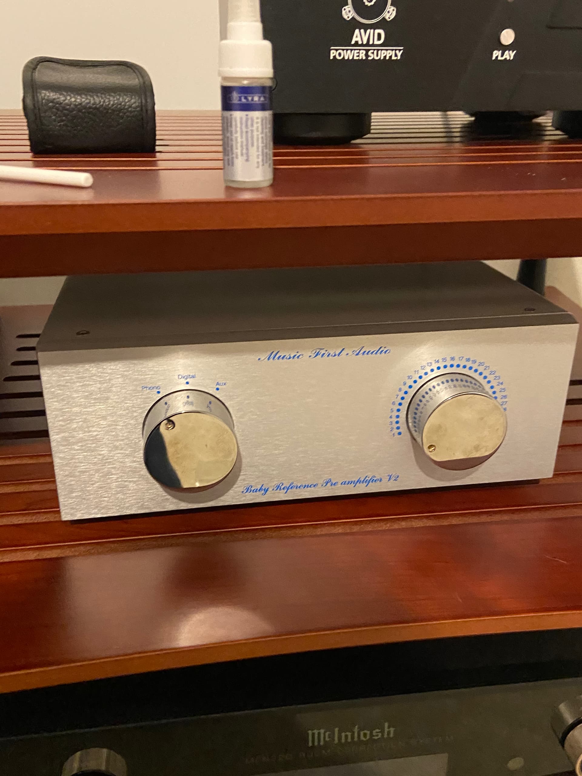

I have been using a Music First Audio Baby Reference TVC passive amplifier for a number of years. My main sources are vinyl (Avid Acutus) and streamer (Naim NDX2). My current power amplifier is PS Audio BHK250 but I have previously used Chord Electronics SPM 1200E, Naim Nap300 with absolutely no issues at all. Being Transformer Volume Controlled (TVC) the amp does not suffer from the same issues of soft bass and compression that can be levelled at some passive amps.
I love my MUsic First Pre and would not swap it for any active pre. It adds nothing and takes away nothing from the signal coming from the source components.
The other passive amp often being used with Naim amps and raved about by some reviewers, is the Townshend Allegri Reference. I have listens to this amp and like it but prefer my Music First audio pre
