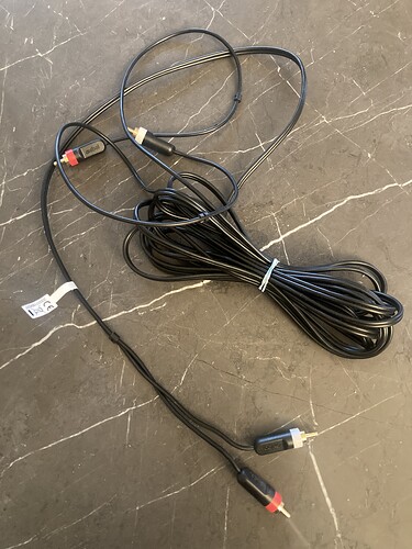

Mogami 2497 works well from turntable to phono stage. Cheap as chips also!
I have used this between my turntable and riaa. And from riaa to preamp. Had a high end dealer that said the sound was wonderful.
Do not use too much money on this stuff. I do not believe so much in differences in sound quality, but the pleadure of ownership is something else.
