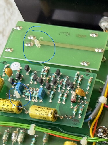

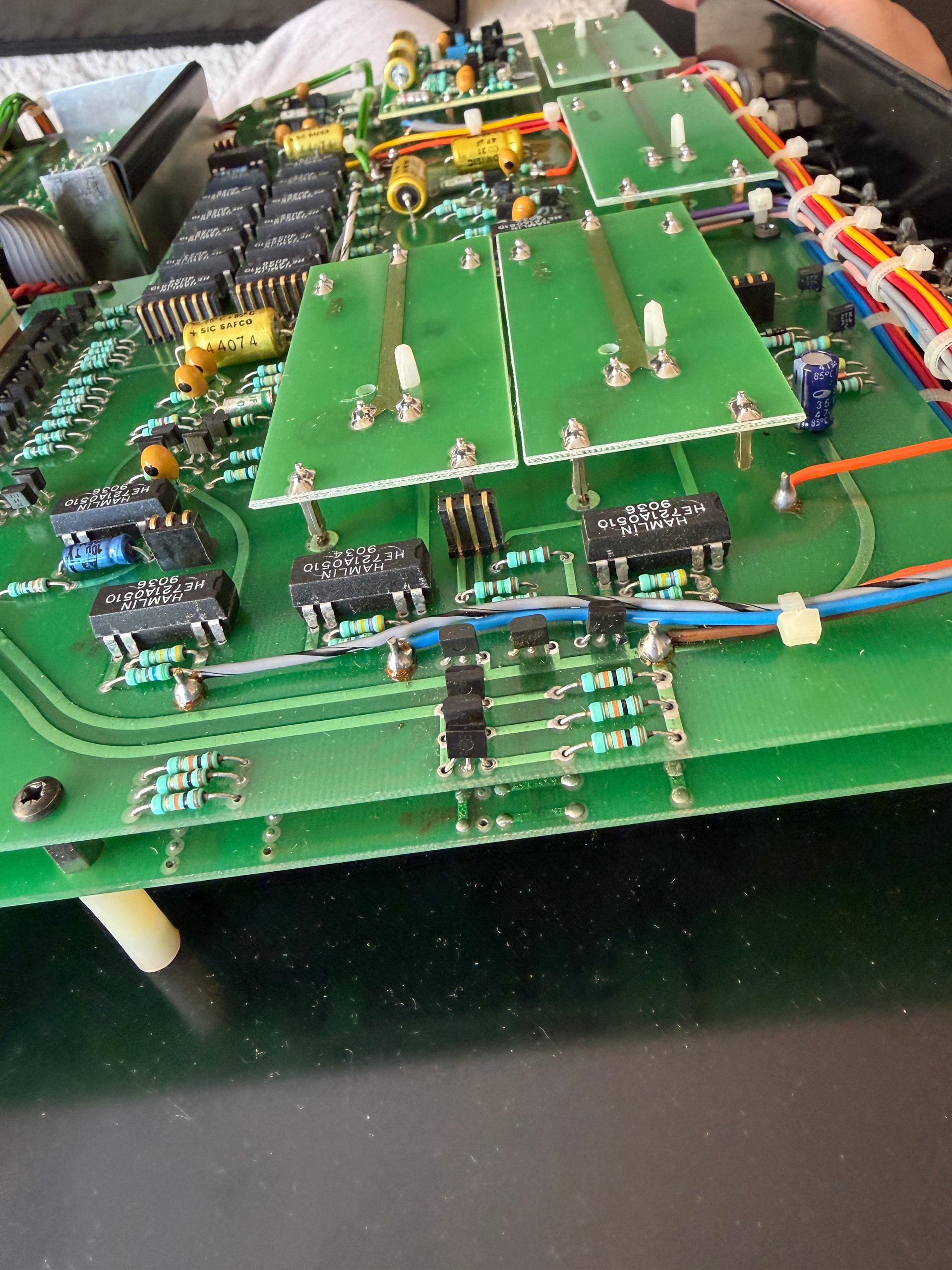

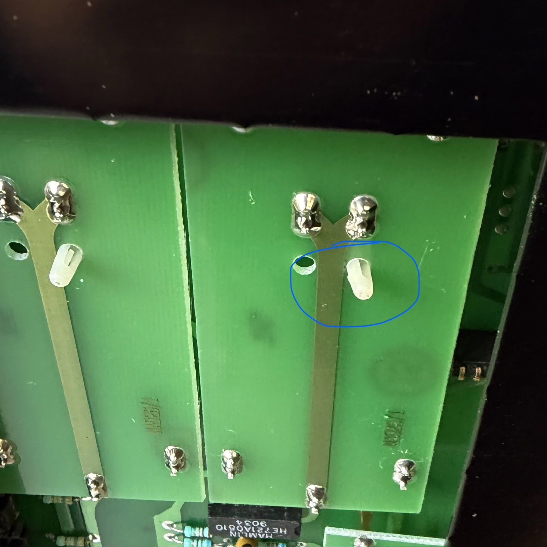

Before you do anything, unplug the 52 head unit, undo the feet and carefully slide back the outer sleeve, then check that the boards are fully seated on their pins and the plastic retaining tabs are engaged - there is one board on top and the other underneath (acres through a hole in the chassis tray).
I opened it last time and was pretty flumuxed by the layout and was unable to find any pictures or explanations online (lots of searching). So I just sort of gently pushed everything I could see to check that everything was seated in. But frankly I didn’t know what I was doing - nonetheless less if sorted it out, at least for the past few months but now appears to have come loose again. Hence a trip to Grahams to have someone who knows what their doing, have a look.

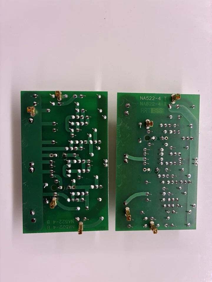

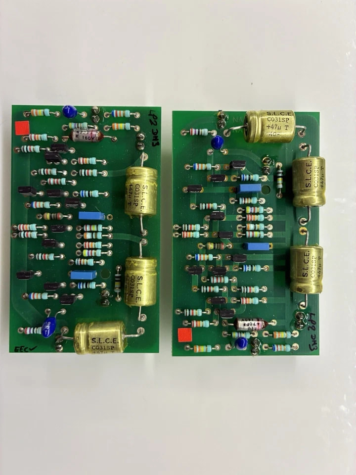

I hope you don’t mind but wouldn’t mind tapping your superior knowledge, and apologies if these are stupid questions but… when I look at the pics Juiushui sent showing “the tabs”, It’s a very sparse board and they do not seem to match withany I can find on web searches where both sides of the boards are much more busy, Here are a couple from an ebay ad. This confusion is what concerns me about tackling anything my elf as I dont know what to look for. Interested in any thoughts or explanation you (or anyone else) may have may have. Thanks. Kit
Oh that’s an interesting picture, I have question,
if mine is the same inside with them straight through boards, could I take input 6 cards and put them on input 1, and would the phono boards work on input 6
Thanks all. for you help. Ray at Grahams HiFi fixed the problem - a loose phono card. He showed me where they were accessed from. I’m am such an idiot, I didn’t even know that there was access to them from underneath - so was sooo confused by only the overhead view. Live and learn (slowly) . Next up a Karousel ,which is on order then possibly a Keel towards the end of the year.
