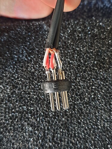

It could be the cable or the NAC. I should start by suspecting the cable. Who made it up? Did they connect the right pins? You could also look inside the din plug on the cable and make sure the soldering isn’t bridging to earth for example.

As an input cable, the pins are wired correctly on the DIN plug. Check the RCA end too.

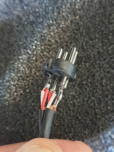

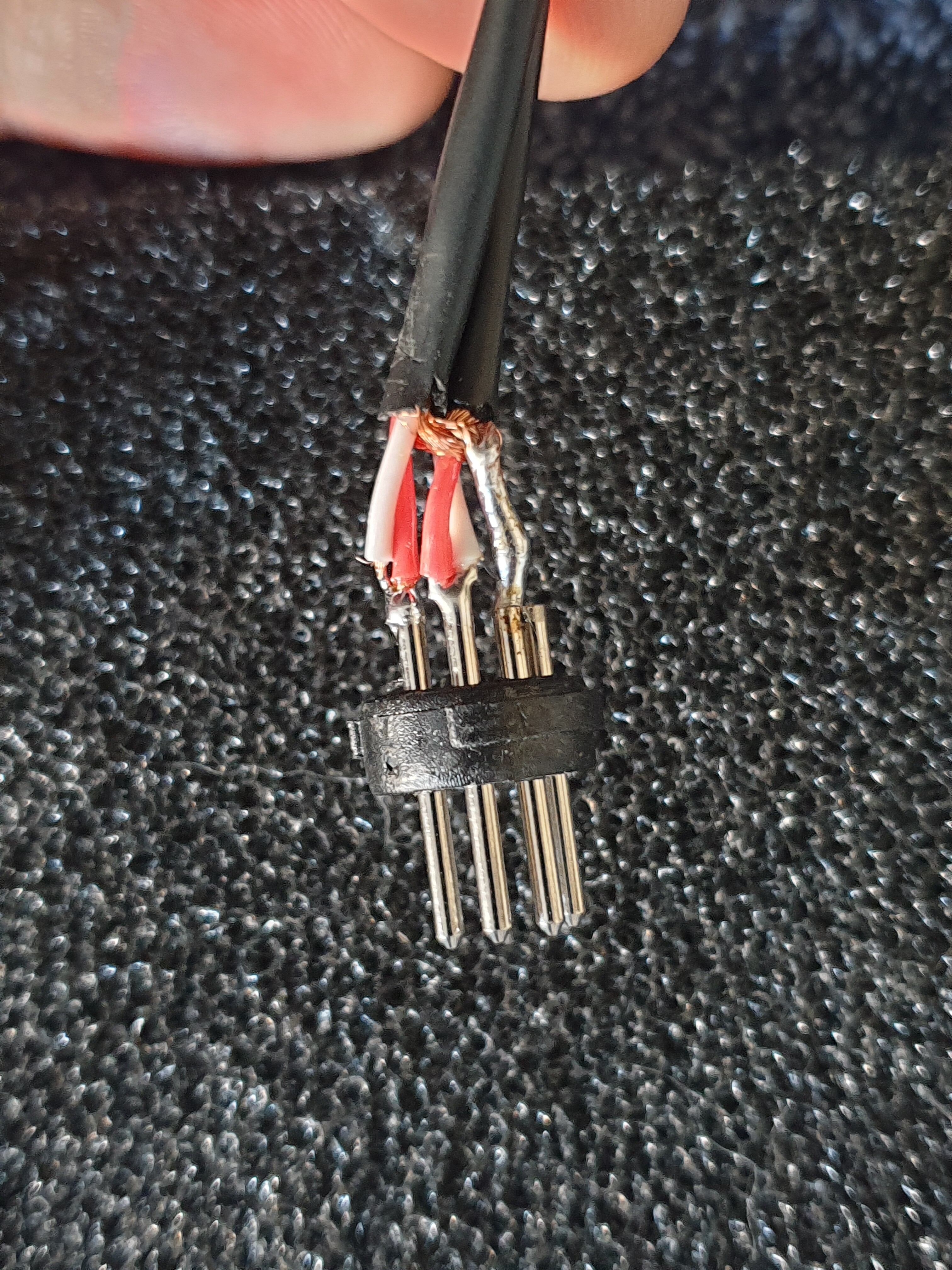

There is a whisker of wire from one of the signal pins. That might have been touching the case of the din plug. Not sure whether that is the channel that didn’t work…
It would also be worth trying the cable with the din plug cover off.

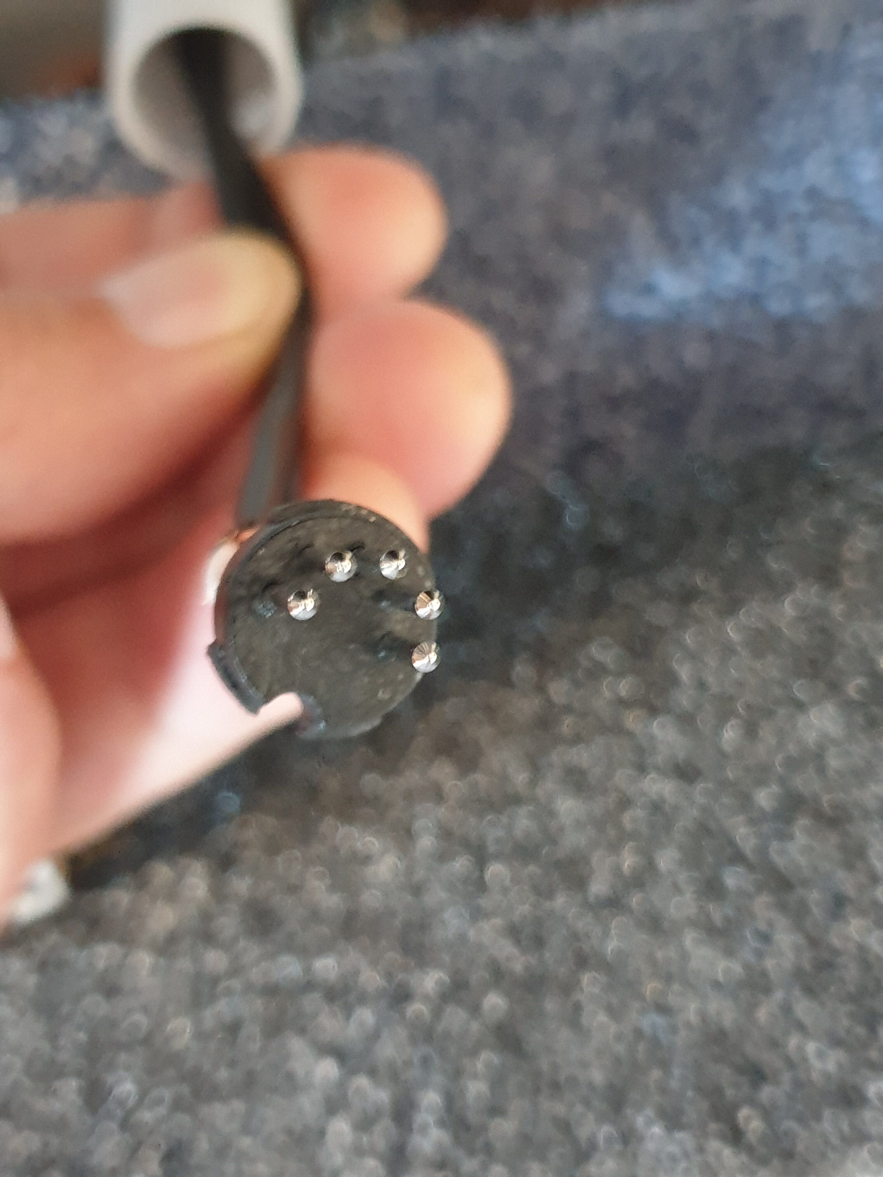

Agree with @davidhendon …is the barrel of the DIN metal or plastic?
That cable does not look to be well made - IMHO… Looks messy. Which is asking from problems with a DIN.
Fine once done correctly.

The barrel is metal and fits around the pins and a plastic shroud slips over that, holding it all together.
OK, sounds like a short like David mentioned.
Yes it’s something the cable guy can easily check with a multimeter. Apart from whiskers of copper, it can also be that he overheated the screen shroud and it melted into the plastic on a signal cable. It’s a schoolboy error.
