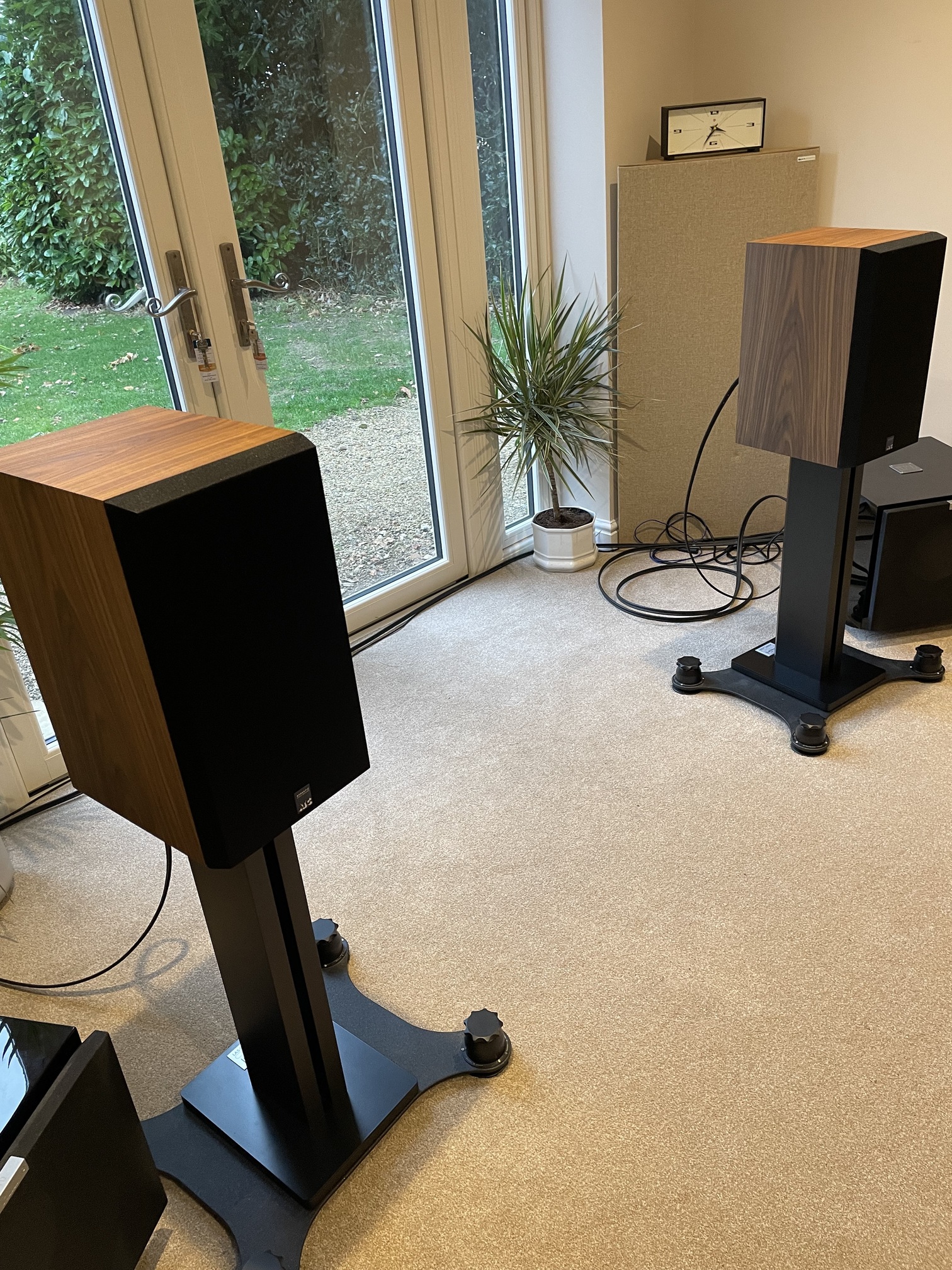

My ATC’s were sounding good one day and then not the next, it was un obviously obvious. Serendipity saved the day as I had arranged Tony Basically Sound to demo some stand mounts as I was unsatisfied with the sound of my system…. Didn’t realise my ATC’s were broken and assumed it was just room nodes…
Tony boxed them up and took they back to his and confirmed yesterday there was a driver issue - sound was congested and lacking in detail. Tony said it became obvious when he played them against his demo pair….
Tony left me with the ATC SCM20’s and a NC 250. Sounding very good I have to say and they look lovely in walnut - great service as always from Basically Sound.
