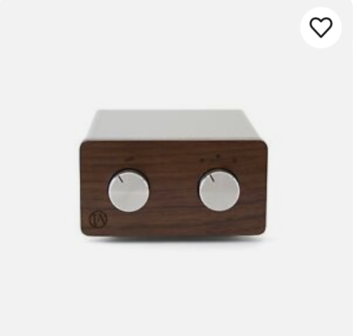

If you need extra inputs , a passive pe-amp , something like a Tisbury (it’s usually very small ) will add extra inputs. Thing is , that it doesn’t need plugging in to the mains
Can be bought easily enough from ebay , Bob The Builder liked this enormously . It has three inputs
