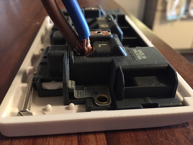

Does anyone by chance have a pic of a 10mm wrangling success with a wall plug socket ?
Could be of use to show a reluctant sparky.

Just to prove a point, yes, you can fit two 10mm cables into an MK socket, as required to run more than one socket. (Obviously the socket in the photo is just a test, which is why the + and - wires are shoved into the same terminal!!)
The real problem in my experience is assembling it in situ and pushing the cable into the back box. Itâs a very tight squeeze into even the largest sized back box, and I wouldnât blame an electrician who refused to do it.

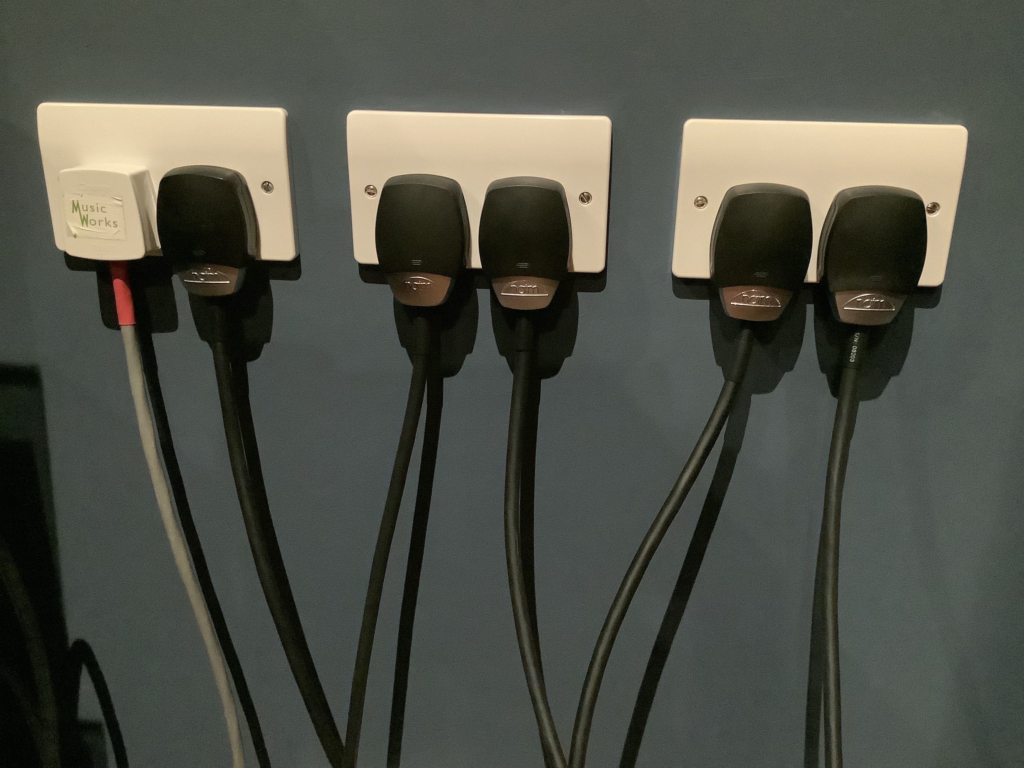

The answer is to run separate radial cables to each socket. Thatâs what we did. Given all the disruption to feed one cable through all the ceiling joists, down the walls etc, you may as well go for three. Feeding one 10mm^2 cable into the back of an MK faceplate and then persuading it to go into the back box is plenty enough fun, but trying to do it with linking cables too would require Herculean effort and determination!
