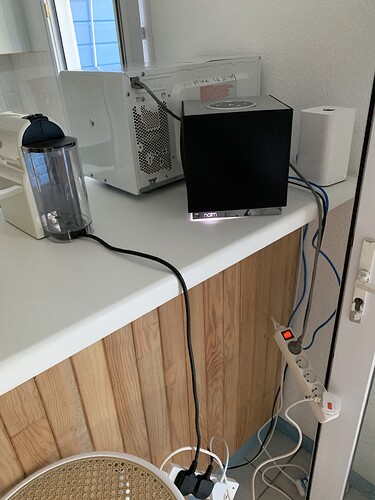

Getting the power arrangements right, even for temporary installations, is very important. This carefully dressed system in our holiday cottage last year is a case in point, where time spent getting it right paid off.

I’m really not sure I should have liked that post, but it made me smile.
We shouldn’t underestimate the role of the door in this fine example either in assisting with correct cable alignment. Also the careful utilisation of the work surface curved edge and “overhang” to create further tensioning optimisations.
Exemplary work indeed.
A synergy of hot beverages, ready meals, connectivity and musical delights.
One can only assume it’s fed from a 10mm T&E of course.
It was in France, so tbh I’m unsure about the conductor diameters. However I do think the proximity of the familiar coffee machine, which the Qb is used to sensing on the local power system at home, may be part of the reason for it sounding so good.
Yep, keep it simple, enjoy the music, less analism.
It’s probably the very nice french wine David…just saying😉
Do you not think you should have used bubble wrap to keep cables apart? Bit of a poor show tbh
I see there’s a nice Faraday cage behind your QB, I’m sure you could elevate it to ND555 performance if you put it in there.
