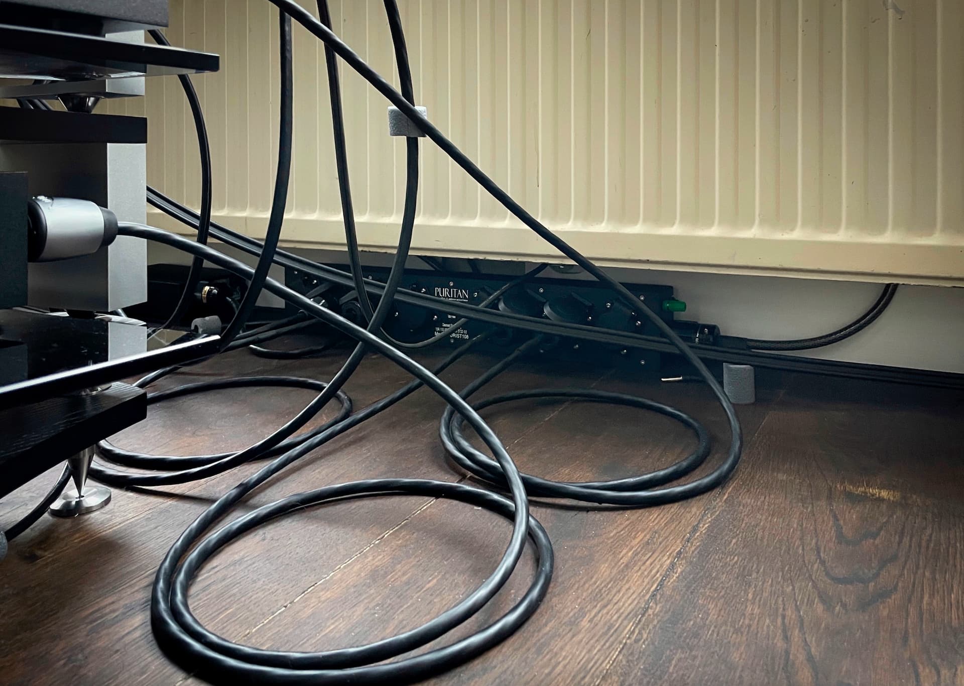

I have the Puritan PS108 power strip in my system for a week now. Very impressed…

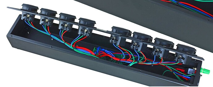

The PS108 ‘Purist’ is the only model from Puritan without any filtering. It’s build like a tank. The electrically and magnetically shielded case is from mild steel, the cover holding the sockets is from alloy. Screwed together with countersunk Torx screws. Very robust and really nice. At 4 KGs it feels substantial too.
The (Shuko) sockets are heavy duty German ABL’s. No ‘audiophile’ sockets with fancy plating or anything like that. Apparently these ABL’s are selected for their sound quality and clamping force. The later is noticeable when you plug in the cables as they do require a bit more force than usual.
Looking inside I was a little sceptic/worried at first as the star wiring is done from a small PCB sitting in the centre of the case. Chatting with Puritan (Mike is very nice and responsive); they use a heavy 4oz PCB with the wires arranged in a tight circle around the connection points for live, neutral & earth. The wiring is 2.5mm2 / 14 AWG silver plated OFC with PTFE (Teflon) insulation.

I noticed you’re not using the green grounding point. You may benefit from a large SQ increase by using it correctly. OCD mikey on ytube used the puritan ground unit to connect an outer earth ground instead of using the inner house ground and it’s voltage was tested and was found to have ZERO volts on the line, he was quite taken aback at the time. Reminds me of a lot of British made products, really well built without any extraneous faff doing exactly what it was designed to do. I’m sure this model will beat quite a few much higher end power strips.
Thanks @Henryski - the green connector is connected to the central earth point on the PCB. The information that came with it says it can be used to connect non- mains connected accessories like a tone arm. I have no use for it in my setup. I also have a separate ‘audio only’ earth btw.
