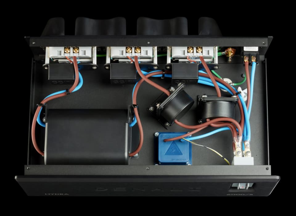

I had Denali 2000, good thing if used wisely but nothing special with Naim, sold since moved to the brand

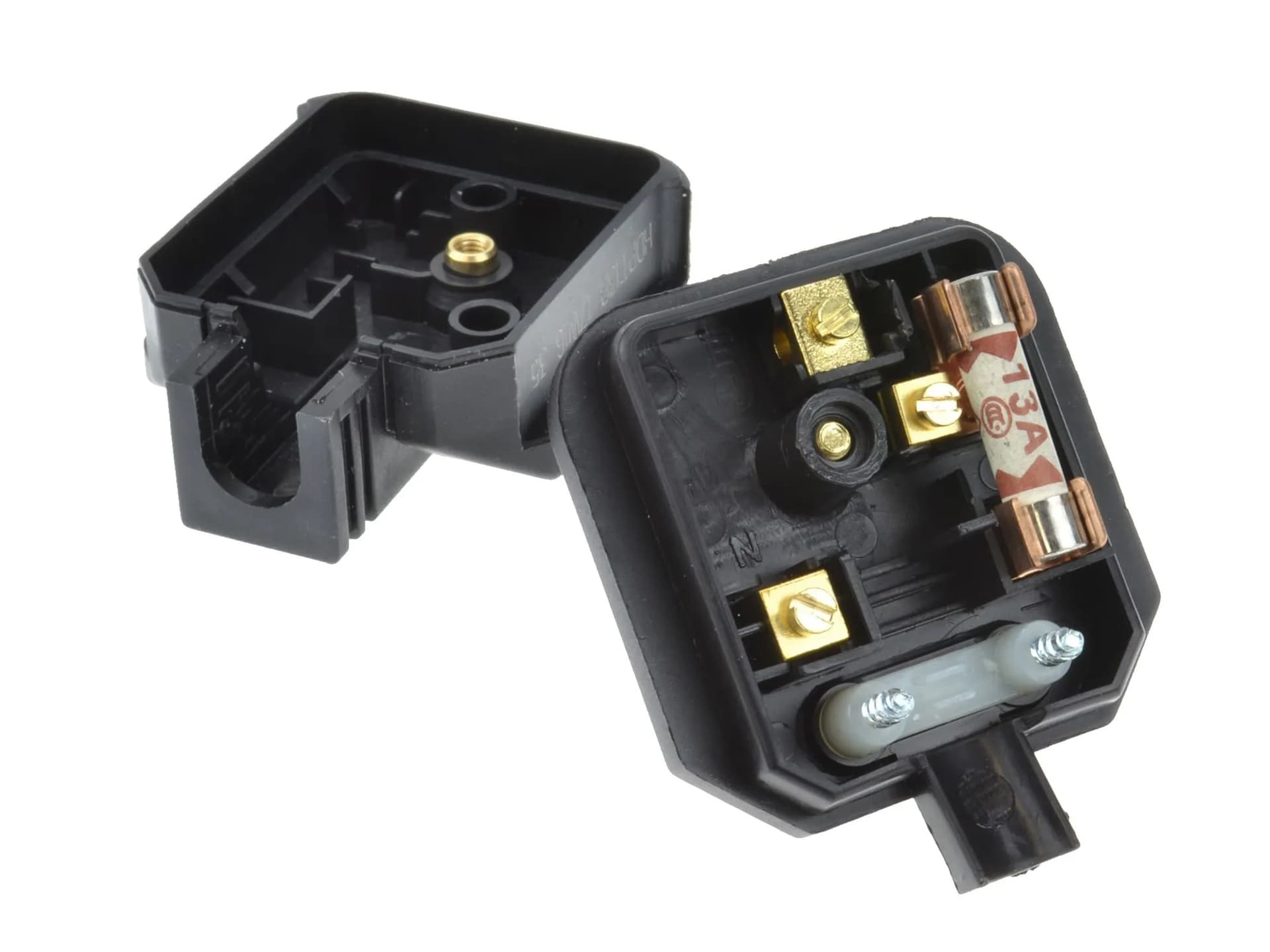

I use Permaplug 13A plugs on my IEC cables (silver plated pins from HiFi Collective) and Vertere use them on their Redline cables.
Yes, they do look slightly different. Maybe just fuse and no neon. But they are clearly Permaplug in appearance in every other way so maybe either a cunning rip-off or a proprietary version made for them.
I always thought the Permaplug 13A plugs were actually rather better than MK Toughplugs, which seem to distort with 1.5mmsq cables when they are pushed into the cable grip. They seem too thick for the plug to handle and the base starts to bend. I don’t think MK are quite what they used to be. Atlas also use Permaplugs on some of their cables.

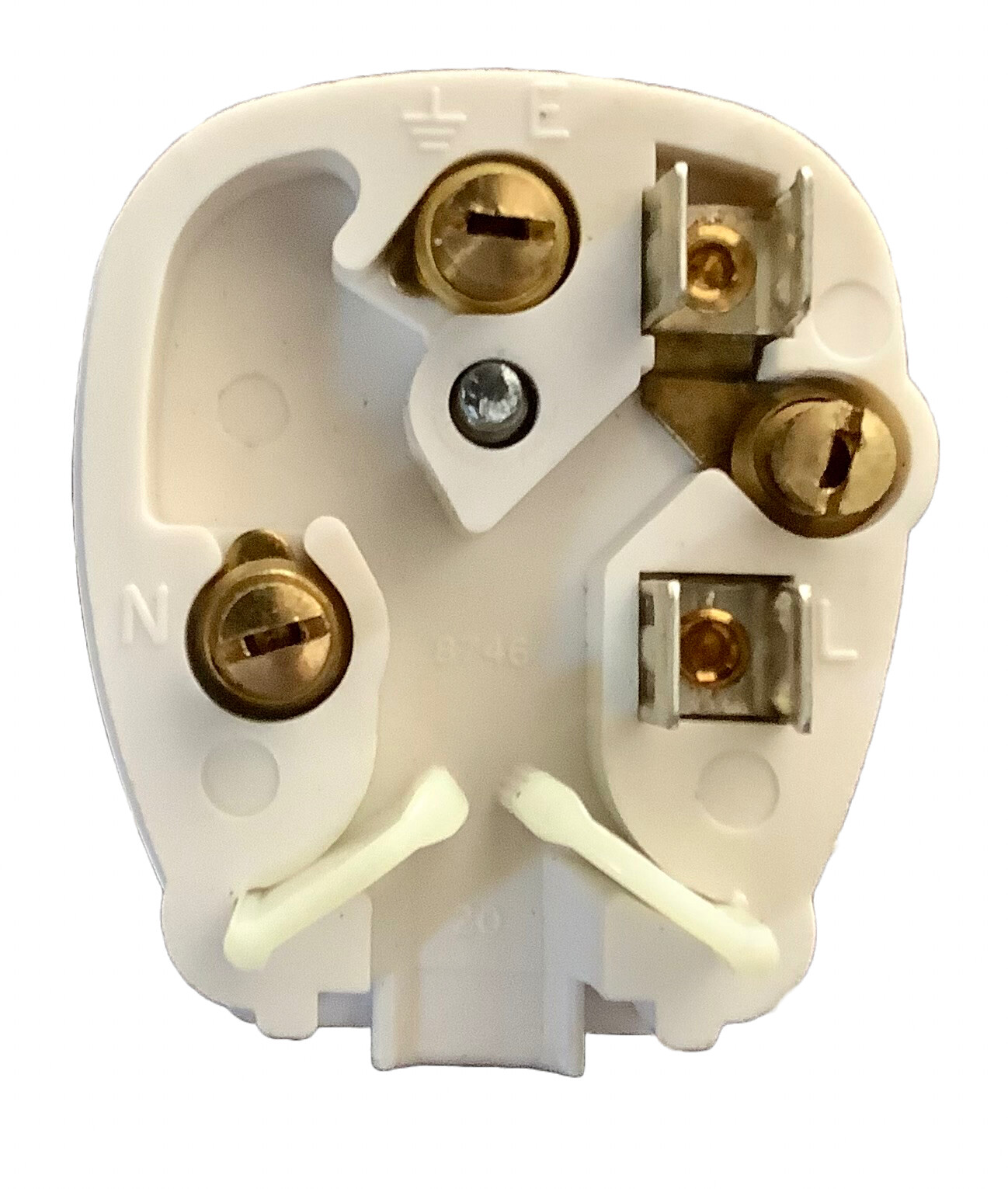

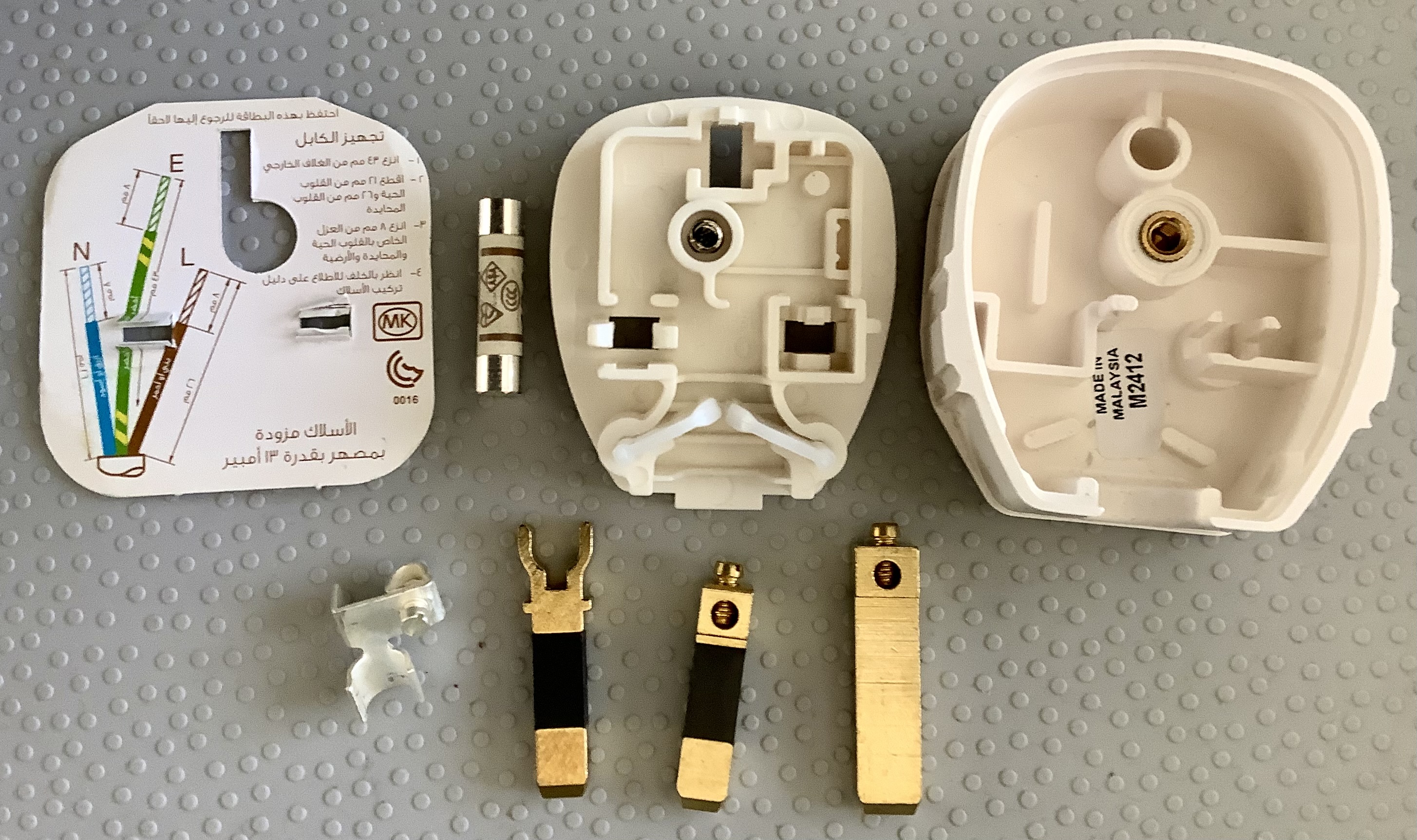

Old MK Toughplugs were like safety plugs inside and the fuse holder was on rivets top pic
New ones below have no crimps or rivets and every pin is machined from a single piece.

Yes I’ve seen the old Toughplugs and I see what you mean. Do you not find that the base of the new Toughplugs is prone to bending though when pushing a thick cable (not overly thick, just 1.5mm2) into the grip? Or maybe it’s me and I’m doing something wrong?

Haven’t found any undue flexibility at all.
I just tried one of these new ones as an experiment I always used safety plugs previous but they do tend to strip out the thread on the contacts if cable is a bit beefy.

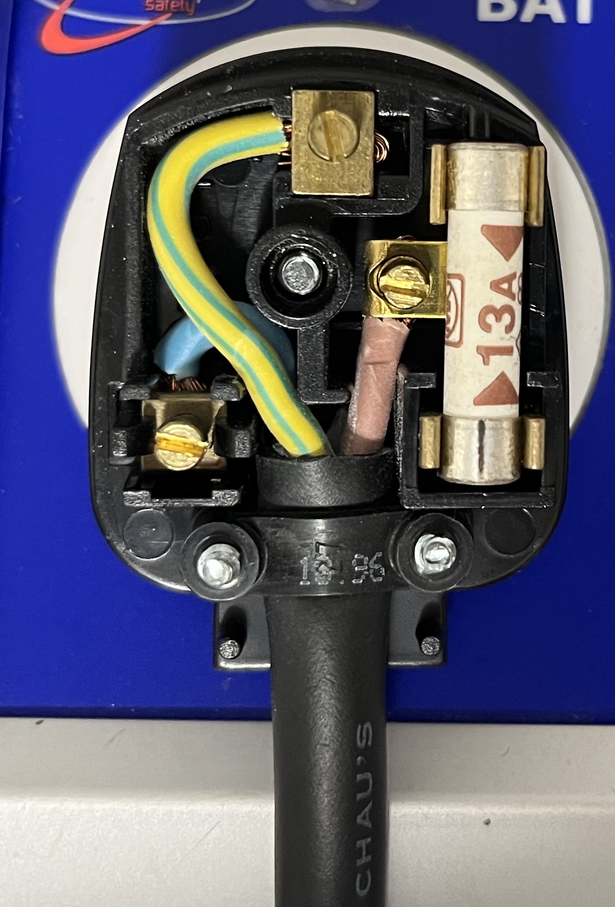

That’s one of mine in the picture.
I also can not use my hands for anything more difficult than a knife and fork. Hearing you.
With regards to surge clamping, clamping is an electronic term that, instead of being a surge blocker as a coil in series with the supply it clamps surge peaks to earth using MOV’s metal Oxide Varistors. I think this is what is meant in the advertising blurb. I believe the device would be safe to use.

Agree, I’ve never liked the MK cable grip. It distorts the cable and the distortion get worse over time, more so with movement, and worse with larger cables, I refuse to try to force one on my dual screened 2.5mm.
The Permaplug has a traditional two screw saddle grip that covers a much larger area of cable which gives a more effective grip with far less cable compression. Plus it’s designed to be reversed to accept larger dia cable.
I also like the robust simplicity of the design, as I said in another post, built like the proverbial brick khazi.
I looked at these to and thought well of until I seen the fuse holder and terminal pieces riveted together.
One piece pin and terminal I like better.
It’s cord grip rated up to 1.5mm2 cable like the MK Toughplug too.

Permaplug 13A are sized and spec’d for " … 2.5mm flex … "
You adversion to “riveted” parts I feel is misguided, compression (rivet) & spot weld are common and well proven in all forms of electrical mftg, plus they are BSI tested. But whatever, I get your point.

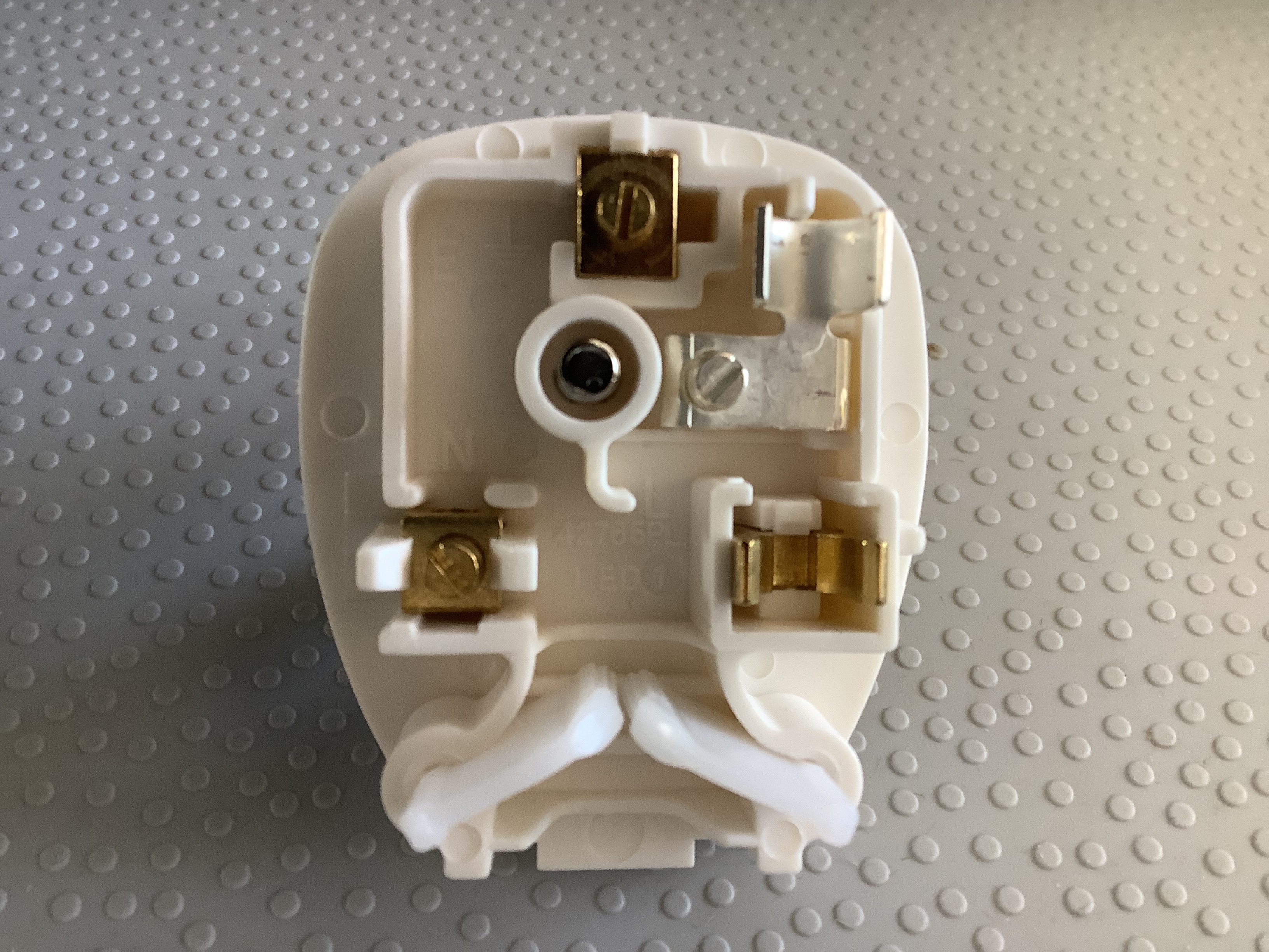

I didn’t realise that Toughplugs had changed design and moved away from the wrap-around terminals.
The new layout looks very similar to the Duraplugs from the 90s. One piece terminals and a saddle cord grip, that could almost please everybody :wink:

Yes indeed I had previously advocated the safety plugs but decided ferrules and single piece metalwork had to be better.
I think the new MK Toughplugs are superb and pass my OCD nicely.
MK655 is the part number and the letters BLK for black and WHI for white cover tops.
No flexing like others too. :+1:t2:

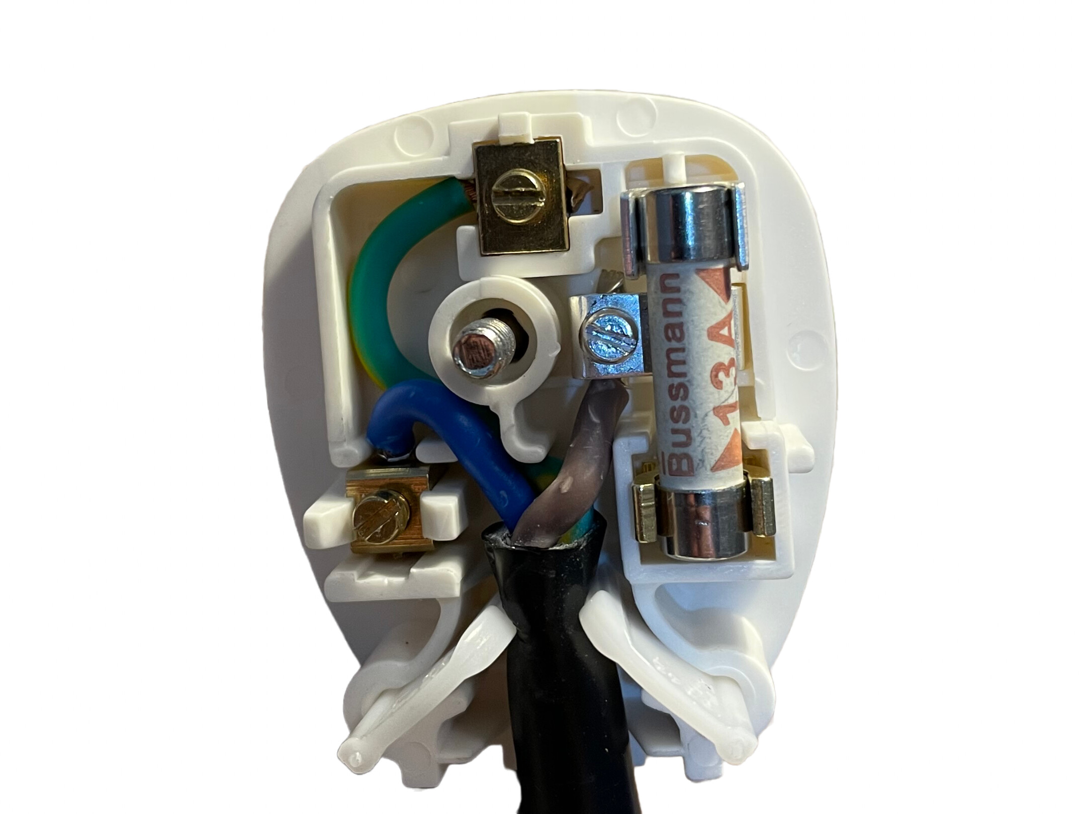

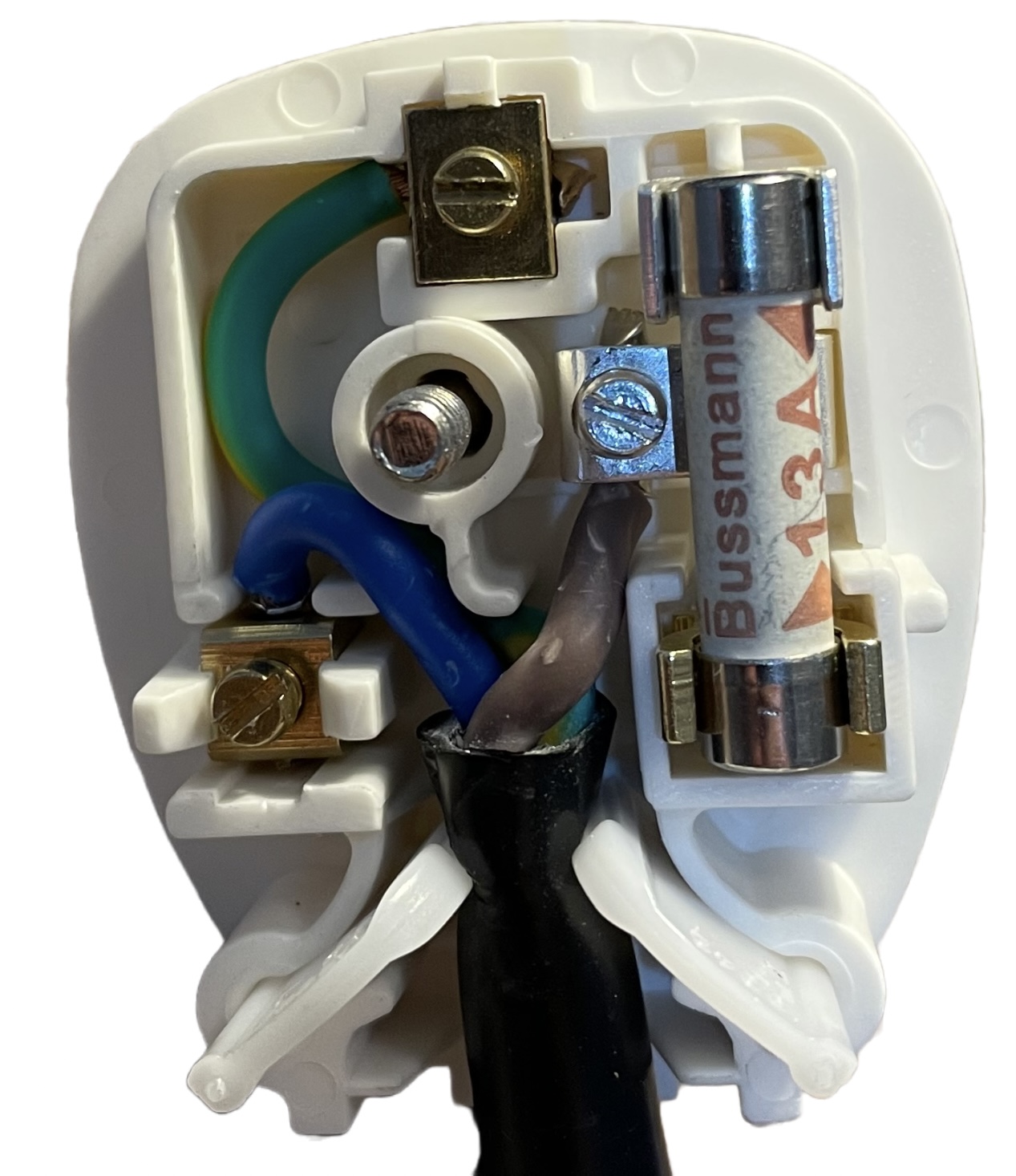

I’ll attach pictures of one in bits below to show what I mean.
Incidentally with very heavy cables you can remove the jaws and the plug top grips insulation with the rib below behind the jaws.
