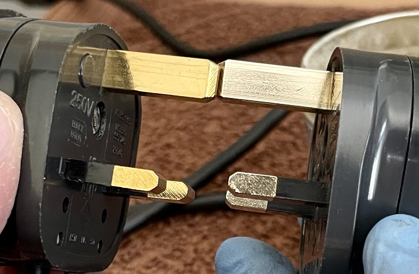

Took time to disassemble a naim Powerline UK connector. Bought second handed. Might need to overlook my old cables to make sure connections are tight.
What surprised me was :
  • All three screws on the outside of the plug was loose. Maybe they should be for mechanism to work correct.
  • Two out of three inner screws connecting wires to brass connectors were lose.
  • One out of three inner wires had metal strands not being mounted inside the brass screw
The actual wires are not ‘soldered’, looking at your last photo. They look quite normal to me.

True. Updated :slight_smile:
As I understand product disassembled pictures are not against rules. Naim show disassembled pictures of their electronics and the Powerline. Modification on the other hand is a different thing but I’m just showing the inner parts of a Powerline here :slight_smile:

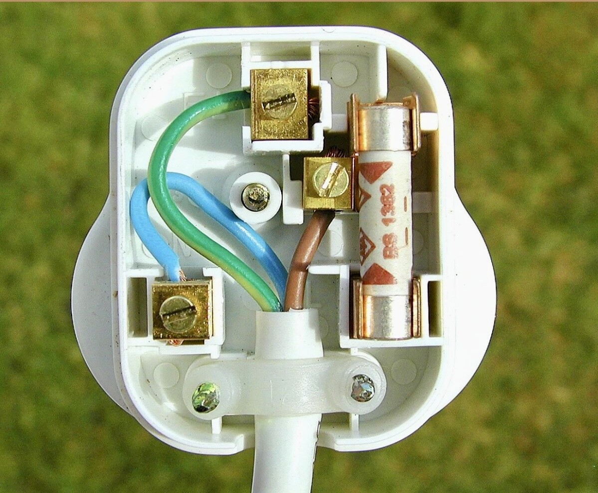

I prefer the wrap round terminals in MK safety plugs you don’t get a tight spot splitting the strands.
With directional not crushing cord grip too.
