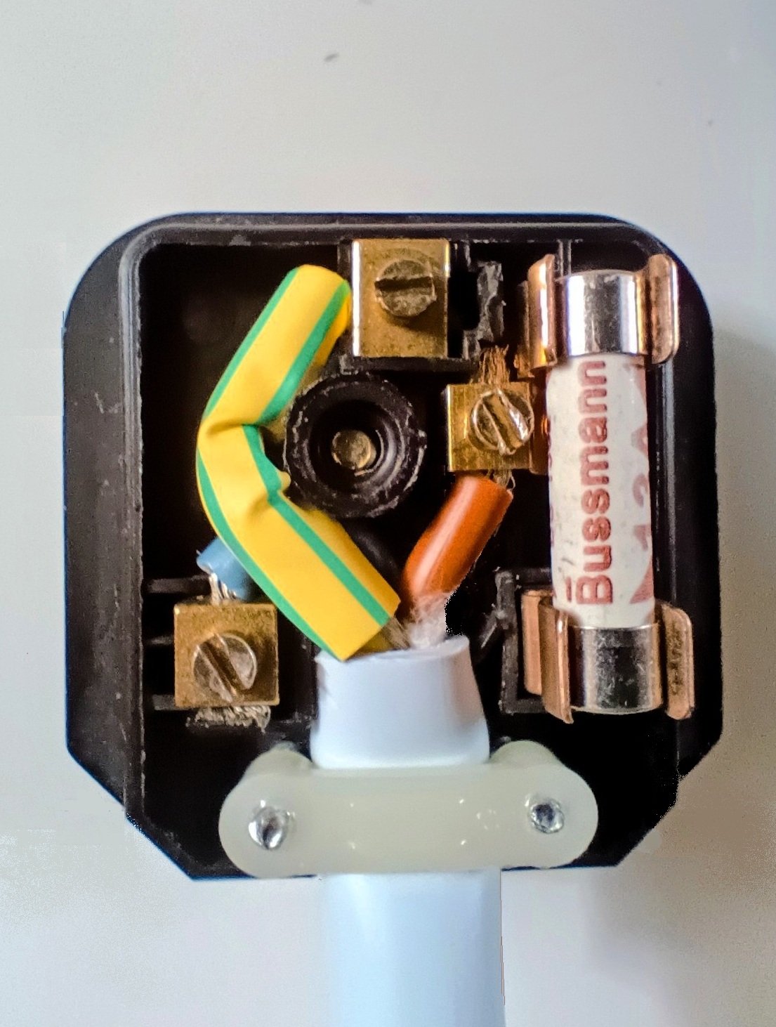

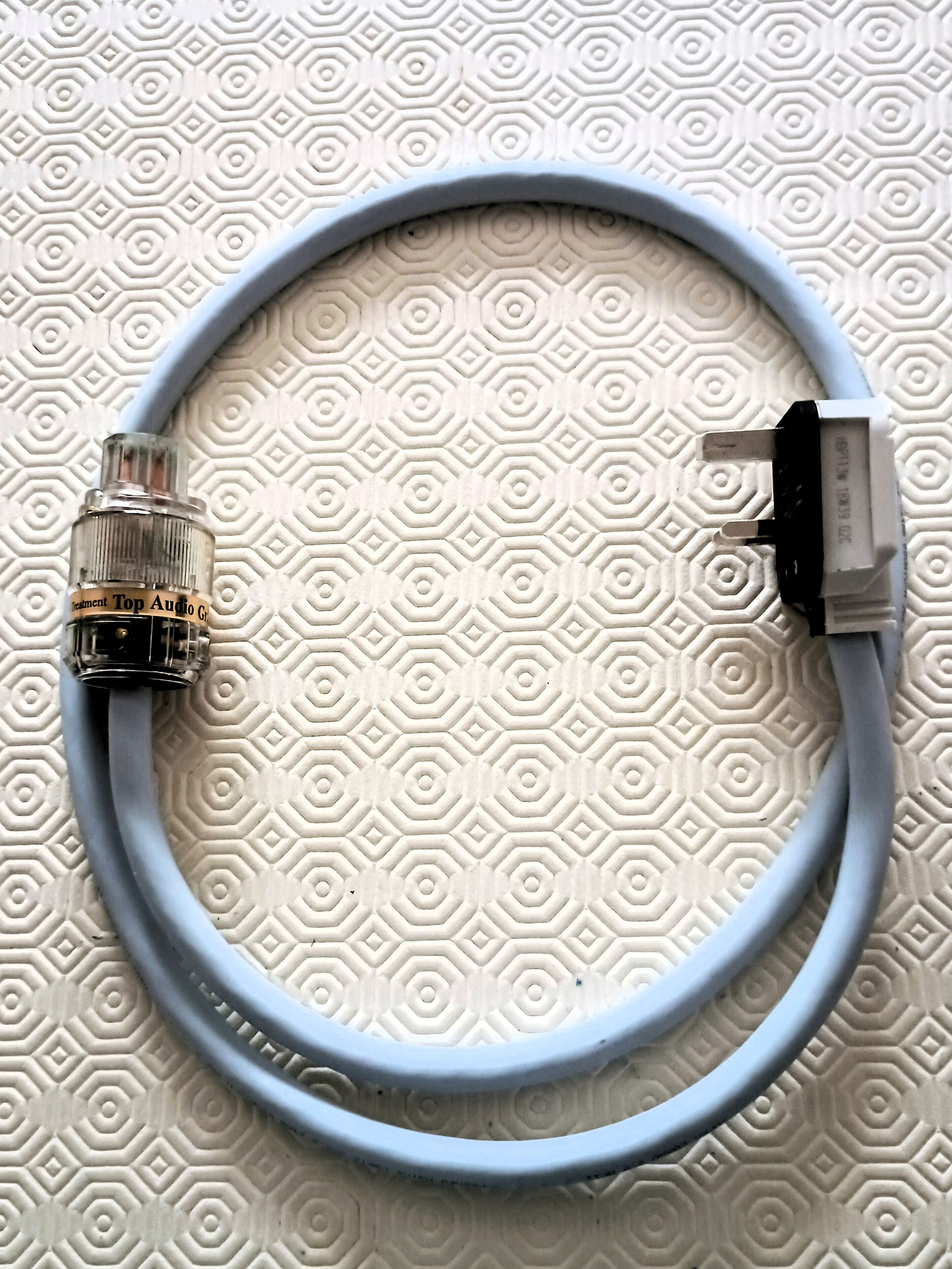

I make my own IEC :+1:
Me too … made to the right length to fit the application using quality materials.
@Skeptikal and @Mike-B . Very nice cables gentlemen.

@Skeptikal @Mike-B Do you use shielded cable or just decent quality non shielded?
Hi TGR, my cables are all listed in my profile.
Wall to power board is Titanex H07RN-F 4mm/2, this is similar to the Powerline cable with unscreened rubber insulation but with a higher insulation voltage. It has the same 4mm/2 conductor size.
Cable to the various units is all Supra LoRad which is screened with a nylon/carbon impregnated semi conductor layer with a copper drain wire. I use screened cable only to the units because it’s slightly crowded and suppressing any possibility of cross cable interference has to be better than none. Size is a mix of 2.5mm/2 and 1.5mm/2.

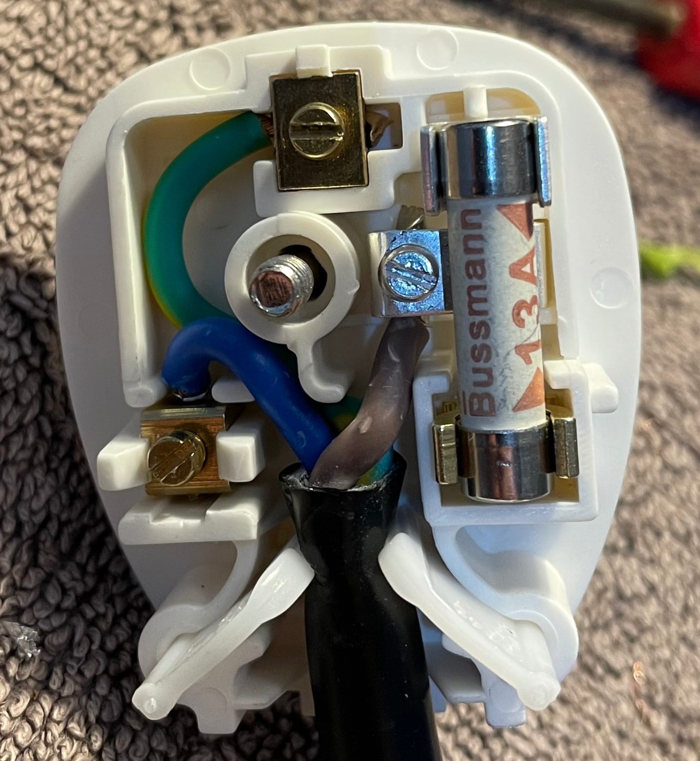

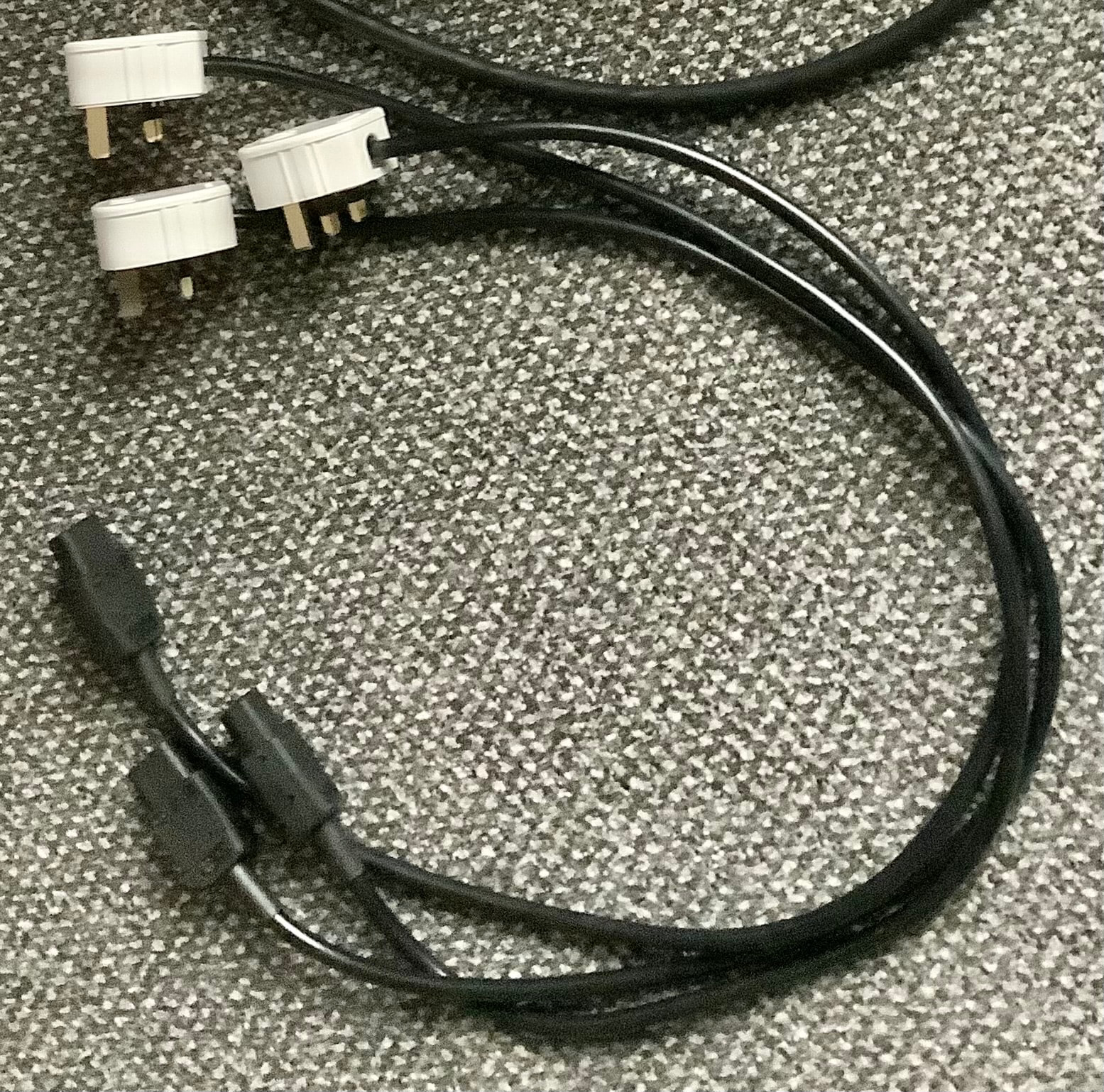

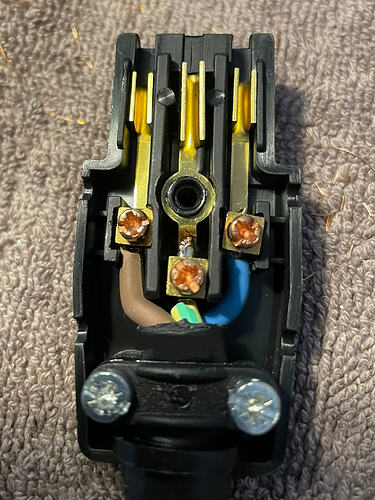

Hi
Non shielded.
IEC Leads.
MK tough plugs MK 655WHI
Bussmann 13A fuses
Doncaster 3 Core Rubber Flexible Cable
3183TRS 1.5mm2 Black
IEC Connector c13 10a Martin Kaiser 794
All terminated with ferrules to stop terminal screw pinching split on multi strand. :+1:
