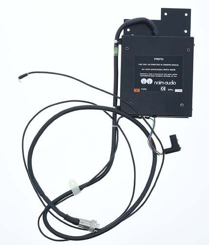

The Prefix was a phono stage that was designed to fit inside the Plinth of the Linn Sondek - it would attach to the front corner brace. There was great advantage with low output MCs by shortening the distance from the generator to the phono stage.
Here’s a picture of a K type from LP12bits;

From what I see in the image you sent me I notice that the stageline is much more screened than the prefix.
Didn’t Naim use the very same phono boards in Stageline as in Prefix ?
Making the short signal and plugs create advantage ?
Almost, but not quite, here’s the Prefix (image borrowed from @skeptikal post from December 2023):
Biggest advantage was the super-short signal path, which was particularly advantageous when transferring the minuscule signal from a low output MC’s generator.
