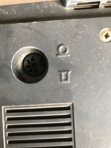

It’s a Grundig TK 120 and it’s obviously been in the attic a long time. Online searches suggest there was a Deluxe version but clearly this is not that. Have found a German version of the manual online. Searches suggest that there was an RCA out but it’s not clear where unless the microphone socket on the top left doubled as an output on some way.
The top symbol definatley looks like a microphone. The bottom symbol could represent a speaker, so you could be in luck.
There are a lot of versions of this machine and some definitely used the mic socket as an output during playback. Try playing a tape and connecting pin 3 to an external amplifier with pin 2 being gnd. If it’s going into a Naim amp then a straight din to din cable should work.
