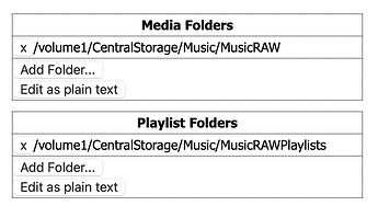

Here is my working example for Asset 7.5 for you
As you can see the MusicRAWPlaylists playlist folder is separate to my music folder.
All my playlists are in in my MusicRAWPlaylists folder (no extra subfolder), and they link to the Music via a relative path (e.g. ../MusicRAW meaning go up one folder, then down into MusicRAW folder), e.g.

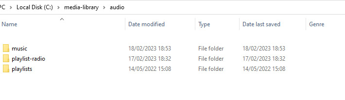

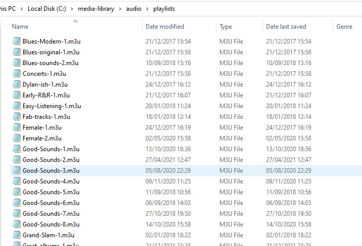

My Asset 7.4 is linked to a playlist folder on the PC/NAS in the normal way.
All my playlists were in that folder.

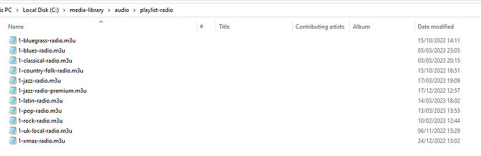

I had some radio playlists which I grouped in a sub-folder for convenience. This had worked under Asset 7.0 but they disappeared under Asset 7.4. But OK when I moved them from the sub-folder to the folder (confirmed as change by Asset).
As an alternative I therefore created a separate radio playlists folder and attached to Asset as a second playlist folder. All OK.
You can have as many playlists in the folder as you wish.
These are on my test system. I often copy them to my live system.
