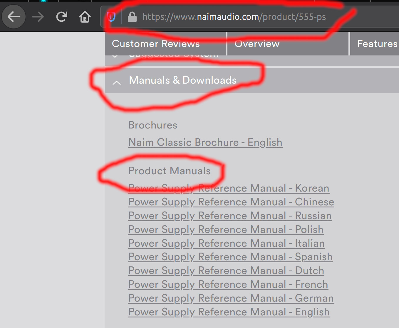

Waiting can be hard! :slight_smile: To pass the time:
Yep. That’s exactly where I went right after reading your message. No mentioning of the cable though, but your answer gave me enough comfort
True. I guess Naim relies on dealers for this so that customers don’t blow up their new gear :slight_smile: There is a cable FAQ on the forum, but it only covers snaics and interconnects.
