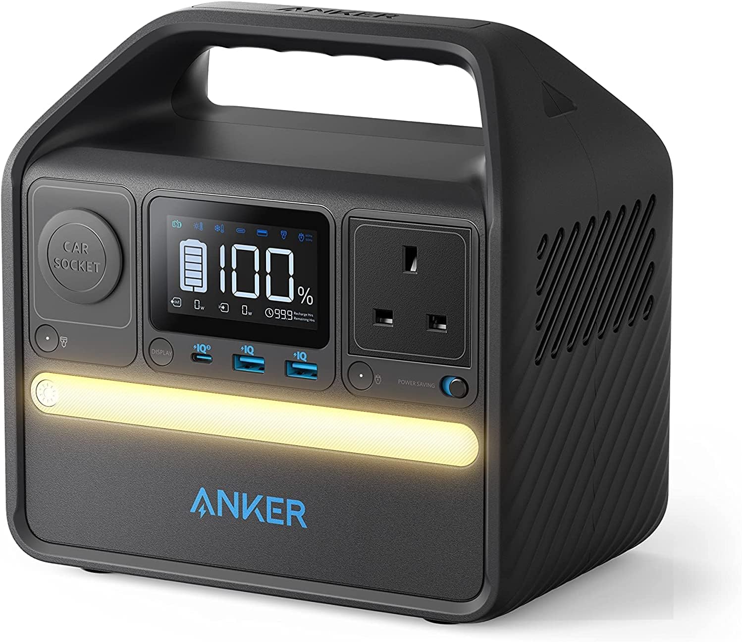

As for power outages, they are supposed to provide a battery backup for customers in an area with no mobile signal. We were upgraded to fibre about a year ago and faced a similar problem because we barely get a signal here too. The battery backup provided only keeps the router going for about half an hour and if our experience is typical, in the event of a power outage they often last for several hours so I invested in an Anker 521 Portable Power Station that will keep the router and fibre box powered for a good 9 hours+ It wasn’t cheap though, it cost about £230 but worth it for peace of mind

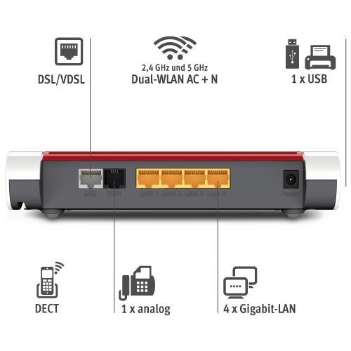

My ISP is providing a Fritzbox router, it has a RJ11 socket, it will do the VOIP to analogue conversion internally.

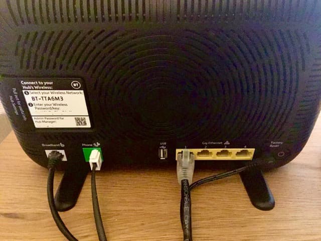

I have BT Smarthub 2 & BT/Openreach offered the option to change to ‘Digital Voice’ last year. The phone cable now plugs into the hub (see pic)
