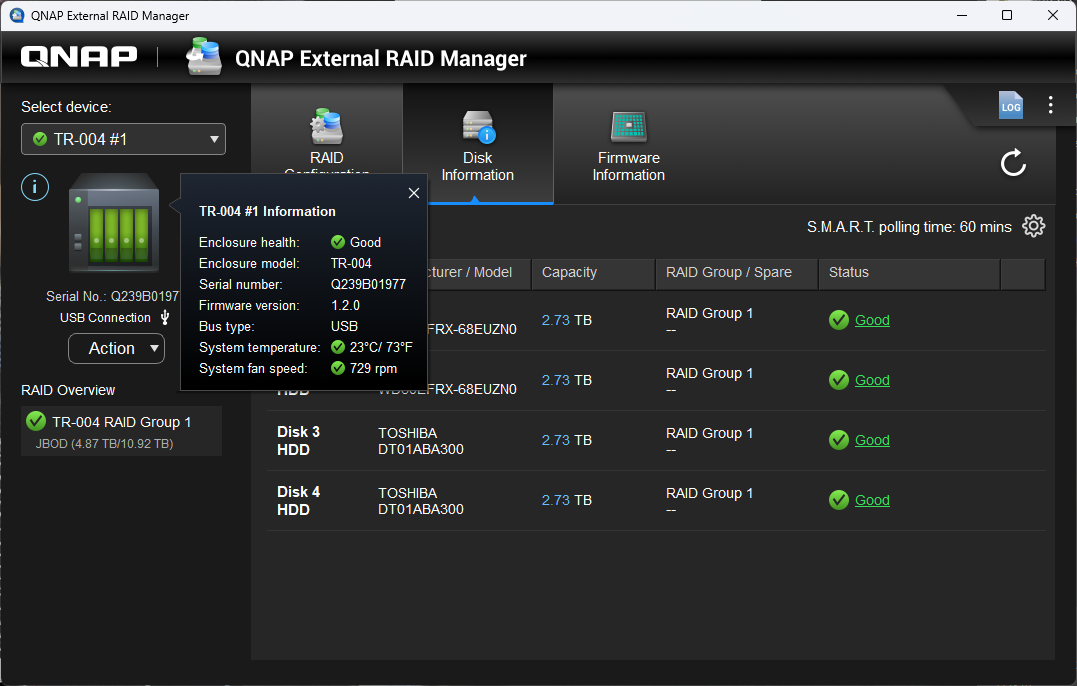

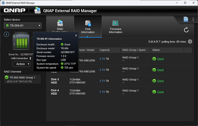

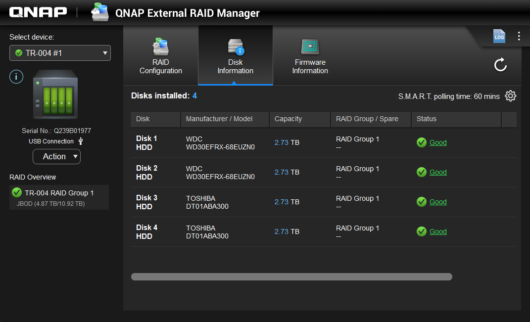

I have a QNAP DAS attached to the PC and starts the QNAP External RAID Manager on boot up.
Is there not a similar bit of QNAP software for your NAS, this can hilight a problem before disaster strikes.
Not sure I don’t use raid. This isn’t a problem with the discs but as mentioned above a failure on the motherboard.
Monitors the Enclosure health too.
