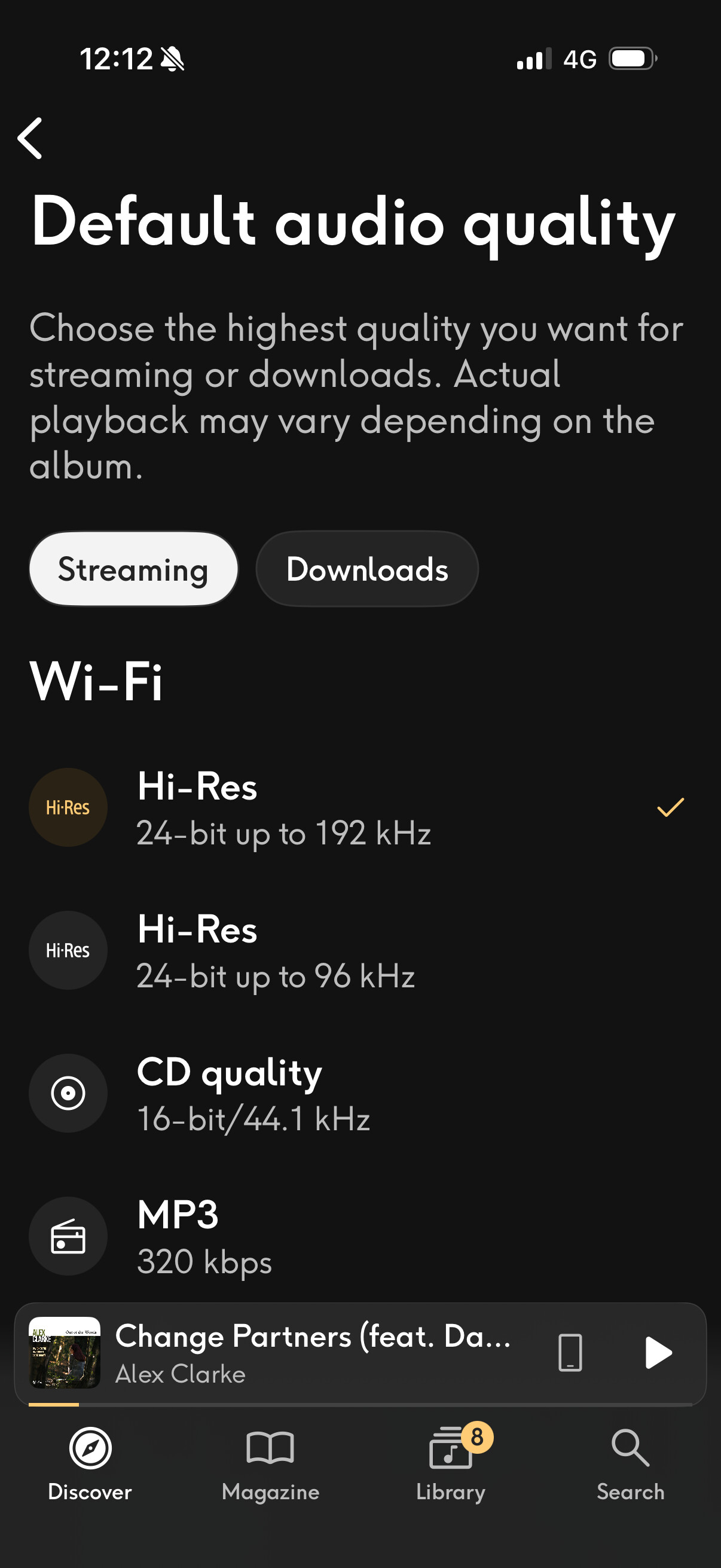

Have you set this screen correctly?

Yes, I set this in the Qobuz app on my iPhone - and within the Focal/Naim app.

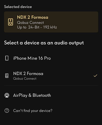

Sadly, there was no change. But I did notice something which could be a conflict? Seeing as the ongoing issue I am having, is Qobuz limiting me to streaming at CD quality. But when I’m connected through Qobuz Connect, it suggest I should be able to stream up to 24-Bit - 192 Khz.

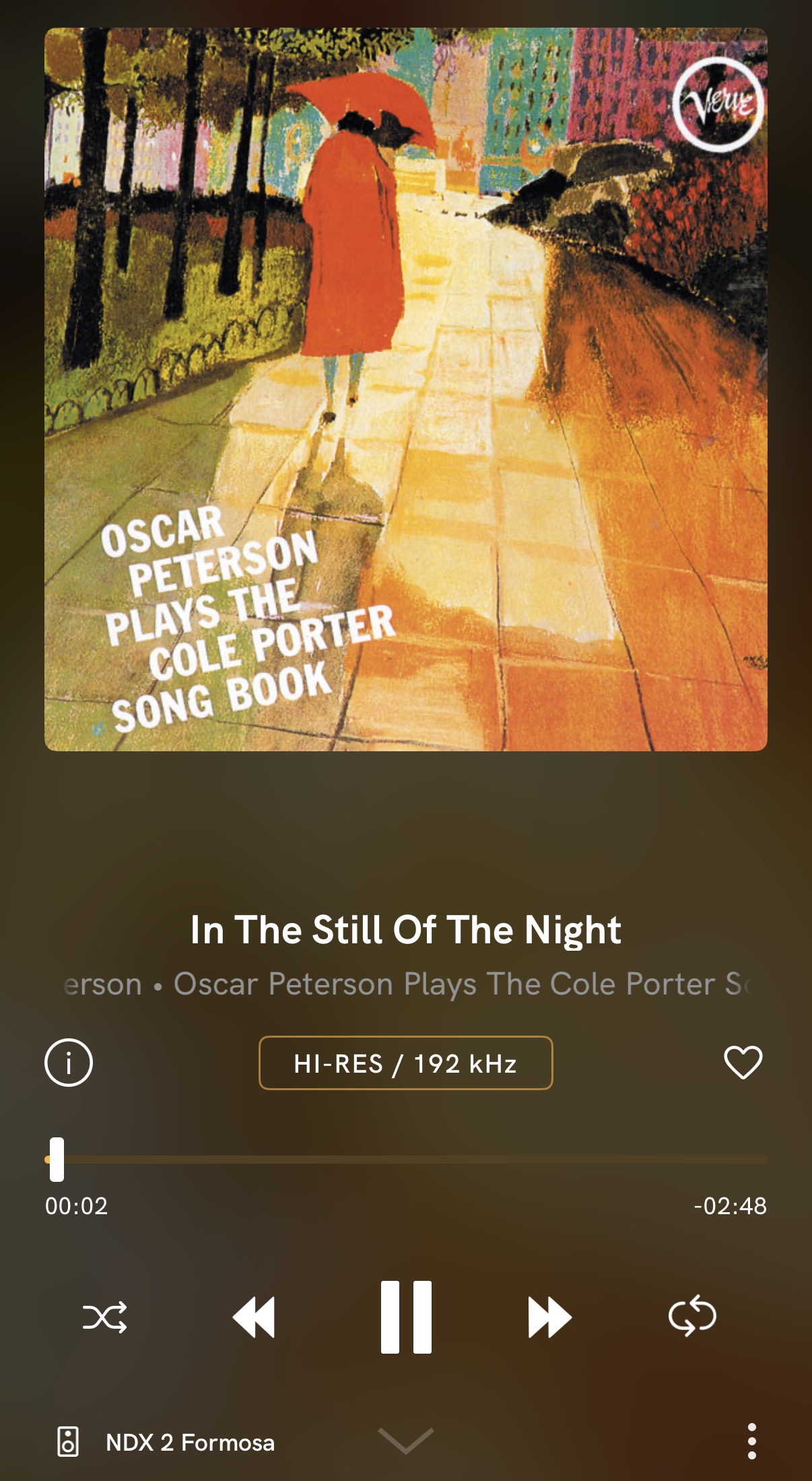

I tested this on an album I had purchased through my Qobuz account, and it worked flawlessly.

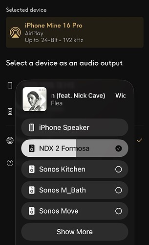

Furthermore, if I open the Airplay & Bluetooth list, my NDX2 is listed in there and suggests the same quality threshold. It may simply be just another method of connection; as Airplay, Bluetooth are both protocols the NDX2 supports. But I was wondering if there just a conflict somewhere, which is disabling playback above 16-Bit - 44 Khz?
