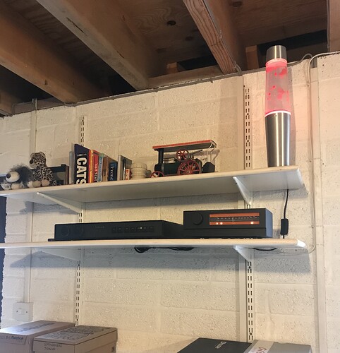

Have one of these in its box, unused since I moved from Manchester in 1999 to Ireland and lost my FM aerial.
Would I sell, not yet!
Indeed I do! Bought it for £50 many moons ago to ‘tweak’ for fun. They respond well to a simple service (recapping) but only if the alignment hasn’t slipped out of whack. Re-alignment of a tuner is a specialist job, but Quad UK used to offer very reasonable fixed price servicing so worth checking out. That and a decent aerial should give you a very nice sounding tuner indeed.
