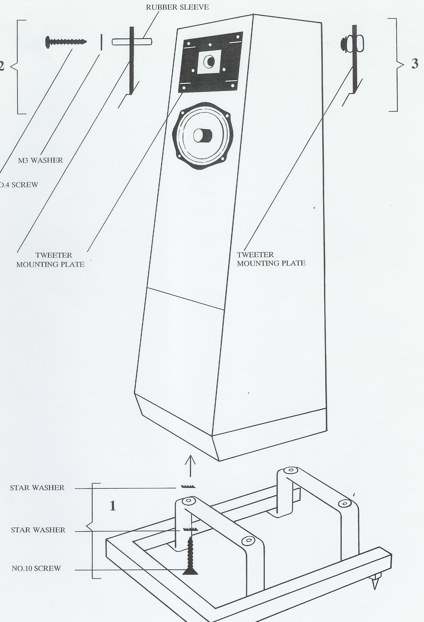

This document describe upgrade from mk1 to mk2. With additional message from Steven Hopkins at naim.
"Hi
MK2 had two pieces of grey reticulated foam behind the bass units and 15g wool behind tweeter, see attached
Regards
Steven Hopkins"

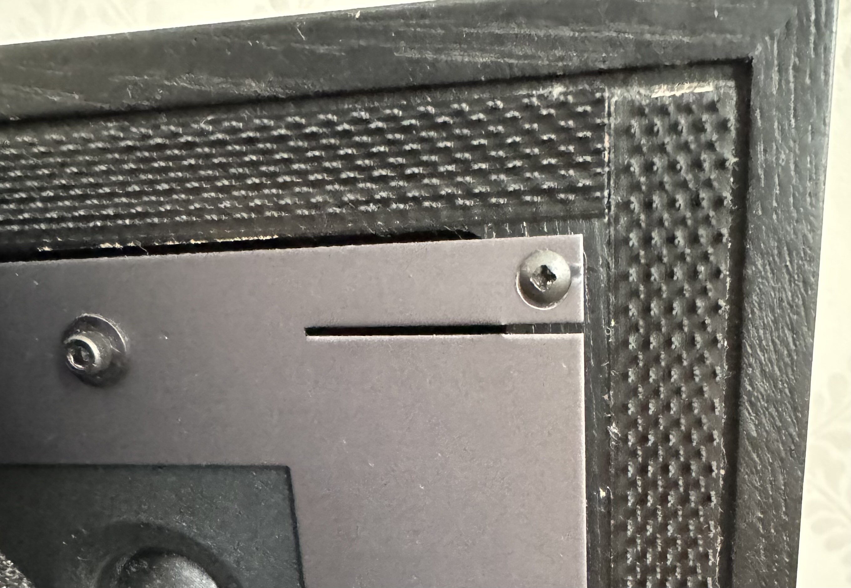

I’m struggling with the treble set up as it is here. There are 1 inch screws holding the plate in, they have smashed through the veneer on the backside of the baffle, I don’t think this was as intended, I would imagine the original screw would have been 12mm.

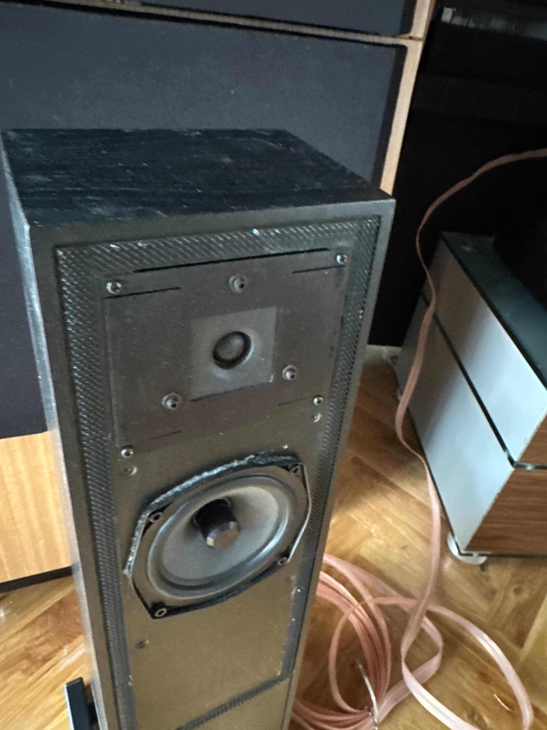

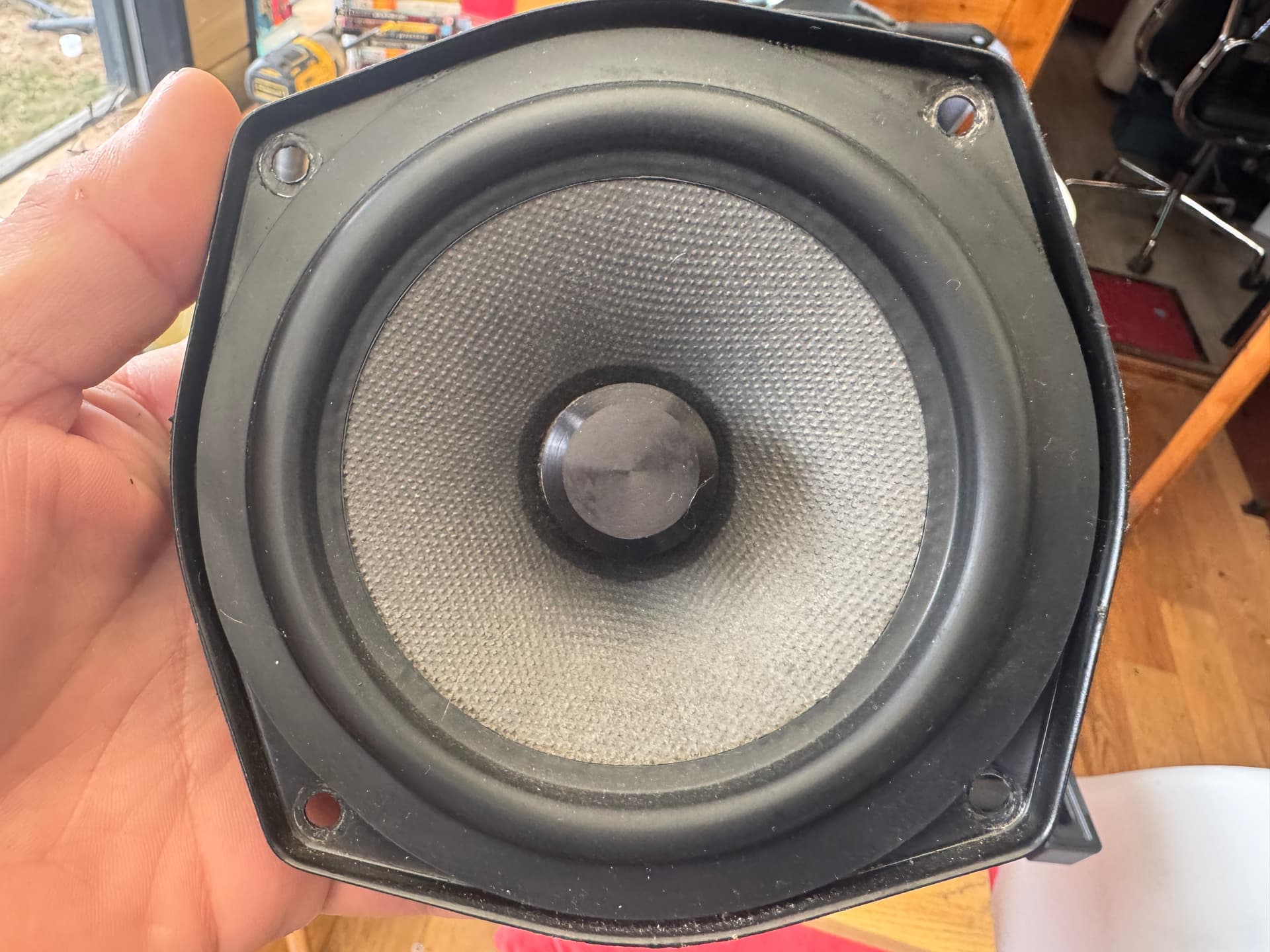

I think these date to 1988, so the original EA ones. The reason I asked what mine were is because someone has clearly been in to the mids post, because there was an unfathomable amount of hylmar, its everywhere in side on the foams etc.
You can see from the picture

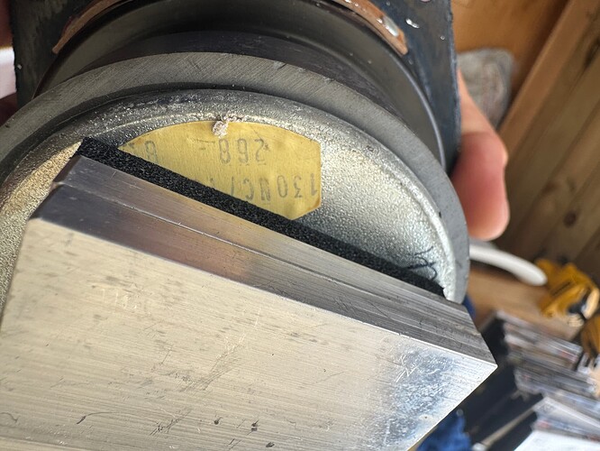

So question is, did they get replaced at any time. The paper is textured almost like carbon fibre the rubber surround glue etc impeccable, they are very neat. But no identifying marks apart from a partially obscured faded text.
The label on the back seems to indicate the mid/bass units are the modified Mordaunt Short ones. So, of the serial numbers are early then maybe they were likely replaced at some point.

And I donĀ“t think it’s good to ā€œupgradeā€ MK1Ā“s Tweeters suspension to MK 2 only,thatĀ“s not how they are tuned.
But did they use 1 inch screws to put the treble plates to the boxes, this is what I want to know. I am willing to bet no.
Do you have the next page?
No that’s all I got from Mr. Hopkins I’m afraid. I think my screws are shorter yes, they are quite delicate, yours look beefier.

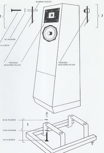

I didn’t bother with the screws and star washers for the stands either. I always wondered how I would know which spec screws they actually mean by ā€œNo.4 Pozidrive screwsā€ and No.10 Twinfast Pozidrive screws". Is that screw standard language or naim parts language?

I under stand the pozi drive element, but screws come in certain thicknesses and certain lengths, not specified in the literature, which is also missing half the info, so not terrifically useful unfortunately.
Original Mk I. As far as I know.
ok thanks quite different from mine screws. Honestly though I see ver little suspension going on the MK 1 design!
