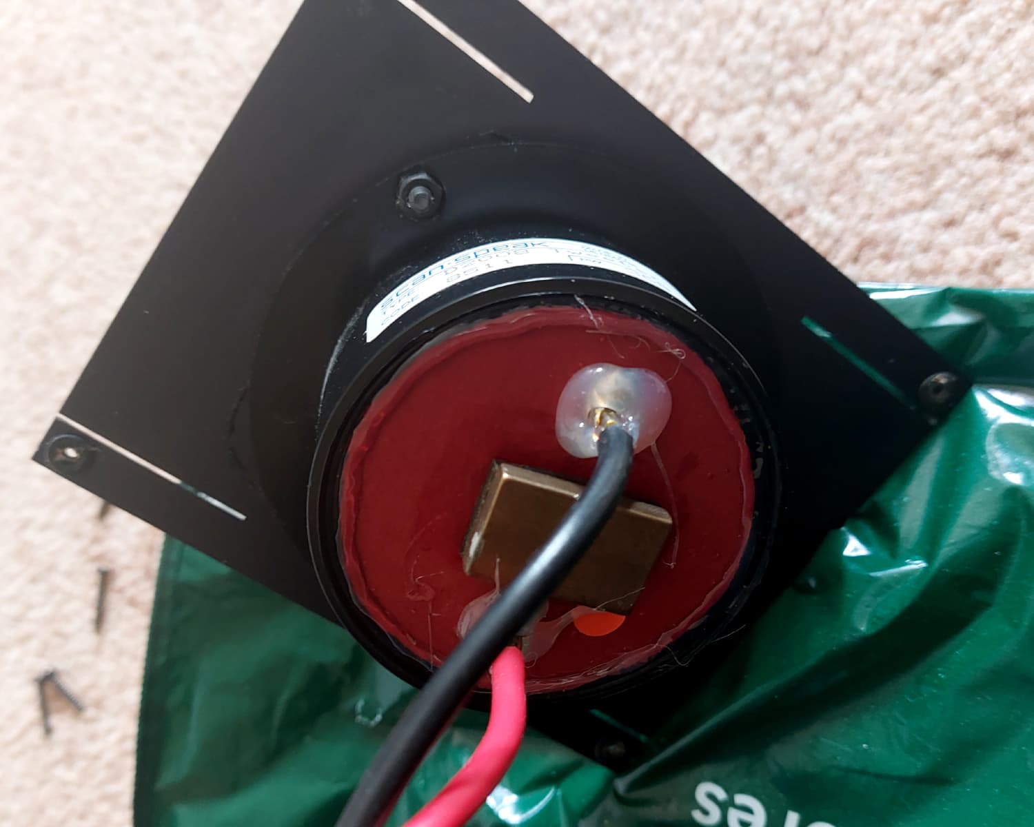

Firstly the tweeter, I understand this is suspended like NBLs/DBLs. The plate is slightly different however these, the plate is screwed down tight, no grommets with 1 inch screws.
On the back of the plate is weather strip. To my mind this surely negates any suspension that was happening, is this a ‘mod’ of some kind?
Also out of interest does anyone know which of the three revisions of mid speaker naim went through, these are? These are Mark 1 speakers
Looks like a mod to me. I have never ever seen that on any backplate!

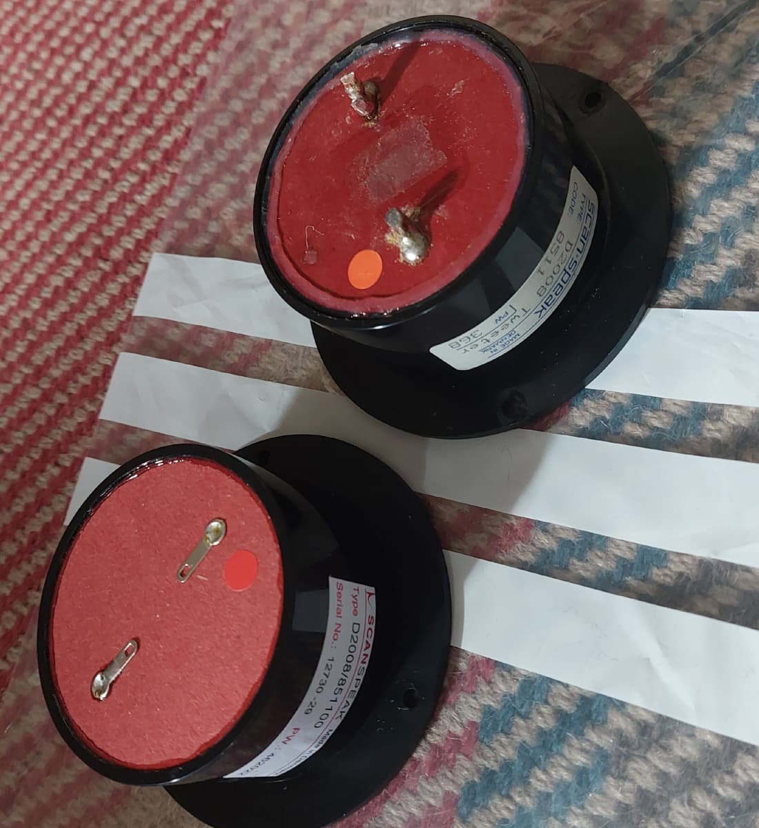

Showing the original tweeter, when I was updating it with a same type replacement.
Original and replacement tweeter
Thanks Geoff that confirms my suspicions, I will ‘un mod’ them!

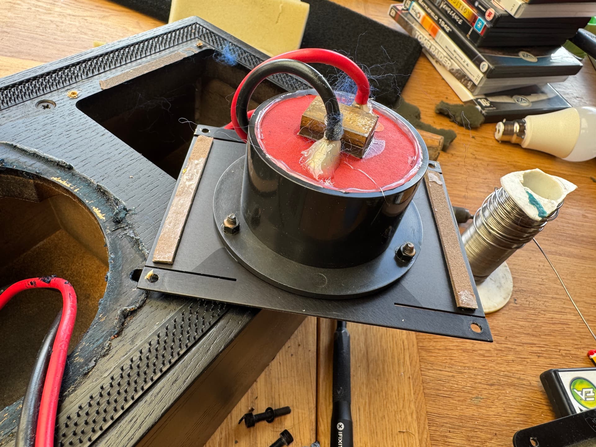

I think the tweeter plate is original mk1 config. The mk2 had grommets with the screws (probably no need for the strips?).
So you reckon no grommets? I am struggling to see where any suspension would come into play?
I guess the IBL mk1 was the first incarnation ever of that tweeter plate. My two pairs IBL mk1 had just that config. Strips and screws (nothing more than the small screws) tweeter plate mounted flush to cabinet (the sections with the screws) Mk2 upgrade included grommets so I guess it was the evolution, but suspension is working anyhow (maybe a bit different), strips may prevent rattle.
How did you remove the brass damping bits?
I have replaced the tweeters but not transferred the damping bits. Does it make a big difference?
I think I used a scalpel very carefully under the small piece of foam they were attached to. I reattached them to the new tweeters using superglue.
I recall reading they are recommended - I tried them without and felt treble performance was definitely better with the dampers
On my next IBL exercise, I’ll transfer them. When I replaced the old tweeters, the difference was large. I can see why the previous owner wanted to sell them. When the tweeters were replaced, they turned from ‘grey’ into ‘alive’ if that makes sense.
Just to clarify, the difference with the dampers was noticeable and positive.
I too found the difference from old tweeter to new tweeter was large - bringing more performance out of the music.
My iBLs were upgraded to Mk 2 during a visit to the factory. They have grommets and small metal washers at the screw heads.

I have seen documentation on the mk2 upgrade and it was more like a shrinking tube that was to be put half way thru the screw hole and compress when fastening, to act like grommets. I wonder if all mk2 was like this or if there where actual grommets later on in production of the mk2?

Great news you could actually get the brass bits off from the tweeters with such little damage. I wonder if super glue is the original compound? Seems reasonable I agree.

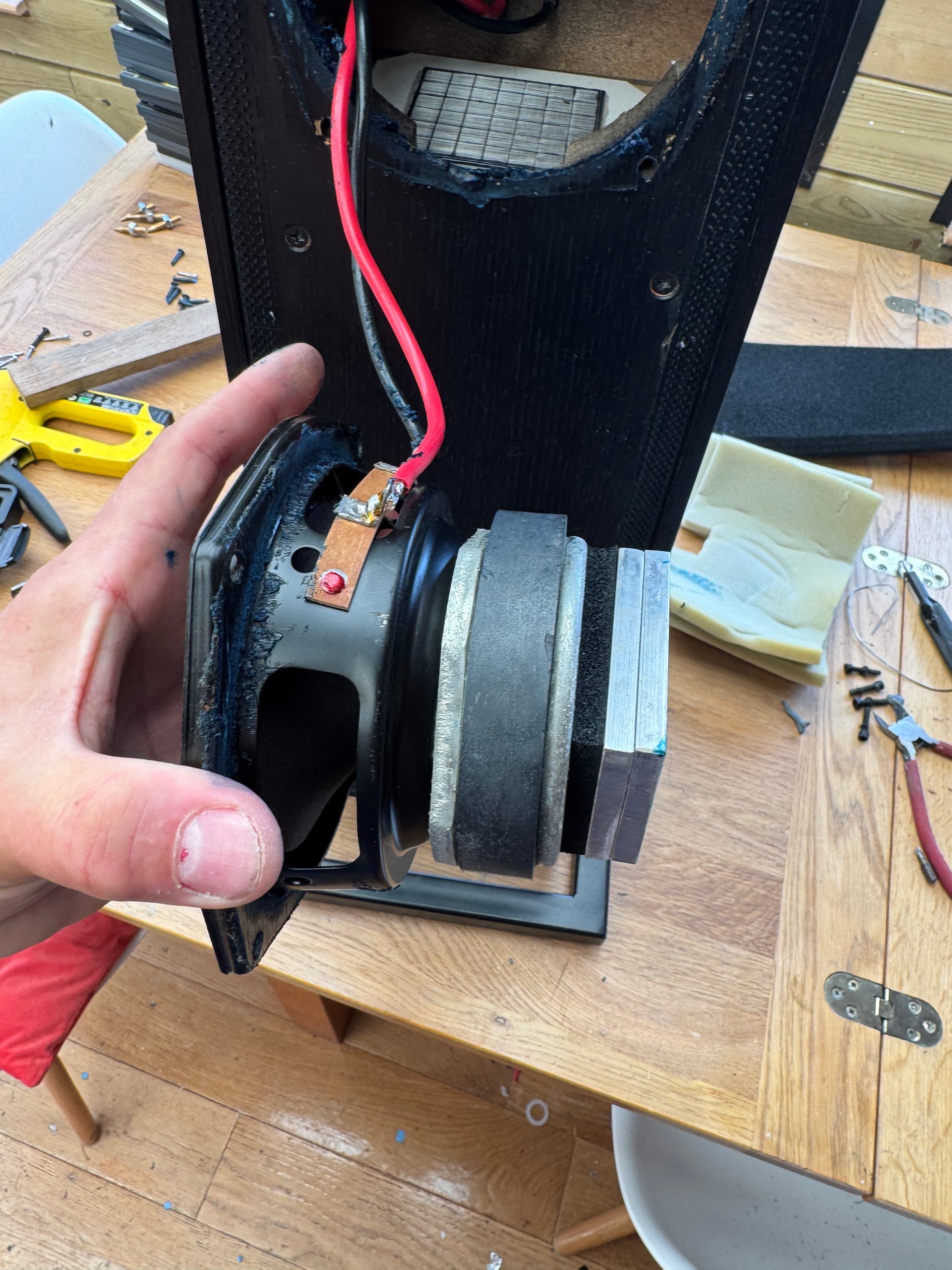

One thing I always wondered about the IBLs is what torque the bass drivers should be set at? Was there even a precise torque for them back in the days?
I tried high numbers when I rebuilt my two pairs into one perfect one. I tried 2,5-3,6mm and found 3,5nm to sound the best. With more experience of torquing speaker drivers today, that is a very high number.
