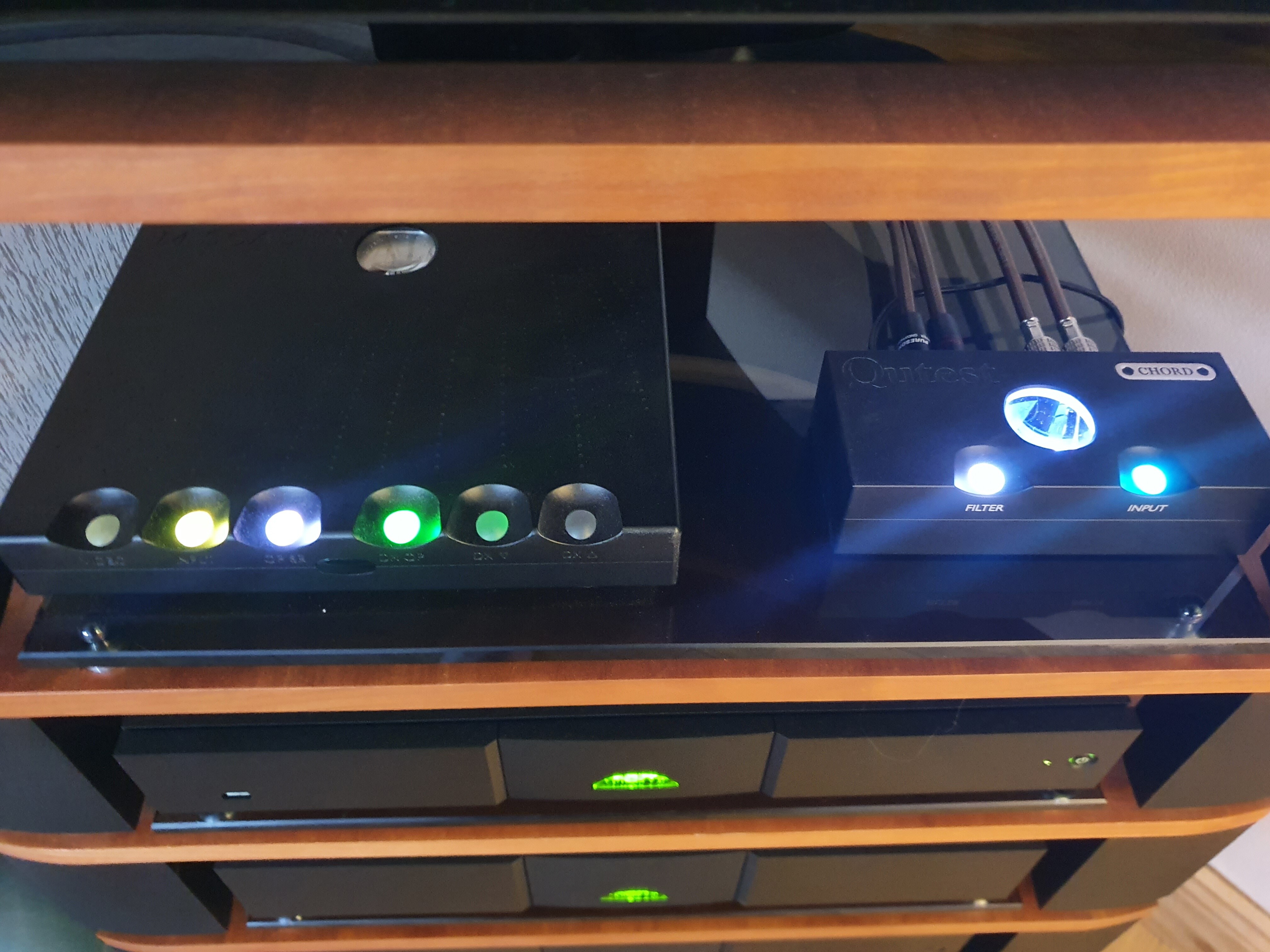

Yes, the left of the right trio (if you see what I mean!) is the DXOP which represents sample rate. And it never changes from red. The buttons themselves are redundant for now, but this led always shows red.
Which means you are sending a 44.1 kHz signal to the mscalar, which is normal.
If the right led on the left back is white (full oversample) , and you have the twin BNCs to your DAC you will be outputting 705.6 oversampled digital to your DAC.. the mscalar is working as intended.
If you send a 96 kHz to the mscalar then that input LED will be green instead of red.. with 96 kHz you will output a 768 kHz signal via the two BNC leads.
The left LED of the right bank represents signal INPUT sample rate and has the following colours

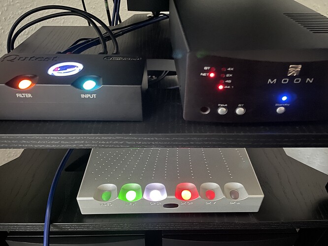

Ist picture I’m sending 44.1 kHz to MScaler via ND5XS2 BNC to BNC input 1 on Mscaler
2nd picture 96 kHz to Mscaler
Full oversampled output to Qutest on both
So in that picture… you have 44.1kHz input to mscalar and ASSUMING you have the DX leads set up properly on the back… BNC 1 and BNC 2 … then you are outputting 705.6 kHz
If you don’t have the leads setup properly then the max you will output into your DAC is 176.4.

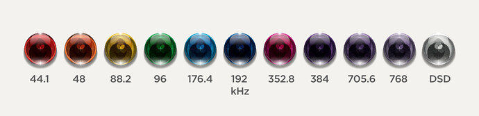

The colour on Qutest DAC for a 176.4 input blue… and 705.6 input purple. (This is in the viewing glass… not the buttons)… we can’t see this in your pictures.
