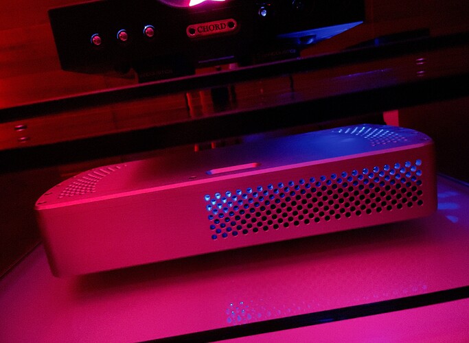

The Empyrean rules the day but at night, the Etude is king. Tonight was trance night and with a little 5th Element lighting, the Etude was looking suitably futuristic for the part!
It’s been just over a month now since the Etude arrived but the way it has gelled all the Chord Elements together makes me wish I’d done this way sooner.
