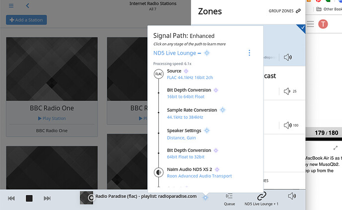

I am just listening to the RP Main Mix FLAC stream via Roon (on my MacBook Air i5 as the Roon Core) upscaled into my ND5XS2 (with Chord Hugo TT2 DAC) and my new MusoQb2 as a grouped zone in Roon.
The ND5XS2 digital output is supporting 192kHz output as per the light on the TT2.
The result is a genuine step up from the already good RP AAC 320kbps stream(s) and , as with all the RP channels, an absolute pleasure to listen to.
