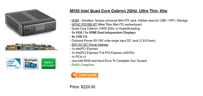

I’m using this, with the Daphile OS installed (see here). So simple and easy to use …
