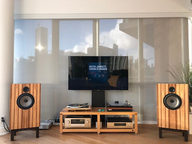

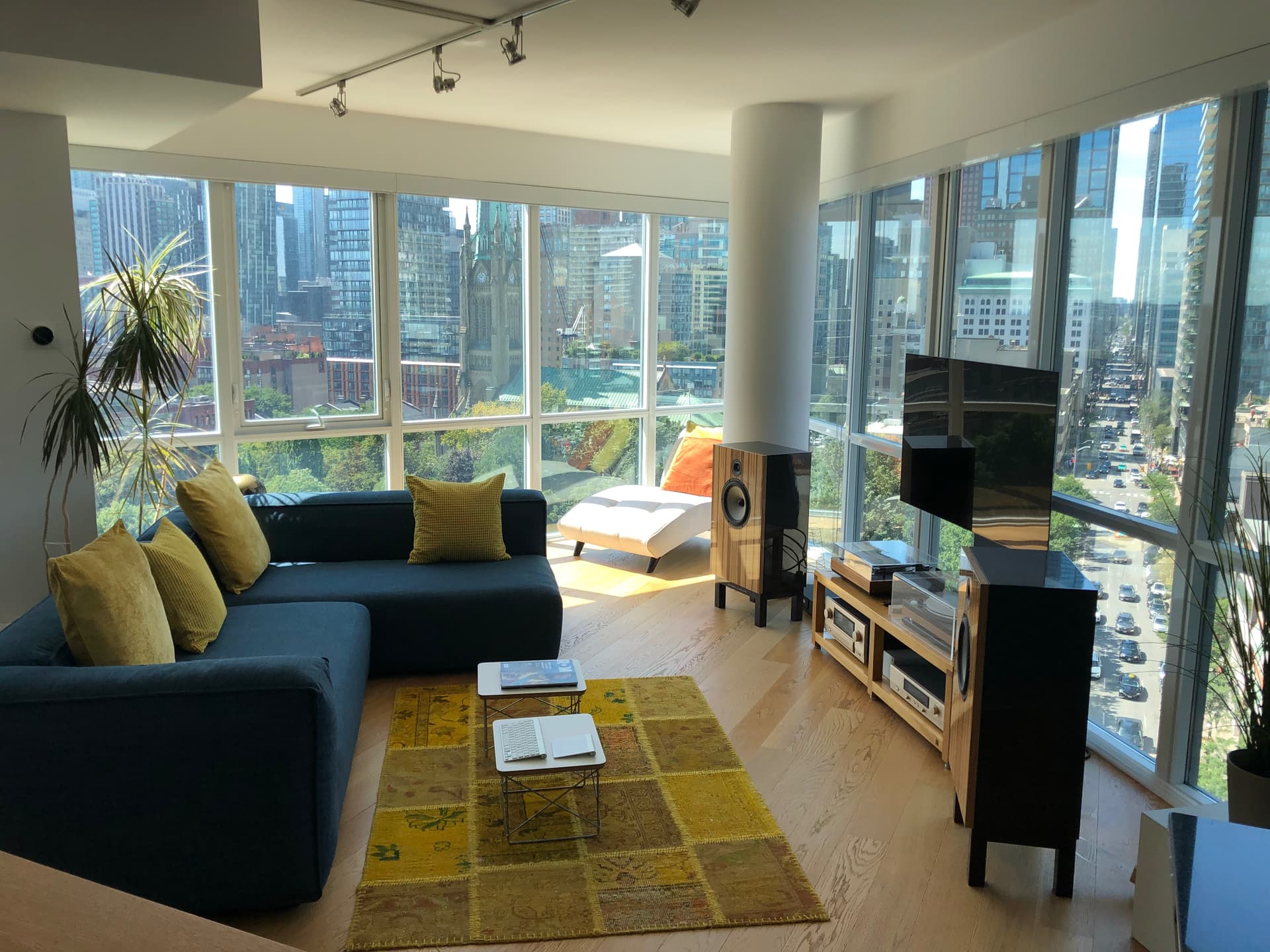

I’m considering Devore speakers which port to the rear. However, my listening room is backed by a large glass view wall. The wall does include two posts which is where I place the speakers. Currently I have Rega RS3’s which port to the front.

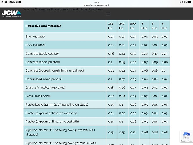

As far as being rear-ported is concerned, I guess it depends how close to the wall the speaker ports will be. aside from the possibility of resonance of glass panels, which would colour the sound, a significant problem is the large acoustically reflective wall - it would apply whether or not glass, the more so the more reflective, and glass is more reflective at high frequencies than many constructions, behind the speakers. The result will be comb filtering of higher frequencies. Placing something absorbent or diffusing behind the speakers when playing music would likely be desirable and beneficial.

I suspect from the pictures, you are probably okay. They don’t seem to be hugging the wall and glass doesn’t reinforce low frequency energy that well. You can experiment.
Lovely room by the way. Looks fantastic.

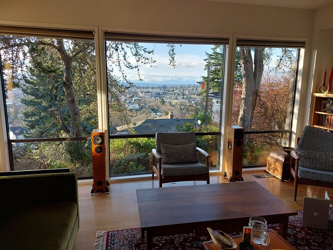

Should see what @ChrisBell has to say. He has very similar layout.
Both of you have beautiful rooms and views btw

OP: do you live in Seattle? Your view looks like Phinney Ridge.

Hey Chris, yes I do! Straight down below the zoo, about halfway down.

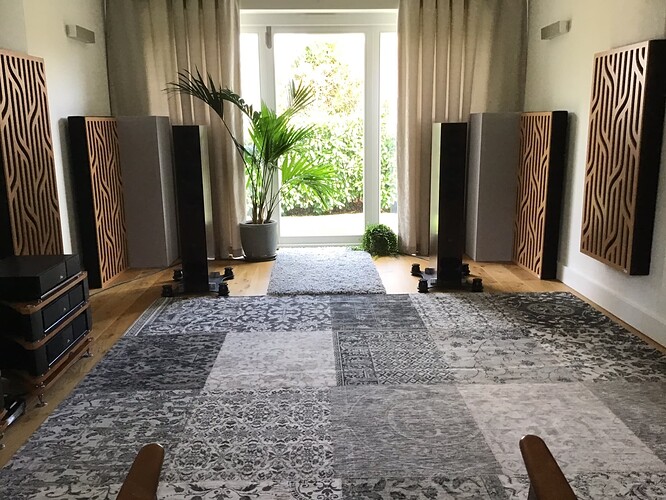

My own situation is somewhat similar to yours, but my speaker set up is at a much bigger distance from front wall (glass) to favour both points above ( 1.6 metres distance) Also my rear wall behind the listening position is quite heavily treated for 1st reflections and reverb throughout the frequency range:
I managed to ‘hide’ frequency tuned membrane absorbers behind the curtains. Good luck with it :+1:t3: Best Peter
