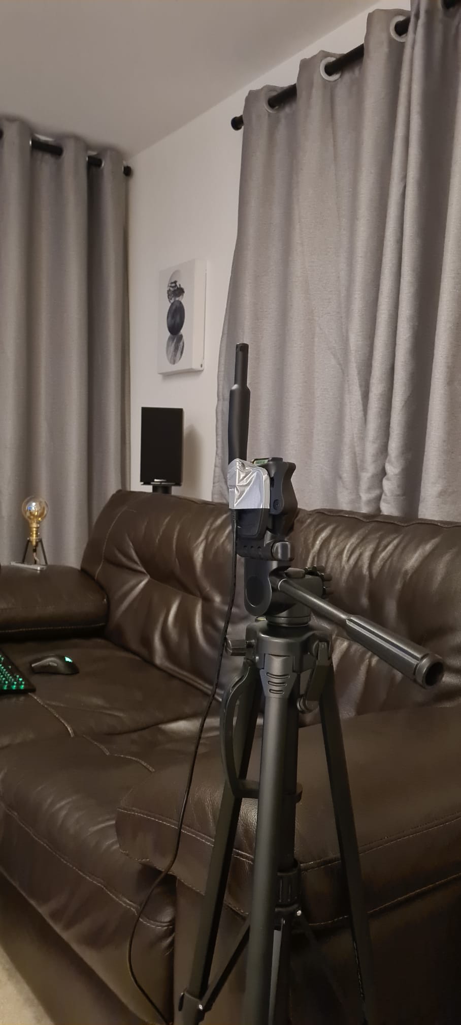

Thanks all, now sorted, the Naim forum hive mind came through again!
The solution was:
  1. Move the speakers back further out (but not quite as far as I originally had them right in the corners).
  2. Using the newest version of Dirac to run a ‘wide image’ calibration using seventeen points covering a cuboid of measurement positions around the couch in addition to the central listening position.
I don’t know if this helped with the imaging but this certainly made everything sound better - during my Dirac research I learnt about Schroeder frequency to appropriately set the “target curtains” mentioned by @Edmund-of-Essex; the upper limit around 500hz and the lower limit set at per stated frequency range for the relevant speaker. This addressed the node/anti-node interference in the room but without changing the voice of the speakers. Really noticeable when watching the intro to Bosch - the symbols almost completely disappeared with my original Dirac calibration applied to 20hz - 20khz - now they are back and everything sounds more natural.
