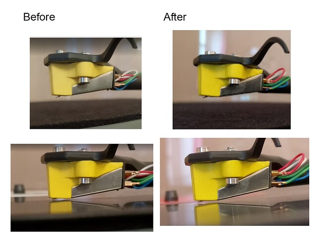

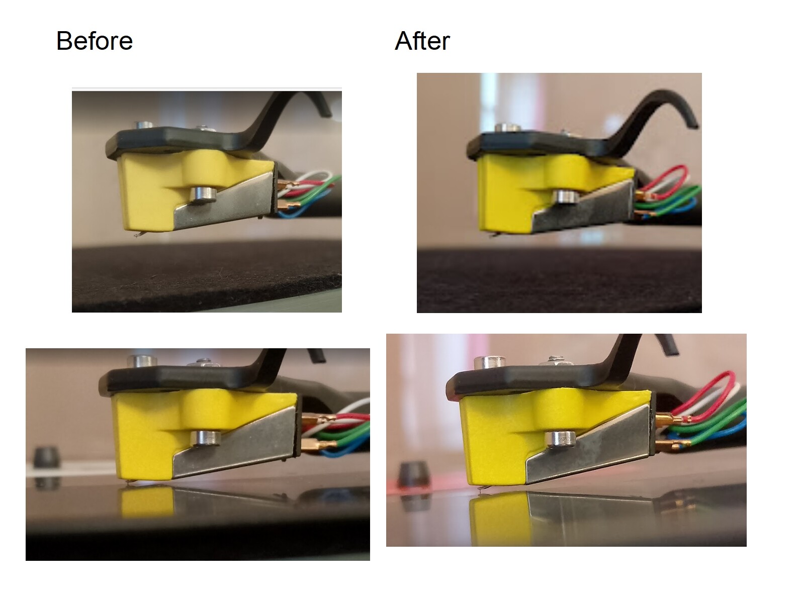

Well, here’s the result, old one on the left. new one on the right. Not a lot of difference, but it looks to me like it’s now a marginally better clearance when resting on the record, but no difference when in the air. I guess that confirms the old one had worn suspension.
It sounds great though! Definitely an audible difference between an old Rega 2 and a nearly new Rega 3. So I’ll give a thumbs up for the seller who sorted it with Rega at no cost to me!
Looks a lot better.
