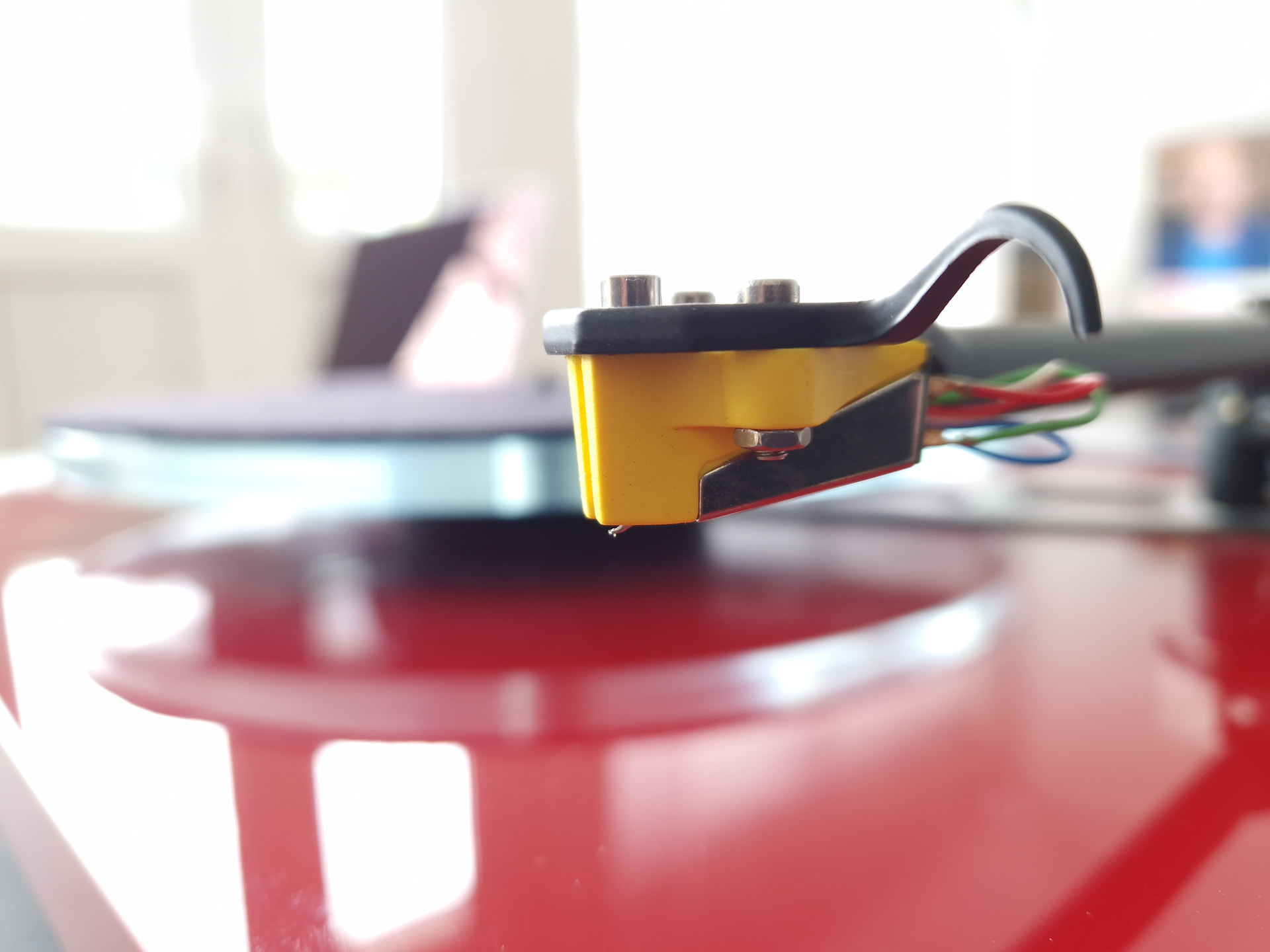

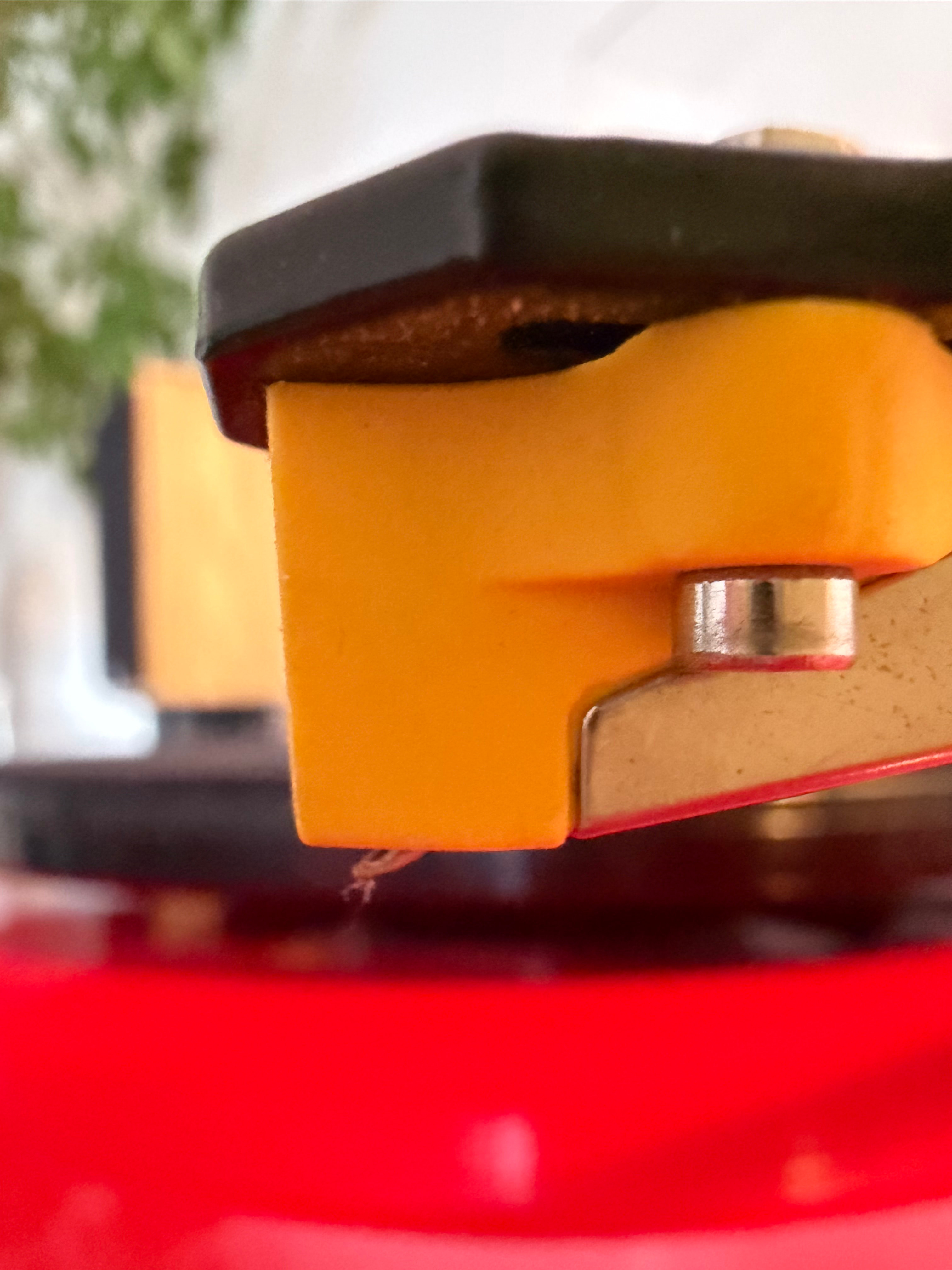

Recently acquired a Planar 3 with Exact, but it seems to track very low, i.e. almost scraping the record - does this look right? Also looks like it needs a VTA shim, but Rega don’t like those, it’s a standard Rega arm and cartridge so should be correct height.
Hi,It does look low from the pic, is it an original Rega mat?
The centre spindle looks to be short, hence the question on the mat depth.
Looks too low to me.
…and to me - what’s the tracking weight? DGP
When I bought my first turntable, Rega P3 with Exact, few years back, I had the same issue and I sent the cartridge for a investigation, which then showed that suspension had a issue. Got a new one back and it didn’t have the same issue.
I’ve heard that about 10 years back there were a lot of butylrubber which didn’t have right specs. That is used on many cartridges and might have caused the issue.

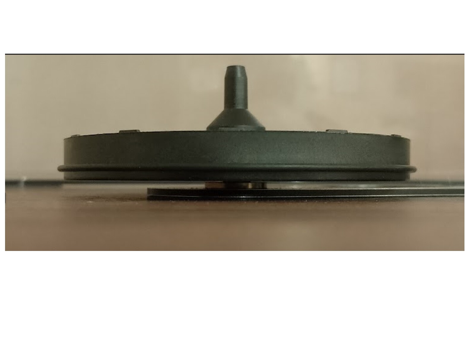

Thank you for all the comment so far.
Yes, as far as I know, it’s the standard Rega felt mat, but it’s a lot thinner than the one on my old Planar 2. The Rega 3’s glass platter is thicker than the 2, so the centre spindle protrudes less - or should the “3” have a different central sub-platter with a longer spindle?
Track weight is 1.75g.
I’ve got a P3 and an Rp6 and had a few exacts over the years, as others have mentioned, could be a depleted suspension on the cart, a mate had the same happen.
Should add that the new ND range of carts from Rega are different class compared to the old exact.
The belt also sits quite low, looks odd, or is this right with the 24v motor?
It looks too low. Check the VTF as it may be too high. if it’s ok then maybe the cantilever or suspension had collapsed?
Probably not related.
But has the bolt been tightened correctly, looks like there is a gap under the head.

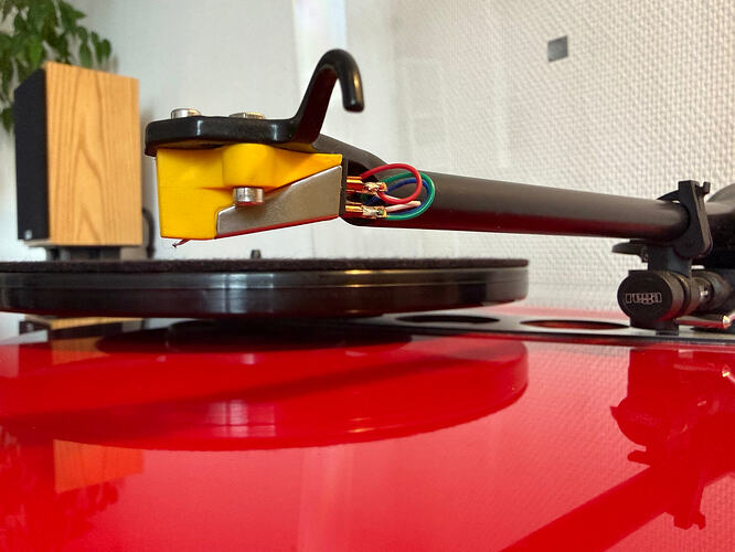

My Rega Exact looked exactly the same and there are a few discussions about it on the net. As long as the rear makes no contact with the record and it sound ok to you I would not worry unduly about it. It’s a ‘low rider’.

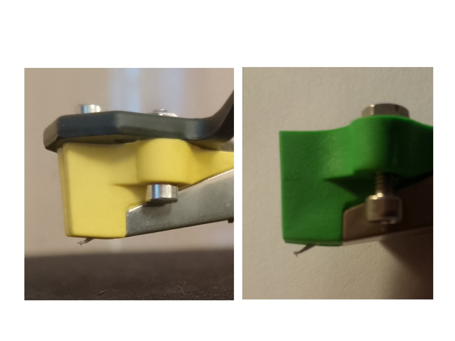

That’s the only side on cartridge photo I can find of my P3/Exact but you can see even here that the tail of the front section seems a little lower
I’ve had a look around the web, and yes there are similar comments, but about a 50-50 split on whether it’s a problem or not!

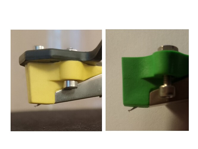

I compared it with my old Rega Bias, looks to be the same basic construction, although I appreciate they are years (and £pounds) apart, but the comparison shows my Exact to be much lower (both in the air for the picture, not on the record). Should they look the same?
Does it sound ok to you? That is all that really matters.
Having said that, once doubts set in …

Comparing yours with mine, your Exact is definitely riding higher than mine, only about 1mm but that’s all it takes at this level :slightly_smiling_face:
