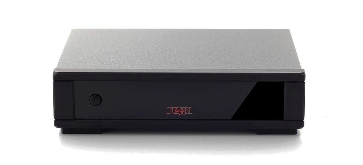

Have you considered getting a Rega Fono? It’s a perfect match for the Elys and doesn’t need a separate power supply.

The Hicap is the best. But…. a Stageline and Hicap is rather wasted on a P3/Elys. A Fono is half the price and a perfect match.
I’ve never felt the Stageline N and Elys matched that well - the result was a bit flat and dull to my ears. A Fono here may be the better better and a secondhand one should only cost around Ā£150.

This is the latest Mk 5 Fono MM. £220.
