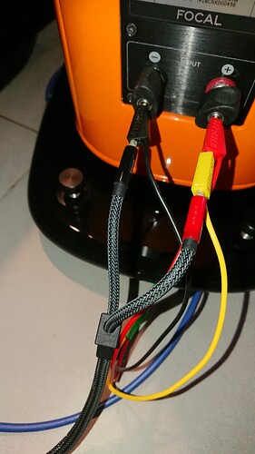

Yes, if you connect black to negative and red to positive it should be fine. You’ll want to cover the unused yellow plug to make sure it doesn’t touch anything it shouldn’t.

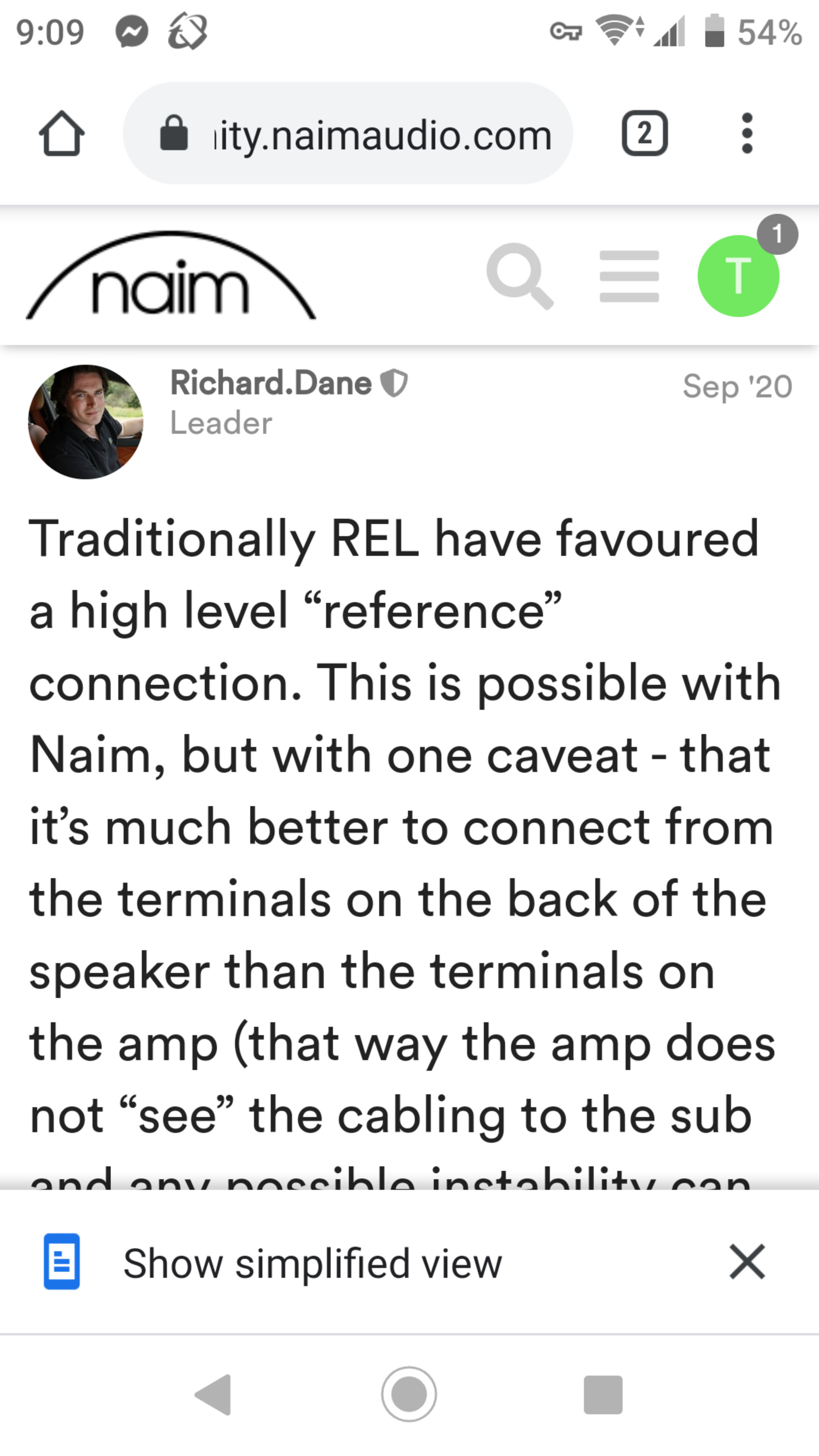

The point of using the Naim version of Rel’s Bassline Blue cable is that you can connect to the amp, not the speaker.

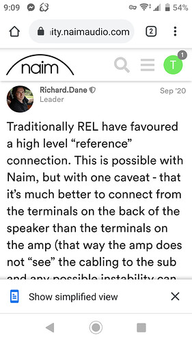

Nope naim n rel prefer back of speaker

Here’s a comment from Richard aswell… Rel and naim suggest speaker end

Well I’m only going by naim and rel and after emailing them both and getting my replies and use them in my system but try both ways n see what u prefer… Red n yellow together unless it’s to loud n u can’t get past 6 or 7 clicks in gain then remove n tape a red or yellow cable n this will half the output

You can, in fact, connect only the red or yellow connector to the positive terminal and leave the other one free. However, the signal level going to the sub will be reduced, so that you will probably need a higher gain when you tune the sub.

I don’t know the baseline blue cable (apart from what is written on the REL website) and what specifically has been done to it to make it suitable for Naim amps so could not say, sorry. I guess a dealer long familiar with running Naim and REL would be the best one to advise on whether it sounds better to run from the speakers or from the amp (and whether if running the latter it really does avoid any issues). If in doubt just run from the speakers, as has hitherto been Naim’s recommendation.

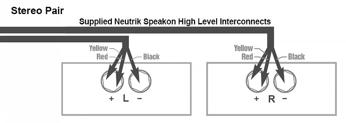

Also from the REL website it suggest connecting the red and yellow together for each sub :-
If connecting 2 RELs, connect the black wire of each REL to a negative speaker terminal of the corresponding channel; twist together the red and yellow wires of each REL separately and connect each pair to the positive speaker terminal of the corresponding amplifier channel. In some instances, this will result in exceptionally high gain (output) from the RELs. If it seems simply too high in gain, please remove either the red or yellow wire from the twisted pair. This will reduce output by half and restore a natural dynamic.
