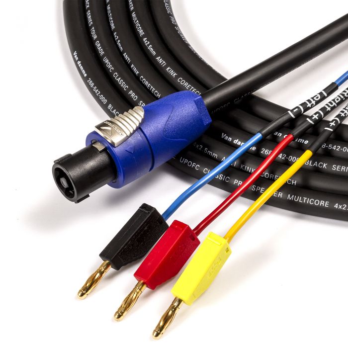

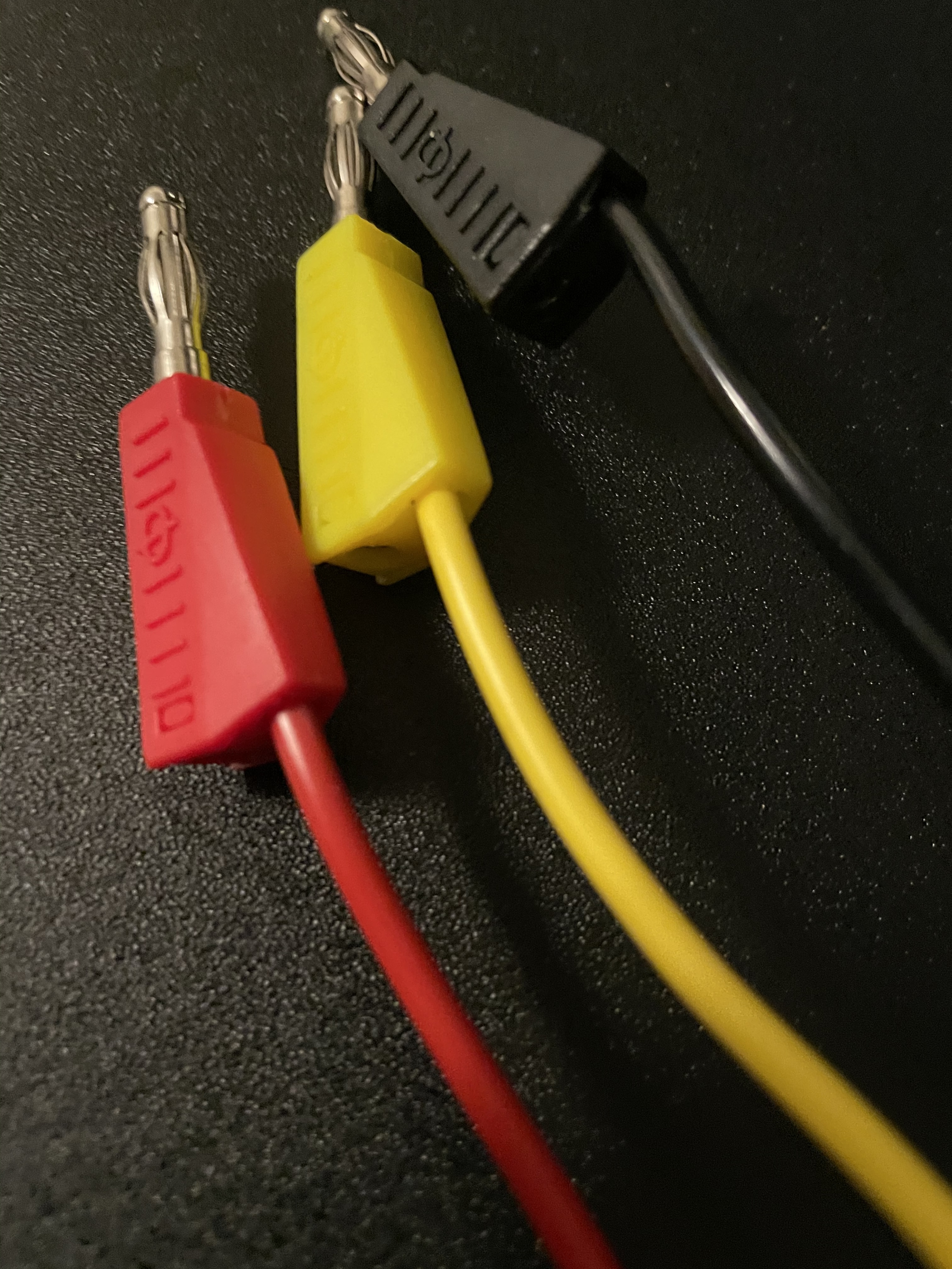

Do you mind sharing some pictures of the cables? It might become easier for everyone to give some suggestions then.
This is what the bassline blue stackables looks like.
I guess that’s not going to work if you use Naim plugs on your speaker cables without modifying them.
So assuming that the +/- are consistent with this picture:
You should connect the yellow and black cables of the left sub to the left channel of the amp. Similarly, the red and black cables of the right sub to the right channel of the amp. And stack the speaker cables on top of them. In the end there will be one unused red and one unused yellow cable left. I hope this makes sense!
