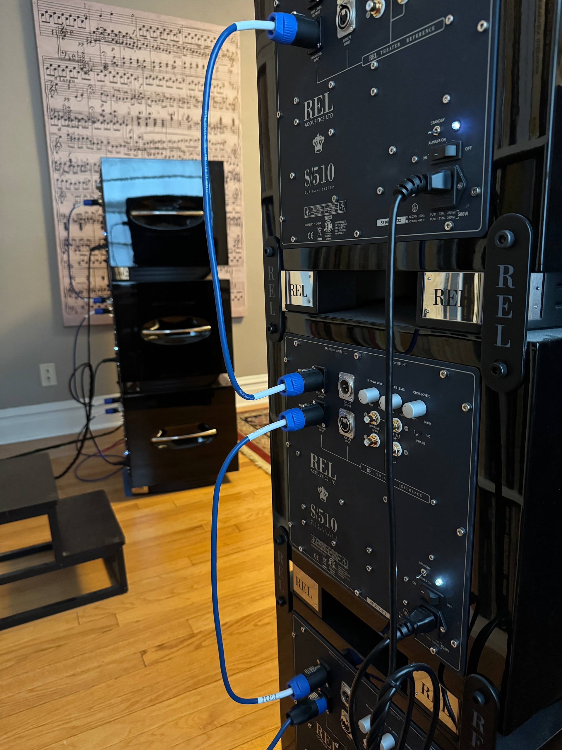

I have a six-pack of REL S/510. I use the REL Bassline Blue to connect them directlty to my speaker terminals. The red/yellow of each cable goes to the positive terminal. I combine the black leads via a ground wire and connect that to my Clearaudio Terra grounding station. The jumpers between each level are also Bassline Blue. I bought one pair used for about half price and the other pair were provided by my REL dealer free of charge.
The way I handled the Bassline Blue cable from my speakers to the first level of the S/510 was to buy a 3m pair, cut that in half and re-termine the bare ends (SpeakOn connect for one, spade fof the other) to end up with a 1.5m pair. That’s all I need since the six-pack pairs are next to my speakers.
N.B. If you use fully balanced monoblocks you need to leave the black leads hanging free unconnected, as per the manual. That’s true for the Naim 350s and will be true for the Boulder 1151 amps I plan to get.

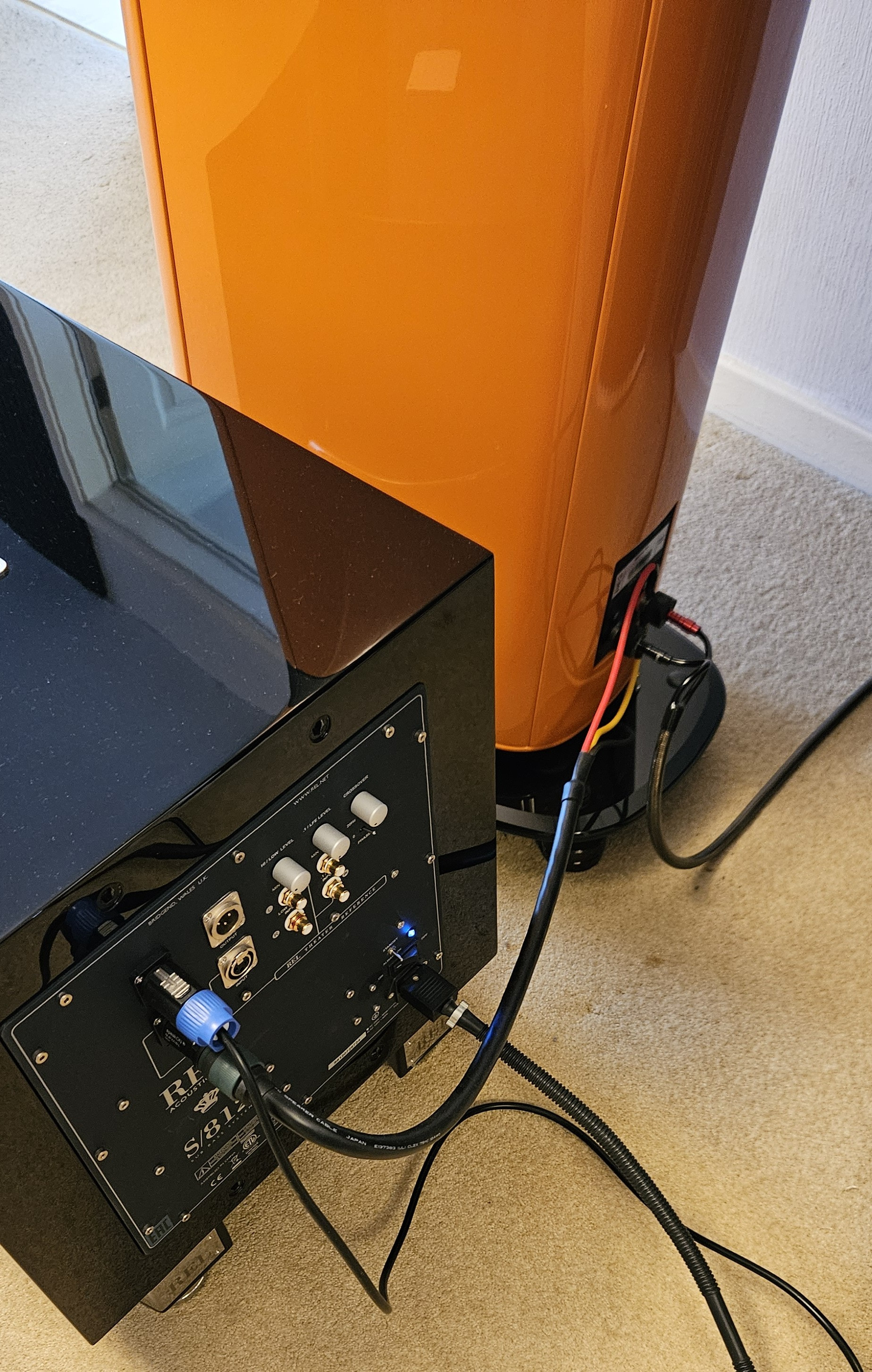

Yes it is much tidier from the amp rather than the speakers. If you do it from the speakers you have to split the Rel provided Cable so it can each both sides. I did it as a test and the result was a pretty messy wire.
Or you lust buy a couple of shorter cables.
Hey @kitfit1 - I’d forgotten you had those shorter cables made up. Mogami, right? I should really get some to replace the stock REL cables - yours look so much tidier!

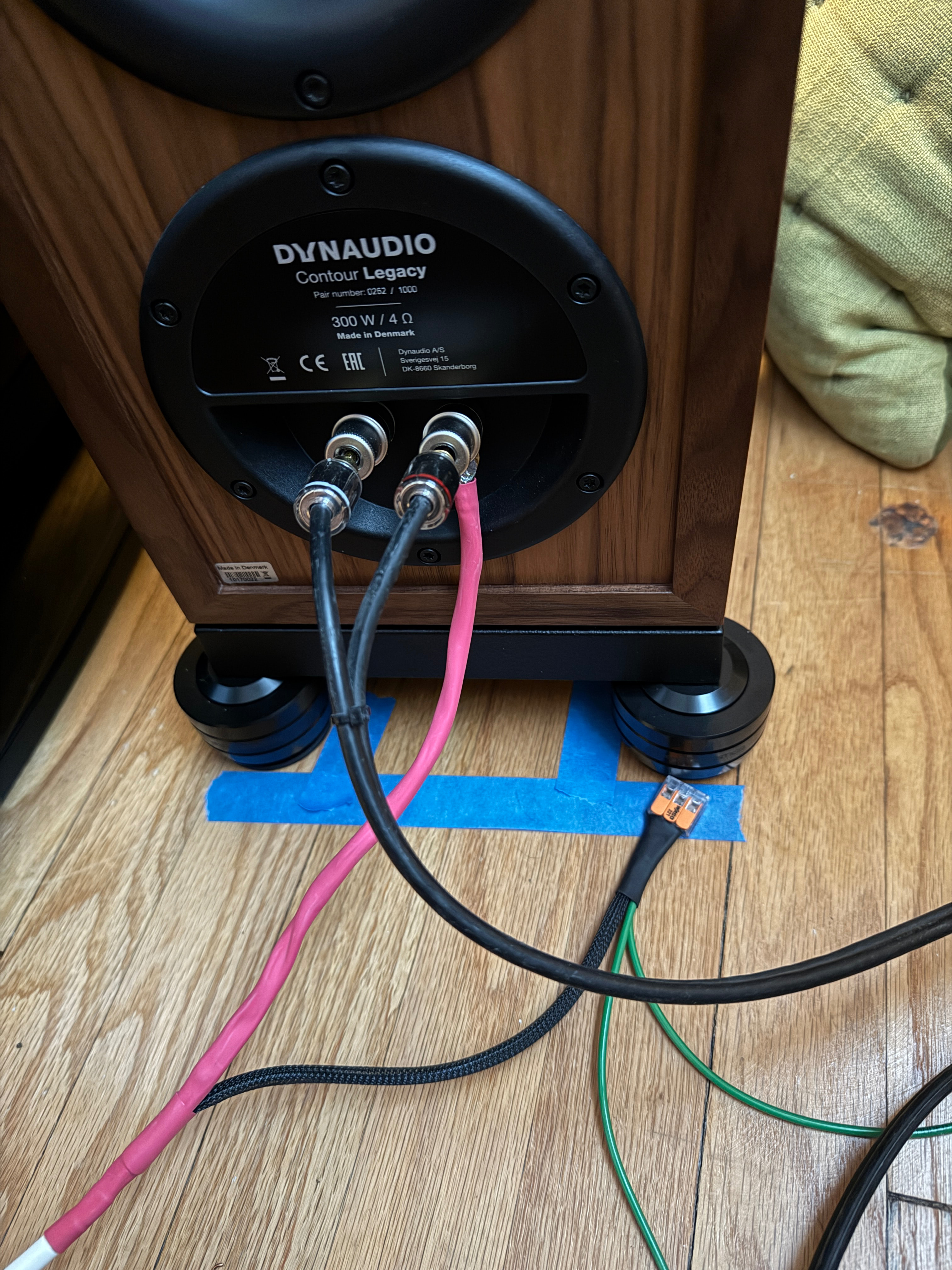

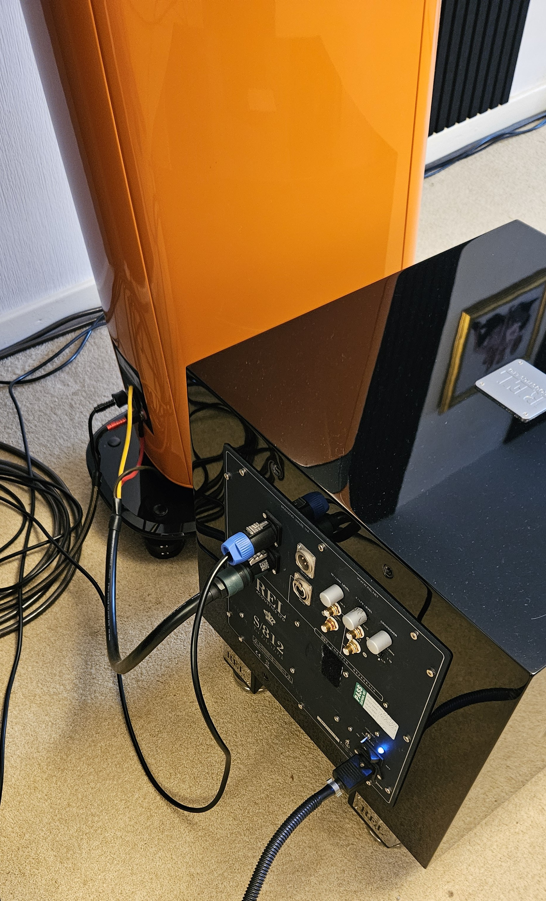

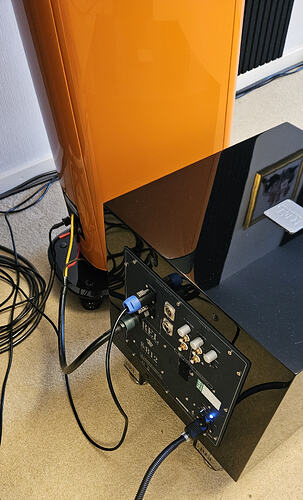

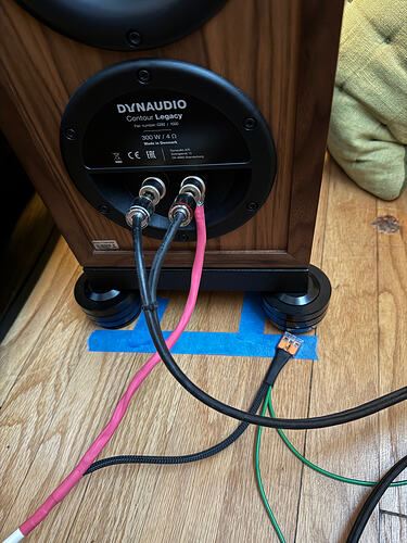

Yep, they are Design Cables Mogami 75cm. They stock them though, so not made up especially. As you Have the same speakers and preamp as me, something worth noting.
If you connect both the live and ground to the speakers you will notice a constant “wooshing” sound from the speakers even with the volume at zero and speakers muted. It had me baffled for a while, but then it hit me. I plugged in the supplied REL cables and run the ground of each sub back to the ground on the 282, then disconnected the Mogami ground from each speaker. Harmony and silence followed. That’s why you can see the top Neutric plugged in on each sub.

In my use case it worked for me. That’s because my rig is powered from a BPS but my subs are powered from the ring main. Because a BPS’s earth is centre tapped and has no connection to the mains earth, my subs and my rig therefor had no common ground plane. Running one back to the 282 solved that problem.
