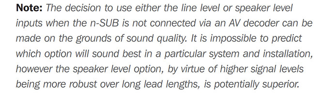

I believe that was from the n-Sub manual rather than from the FAQ to which I was referring.
That also doesn’t take into account the possibility of using a line driver such as a DSpeaker Antimode or a miniDSP 2x4. On the other hand, if the leads to the sub (after the line driver) were to exceed about 20m then I would tend to agree, below 20m the effect of any possible lack of “robustness” of the signal is so small as to be insignificant.
The necessity of using a 100Ω resistor in series with long cables if directly connected to the output of a Naim preamp (to reduce the effect of the capacitance of the cable presenting a load that the preamp was never designed to drive) will have more effect on “robustness” of the signal than the long cable itself. This requirement is removed by using a line driver as previously suggested.
I have enough theoretical knowledge and practical experience to understand the possibilities and limitations of each solution. High level isn’t the best solution, but where long cables are required neither is it the worst.
What I don’t have at the moment, is the necessary time to go through all the advantages, disadvantages and caveats (including the electronic and signal theory supporting these) for each of the three main solutions.
