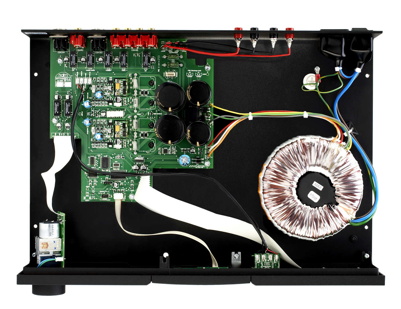

I have tried removing the lid with little success. After taking out the bolts, the lid pulls up but seems fixed inside towards the front of the amp. Anyone know how, without damaging it.
Yes, there’s a front hex bolt accessible via a small hole. Be careful as easily damaged.
@Richard.Dane will advise more accurately im sure.
Yes, the lid is bolted onto a cast flange coming off the fascia. You need to be careful here. The socket type changed at some point (@NeilS can advise here on which was used with the NAIT 5i italic). Be very careful as the zinc magnesium alloy is quite soft and it’s easy to break or punch a dimple if you overtighten. It does the beg the question, why are you trying to remove the cover?
They were originally no.1 Pozi drive & changed to T10 Torx.
I can’t recall when the change was, but if the screws between the RCA sockets are Torx then the one inside will definitely be the same, as the machine thread screws were changed first.

Back to the subject in hand, my reasoning for asking about removing the lid was, the logo has gone quite dim (on the cd too) but when i owned a cd3.5, same issue with the logo, but when i removed the lid & pressed slightly with the end of a screw driver against where the logo attaches, it lit back up & wondered if it could work with these. Probably not but thought it may worth a go.
The laser is of more importance really because i do get error sometimes when playing certain discs & is probably on it’s way out.
The most likely cause of the crescent style logo dimming is due to the “bleed” issue. Replacement is really the only fix for that.
