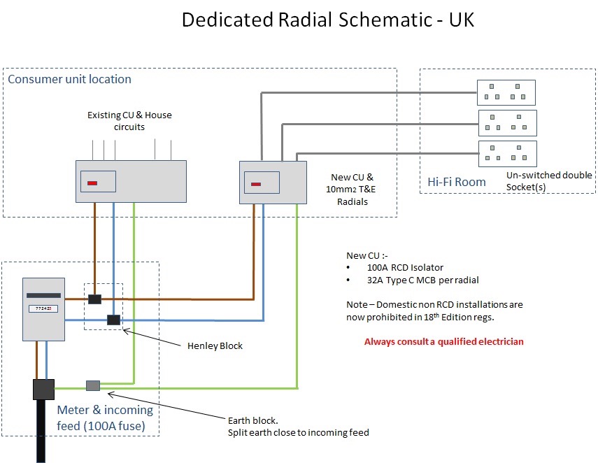

Simplest method is ask for a separate spur from the board like they do for central heating combi boilers now.
It’s not expensive just messy to install maybe. :+1:
That was the original plan. I’ve since found a diagram on here (see below) of someone’s installation and it took a feed from before the distribution board to the new sockets via a dedicated distribution board. I’ve no doubt that we’d then be well into diminishing returns but I can see the thinking behind it.
Most “sparkies” won’t know why you want this. The thing is though, you don’t actually need it. Just buy a balanced power supply like an Airlink ASF3000MP and plug it into your mains socket. It will kill any and all mains nasties strait away and give you a clear audio experience. By it’s very nature and the way it works, a balanced power supply negates the need for any other type of supply to your gear. No need for a sparks, no need to re-decorate, no need to worry the wife. Just never ever ever plug in an SMPS into it…………………………….it will add all it’s rubbish straight to your now clean mains.
