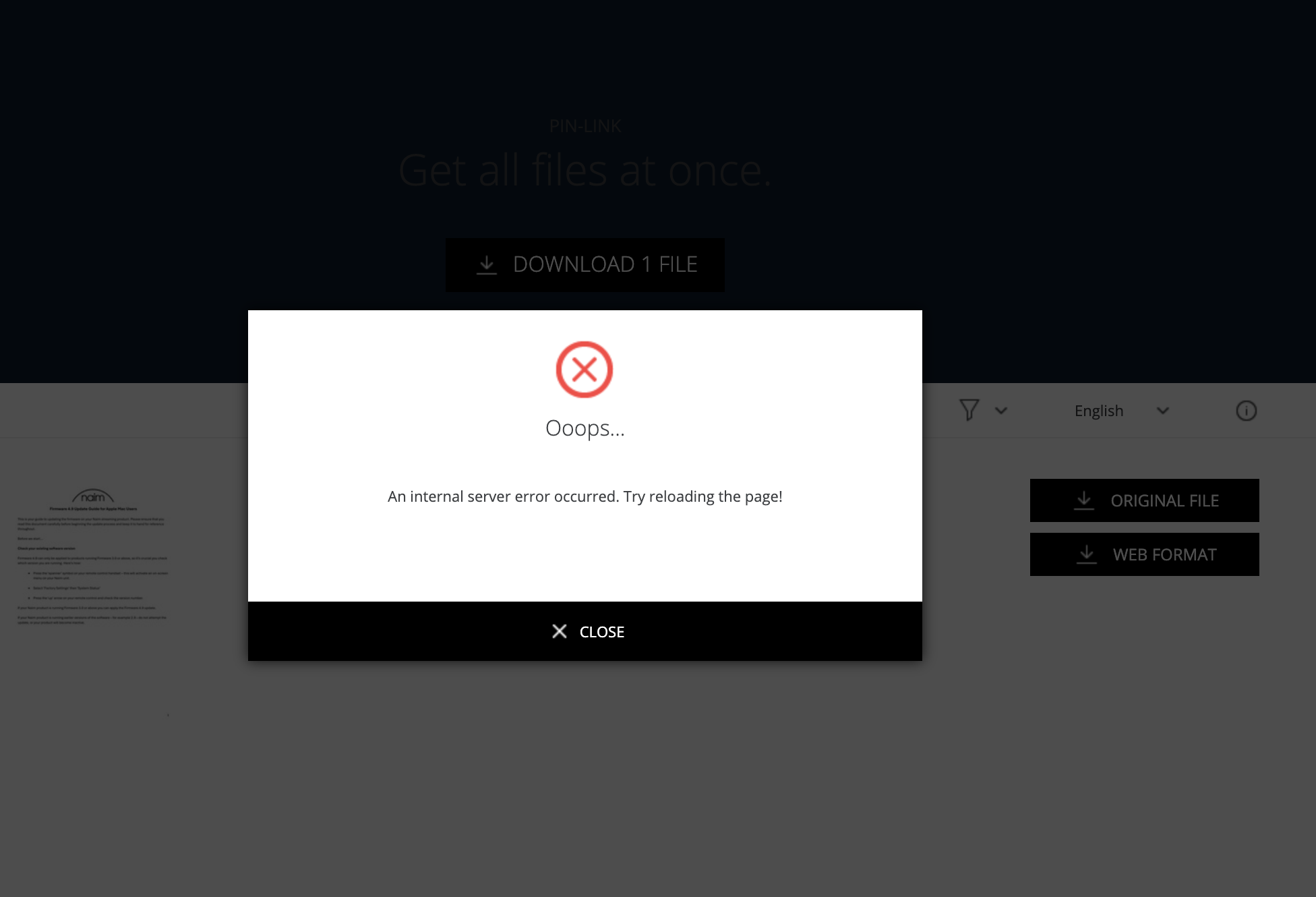

Unfortunately, the official update links in the following PDF (https://media.focal-naim.com/naim/file_manager_files/pages/legal/updates/streamingproducts-update.pdf) seem to be broken or outdated. I am walled out by an error message stating internal server error. Image attached below.

I tried following the instructions from both posts, but no luck so far. From the PDF that Robert.Dane shared, only the instructions for the 4.8 update load properly. Every other link returns the same error message.
I also tested the links from robert_h’s post — same result.
To rule out issues on my end, I’ve tried:
  • Multiple browsers (Chrome, Safari, Edge)
  • Both my desktop PC and MacBook
  • Clearing cache and cookies
Still no access.
When I try going directly to the root of the link (dam*[dot]focal[dot]*com), it prompts me for a username and password, which makes me wonder — are these really public links? Is it possible that those of you who can access them are already logged into some internal system without realizing it?
Would really appreciate any clarification on whether these links are meant to be public or if access is restricted somehow.

I’m happy to help if I can. The links to the software download are available to me right now, I just checked.
And yes they are public links. You don’t need to be logged into some Naim internal system to use them. For certain, I am not logged in to any Naim system at all except this forum.

The instruction are very clear and easy to follow. It’s just not happening. I wished I could post a video capture of my screen. In the absence of that here are two screenshots as of few
And here’s the second image. The forum rules doesn’t allow me to post more than one image apparently. “Sorry new users can only post embedded images”

Here’s everything:
4.9 for PC and mac
2 pdfs with the instructions for PC and mac
You mentioned using several browsers. For reference, what is the version of Chrome you tried? Ancient and fairly new ones tend to look identical.
And you may have to adjust security settings if you are using some aggressive and invasive Security product that thinks it knows best.
Sir, you’re truly a gem. Thank you so much—genuinely appreciate it.
As for everyone else’s questions: I’m running both a PC with Windows 11 Pro and a Mac with the M4 chip running on Sequoia 15.4.x. All my apps and systems are fully up to date. I’m generally quite tech-savvy, so I’m honestly baffled as to why I’m facing these issues when it seems to be working flawlessly for everyone else.
I do have the files now thanks to robert_h :folded_hands: Wish me luck!
