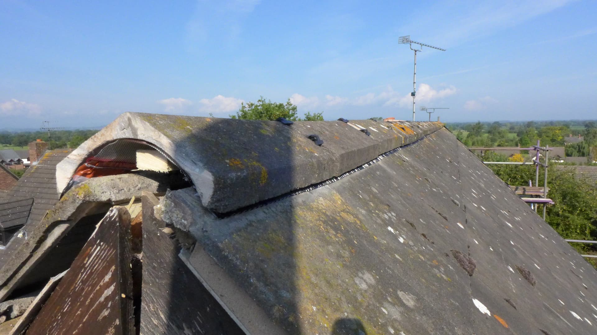

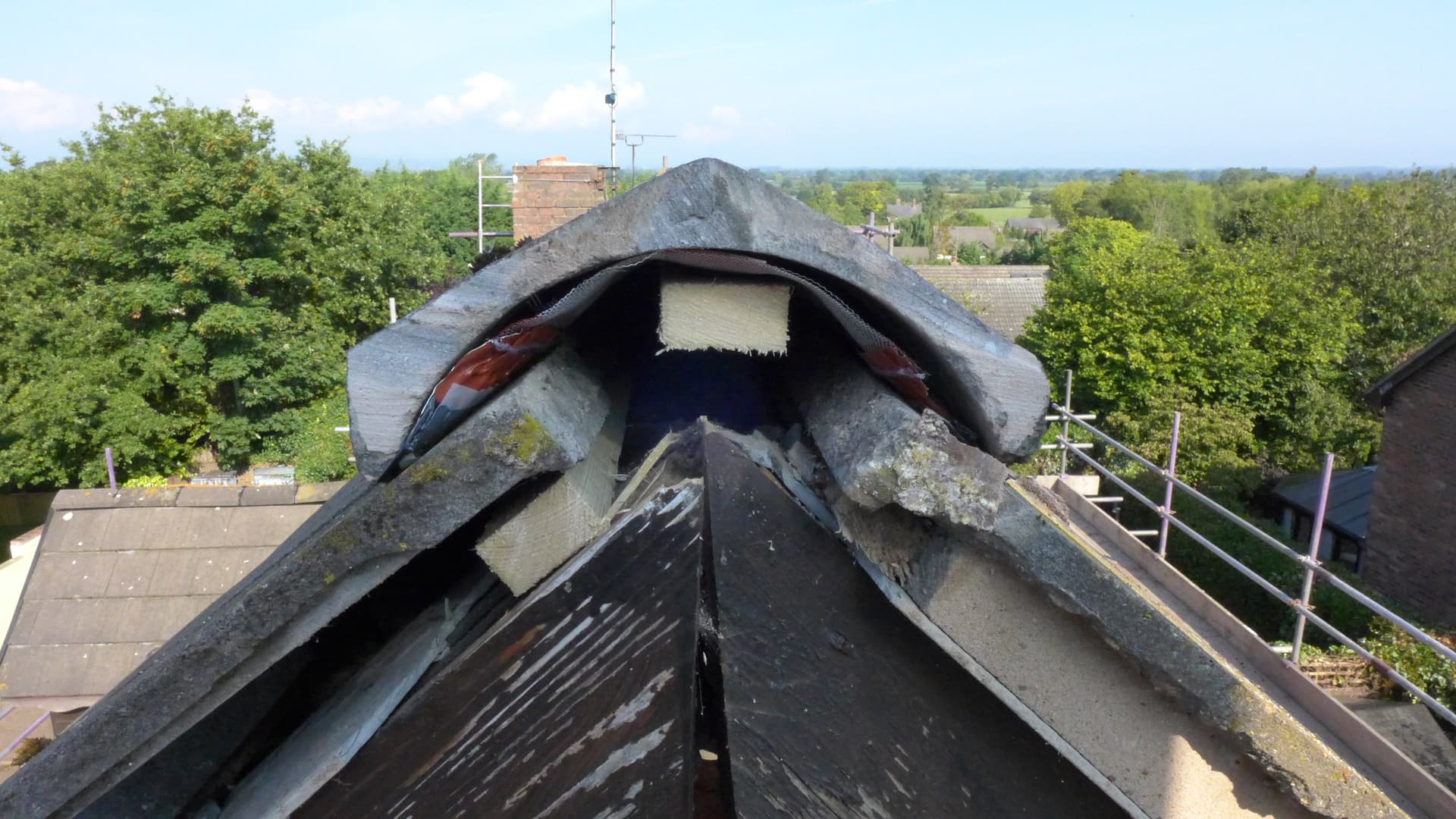

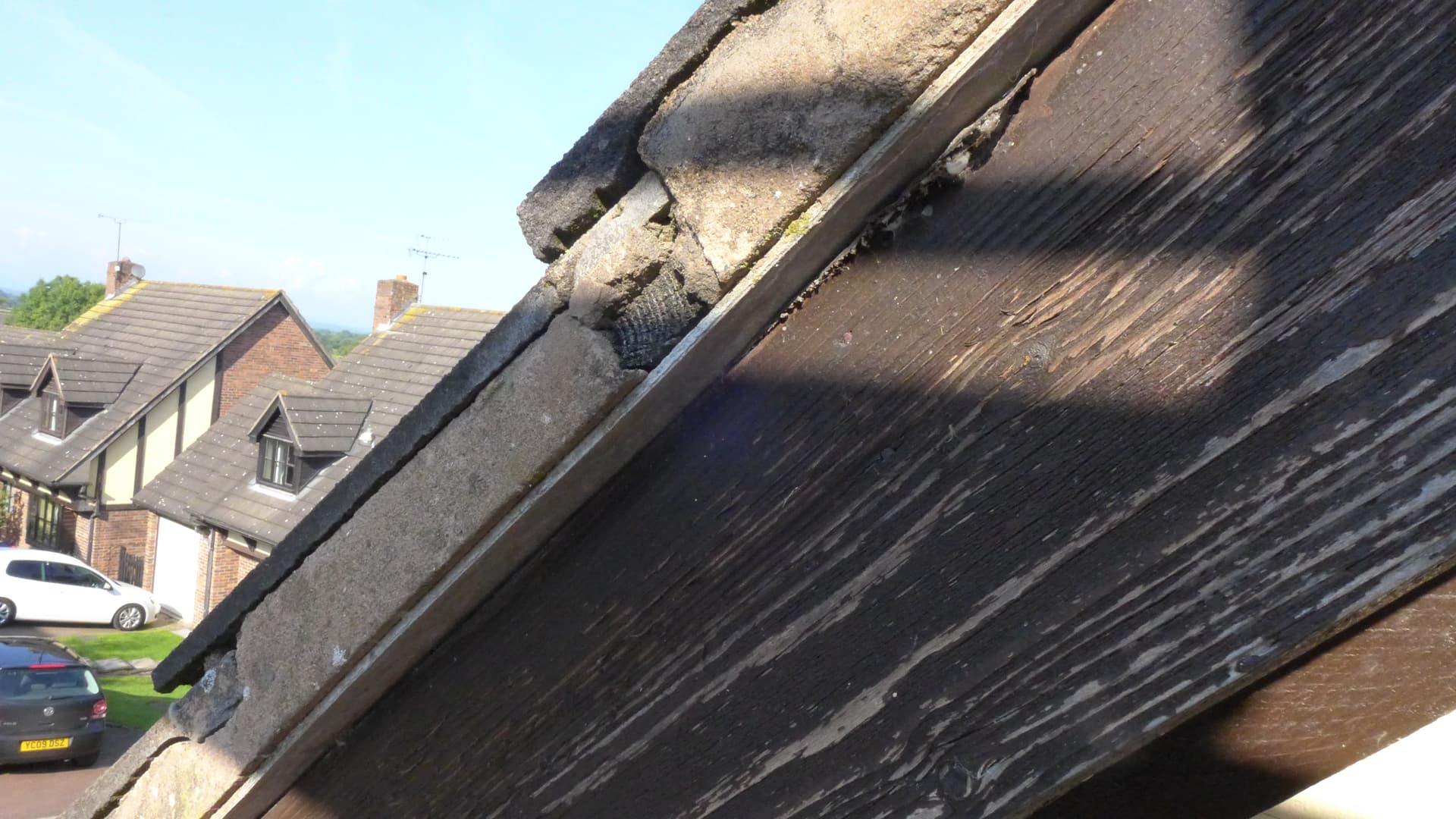

who built my house in 1989 were hopeless, they didn’t crop the tile batons in enough to give the mortar the required depth of room, hence premature cracking up of the mortar and then damp affecting the sticky-out roof batons - see picture below and weep:

@Debs – I think they tend to run the battens out that far to protect against wind-lift of the boards. I’ve got an over-hang > the fascia of ~40mm. You’re right, it doesn’t look great but the battens are above the membrane – and allowing a bit more room for the render to bite would be sensible.
Hi
The battens hold the cement board on so as the mortar mix can can be used. If they only used 100mm cement board which is probably the norm this is why the battens are near the end. They usually sit back about an inch from the end. I prefer the cement verge but I would go with the dry ridge system as they are very good & very low to no maintenance.
