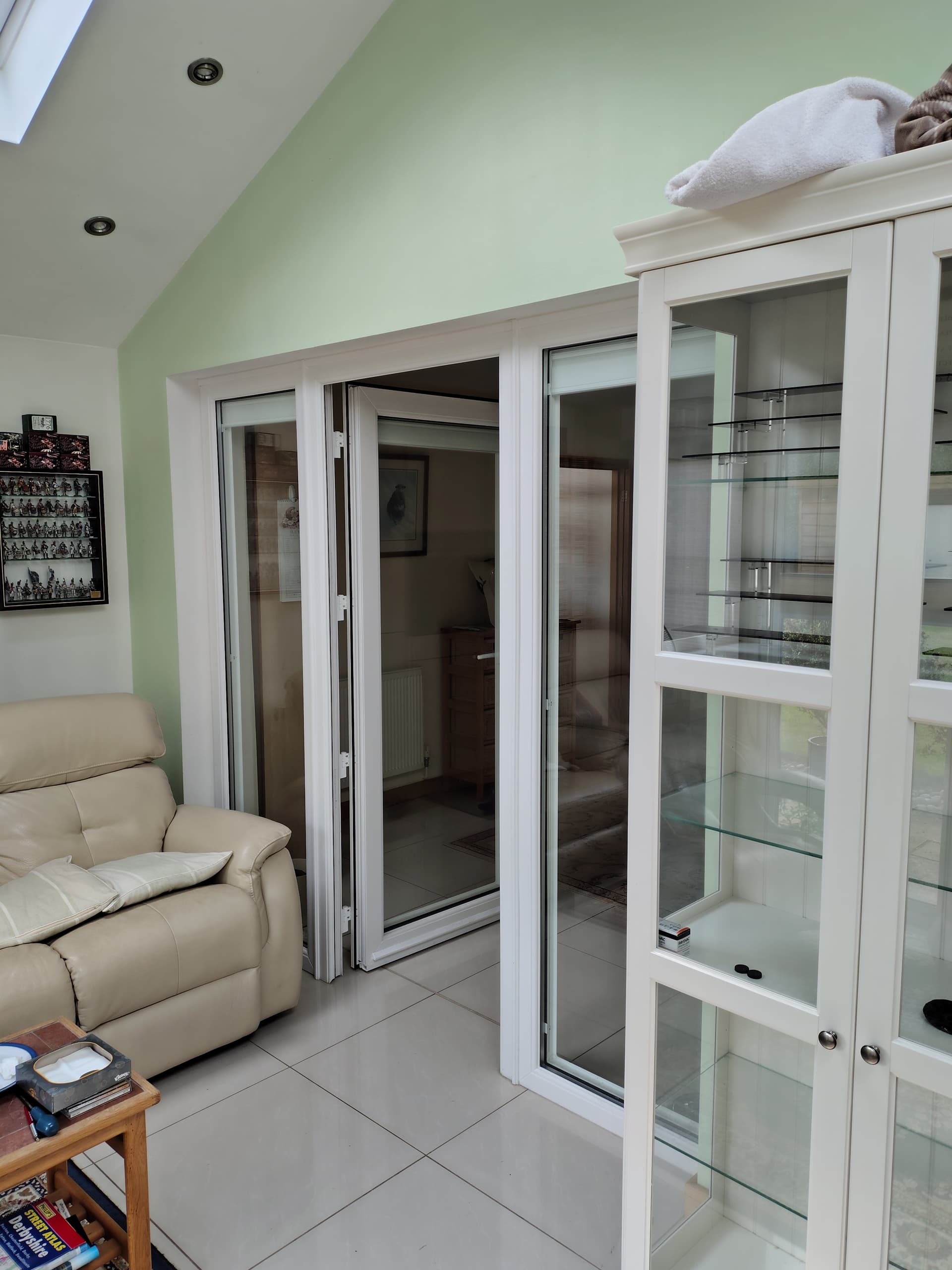

My room is 60% glass and my system Naim NSC22, Nap250, NPX300 and Linn Majik 140’s
I have problems with Sibilance on the treble with voice although instrumentation sounds lovely.
Most of the glass will be replaced with Laminated triple glazing at the end of the week, does anyone have any experience of this?
Will I need perfect fit blinds/Acoustic curtains?/Blackout blinds? I understand that too much treatment can have the effect of deadening the sound.

Are you able to post a picture of the room?
Showing where the listening position is and the glass areas?

The white glass cabinet will be moved elsewhere in the house and the CD racks will go where the cabinet now stands. Logic says move everything to the other end of the room but behind the settee is a radiator and the electrics are behind the Hi-Fi.

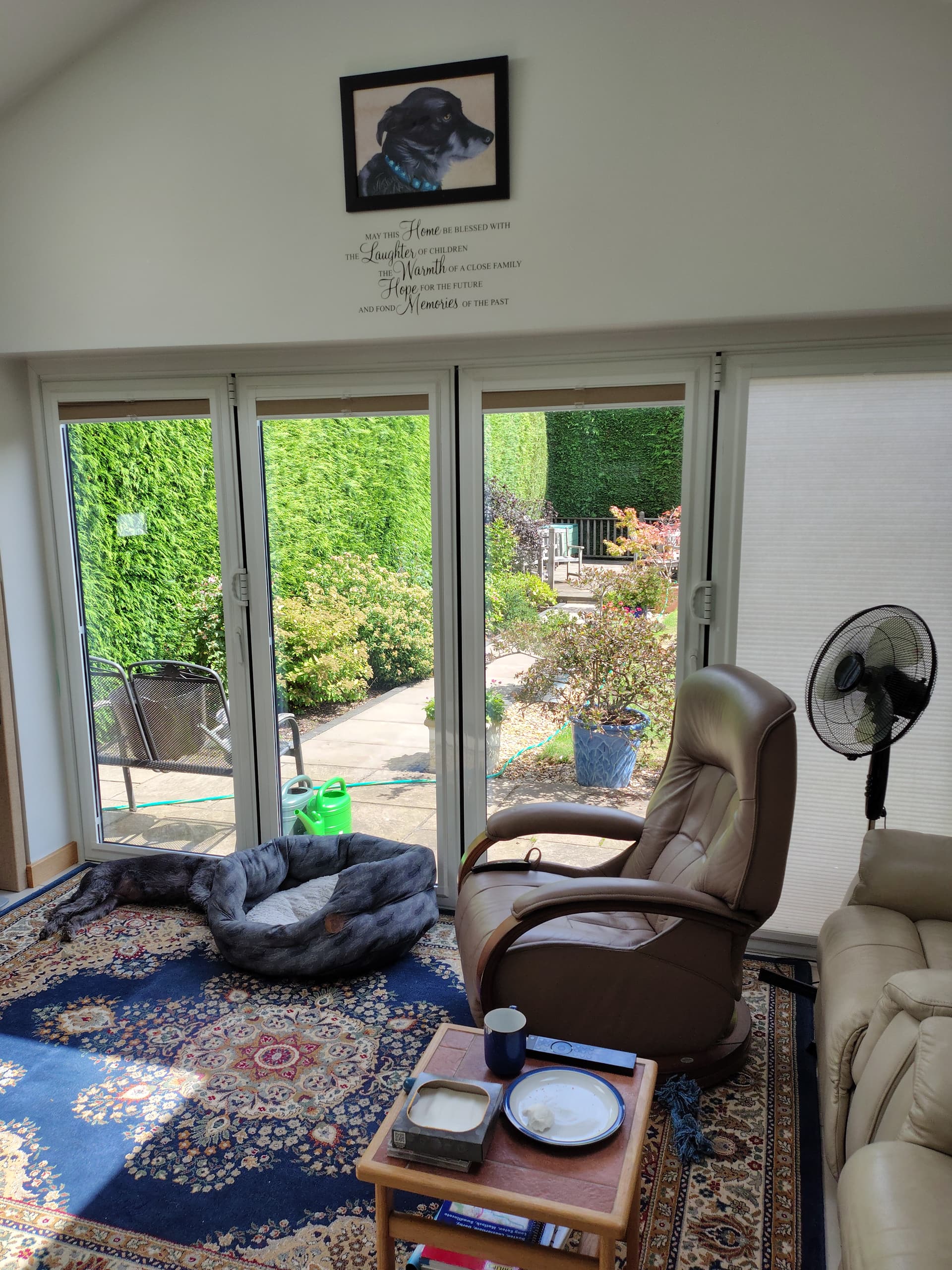

A very interesting response and maybe I am overthinking all of this and as you say just settle for things as they are and get some speakers to match the accoustics of the room. The carpet was a helpful addition a few weeks ago. Did you use acoustic or blackout blinds? or just normal shades for the double glazing? I have perfect fit blinds (as in the pictures) and anticipate doing the same with the triple glazing as they let in resonable light even when down. I will know at the end of the week if the triple glazing makes a difference to the acoustics.

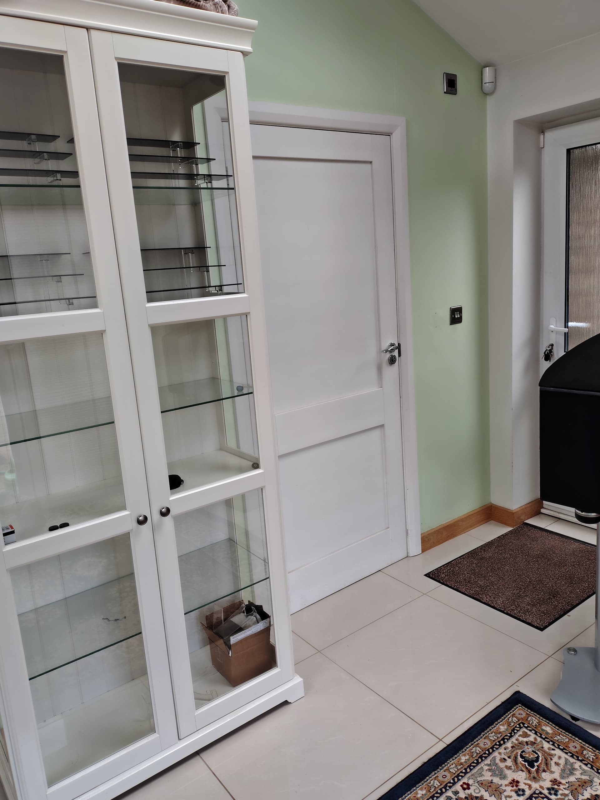

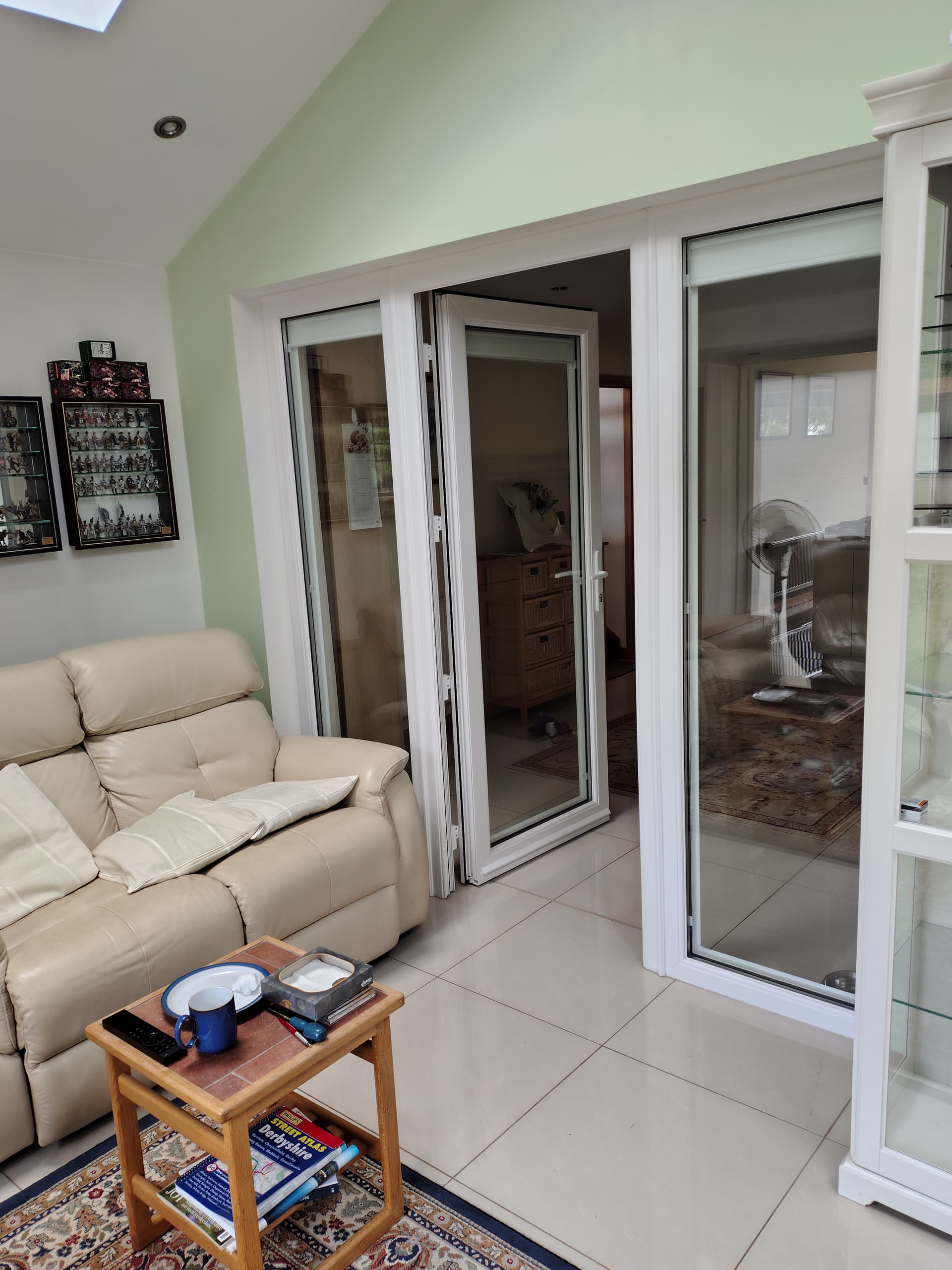

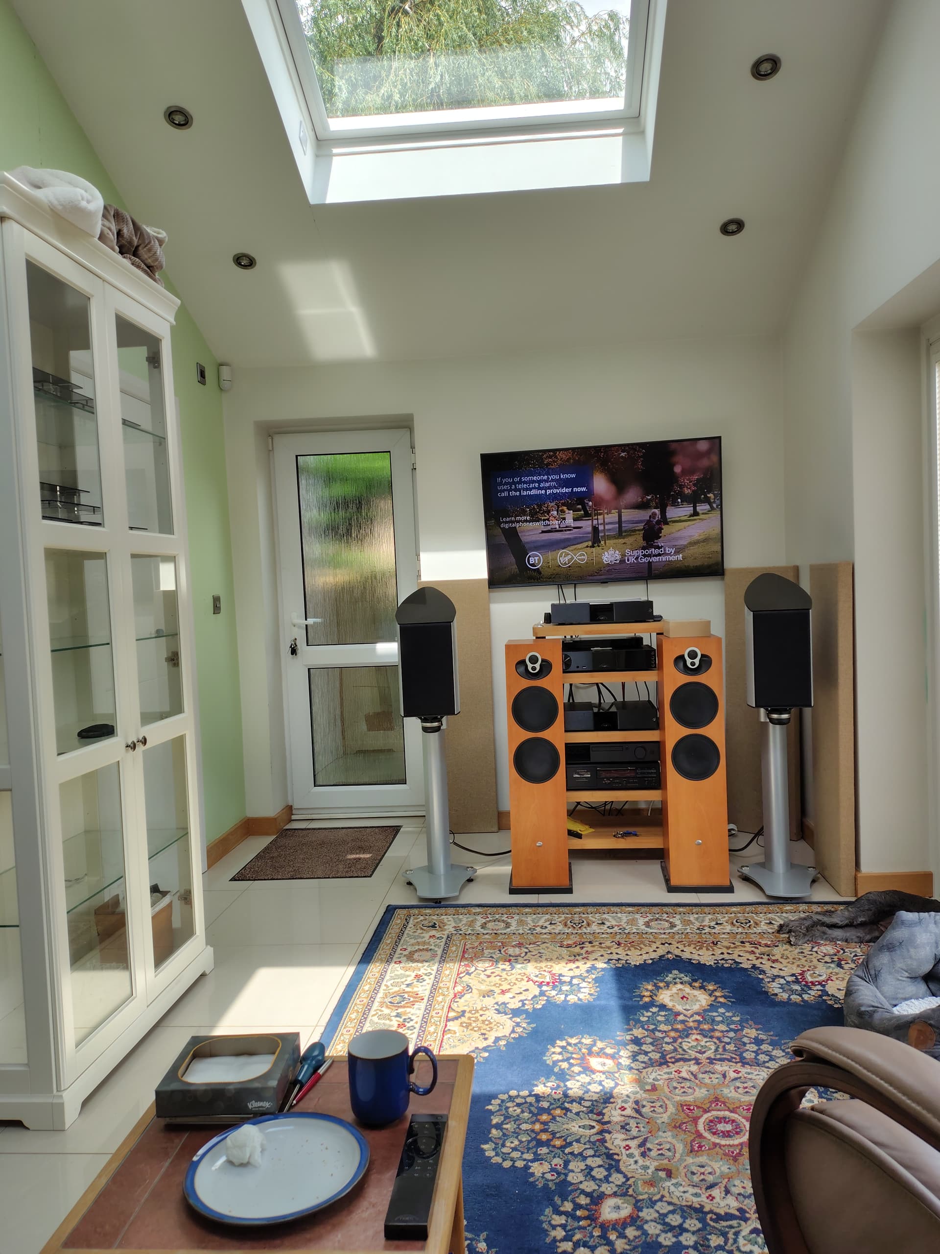

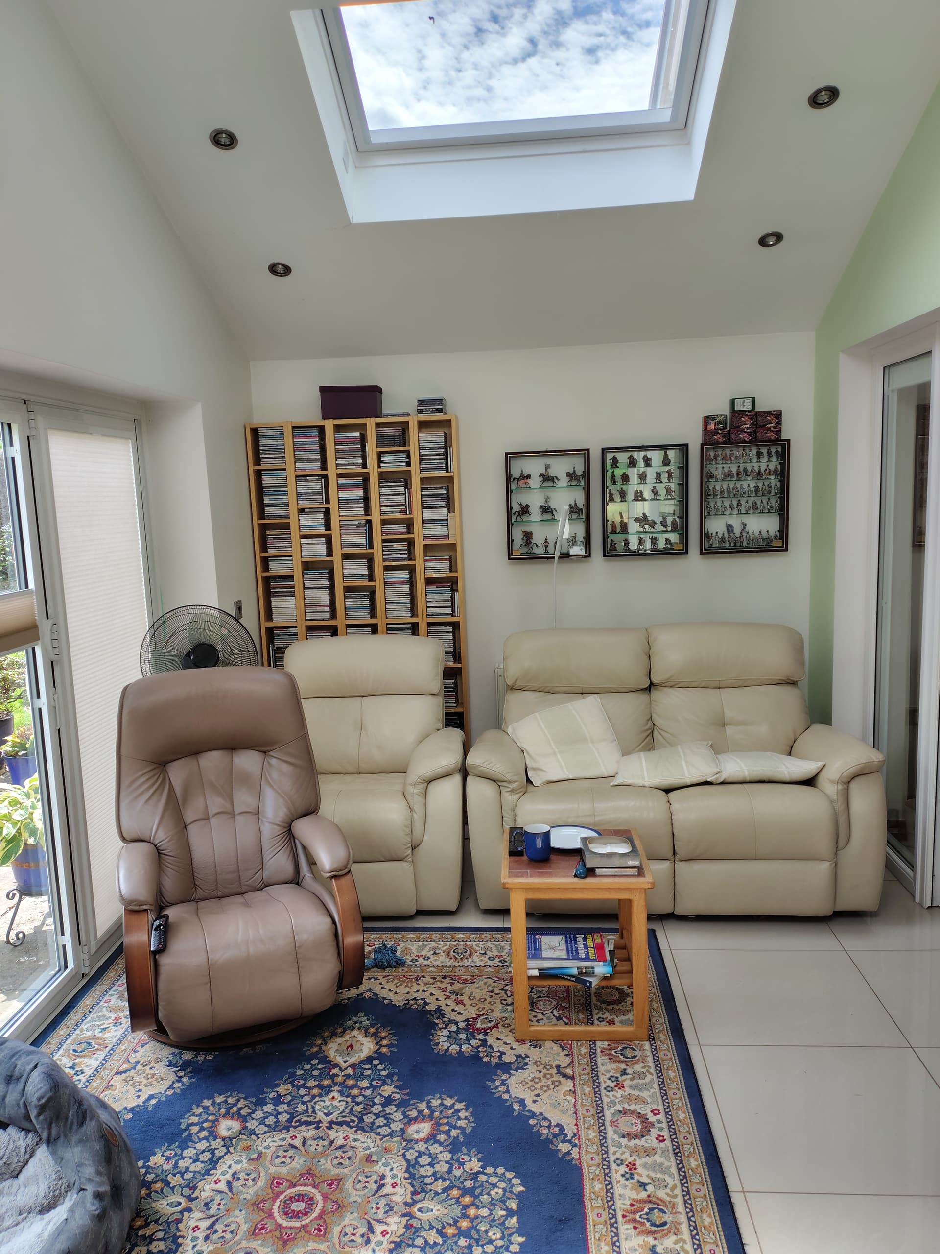

Hi, Thanks for posting these really clear pictures of your arrangement.
I am commenting on my assumption that the triple glazing replacement is only the glass to the exterior of the property?
I am not sure you have anything to be concerned about really. You have a vaulted ceiling which will help with spreading the low frequency room mode energy a little bit.

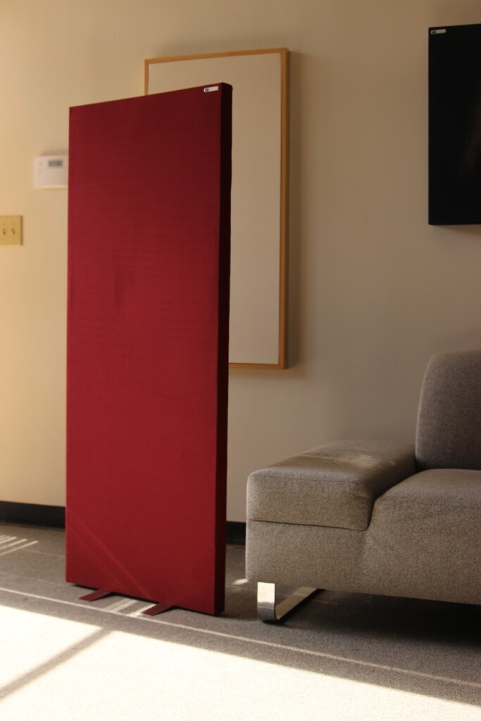

Personally, if I wanted to max the acoustic treatment I would target the first reflection from the side walls. To do this I would fit an attractive art panel absorber on the left wall where the cabinet is presently, and for the right wall glass area purchase a foldable screen panel absorber that self stands vertically that is folded closed and moved out of the way when not listening to HiFi.

Yes the new glazing will be the 4 fold opening being replaced with a pair of patio doors and glass panels either side. In 10 years I have not opened up the Bi-Folds due to inconvenience and weight, I fail to understand the trend towards opening rooms up to every insect and piece of dust floating around the garden…I know, I’m in a minority…LOL.

I would suggest something like 3 floor standing acoustic panels in front of the window, 1 in front of the door, and one different attached to left wall.
It can be removed in 5 minutes when no listening.
What do you think?
Do you really listen with the speakers SOOOOO close one on the other ???
And why are there two sets of speakers crammed together in that tiny space? That alone can not be helping the sound.

No! the WB’s are on demo and are in the usual location of the Linn 140’s.
Sorry for not explaining.
Had a similar issue in my new room with a lot of windows directly behind listening chair. I used wooden shutters on the windows. This had a significantly positive impact. Still allows majority of light into the room. The shutters can be tilted wide open to completely closed. I keep them 3/4 closed and this has created a diffraction effect which greatly improved SQ without completely blocking out light with solid absorber panel. A good compromise for me. Your ceiling window is in a primary reflection point - try the shutters there as well.
