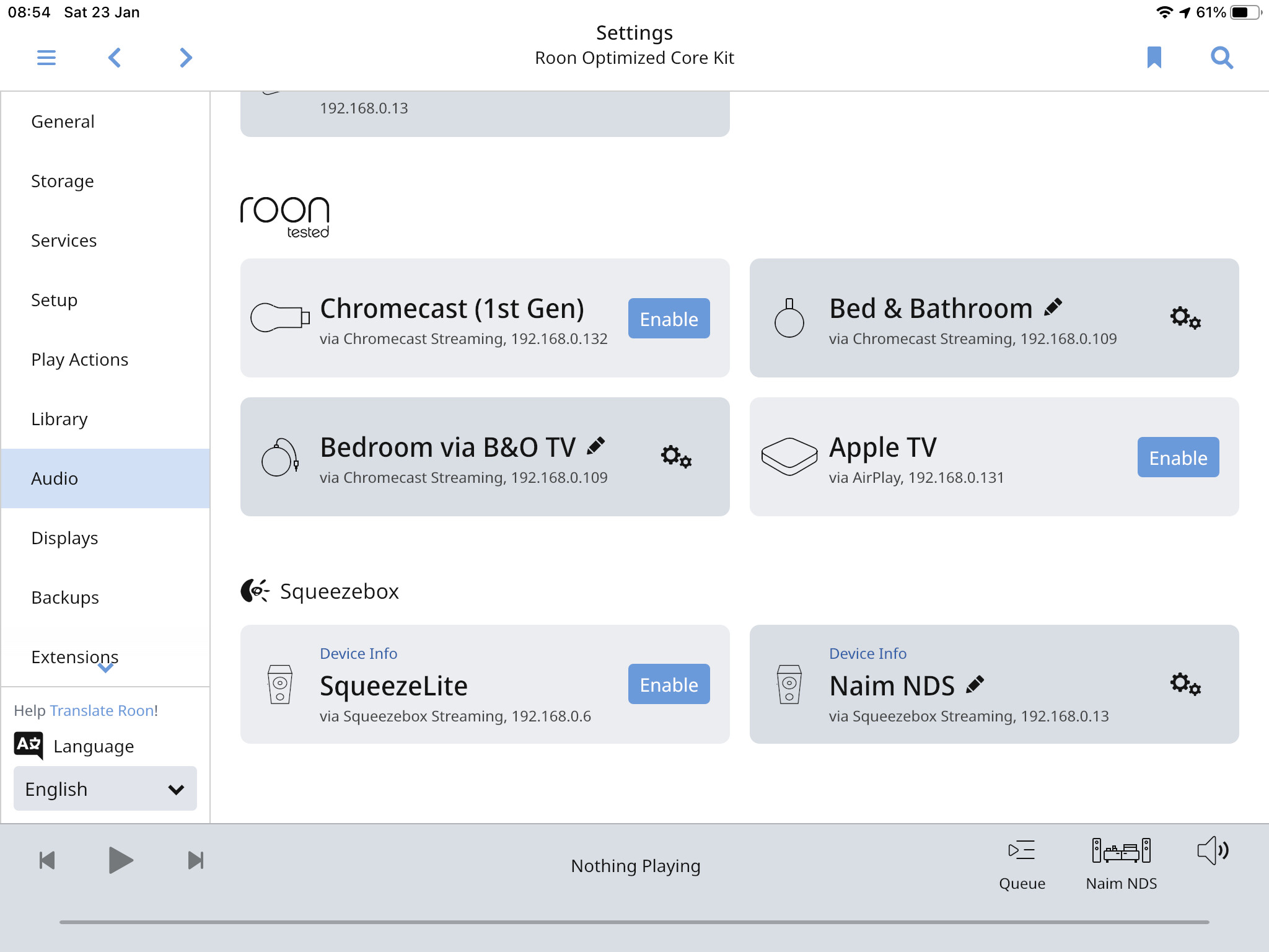

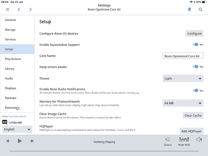

In the Roon Core settings, have you enabled Squeezebox support?
The SonoreUPnP Bridge uses a software implementation of squeezelite, so Roon will only detect it once Squeezebox support is enabled.
This the setting in Roon Core
Then in Audio you will get the Squeezelite based endpoint

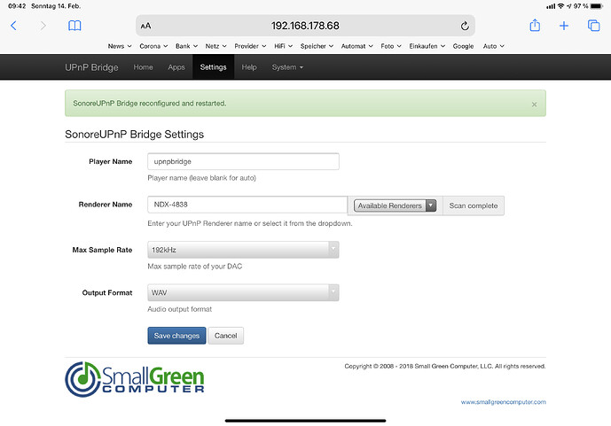

Try rebooting the sonore upnp bridge then go to settings and choose your renderer.
