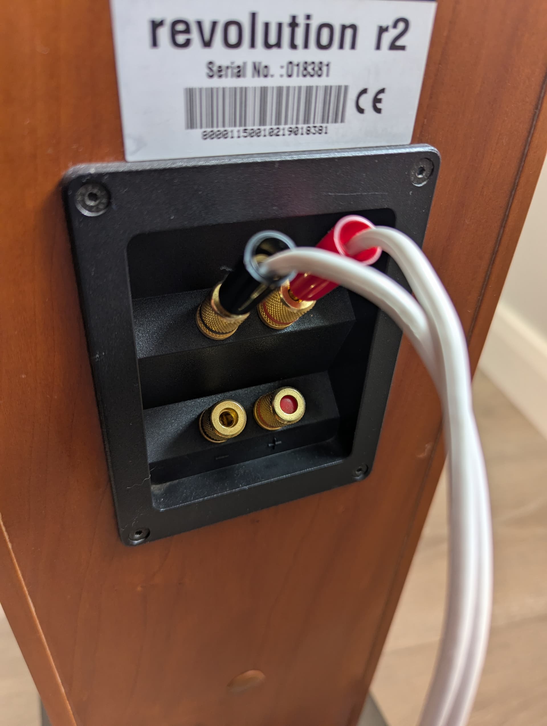

Anyway, I studied the crossover which is in two parts - a main 2 way board for tweeter and mid-bass driver + a second board for the 0.5 bass driver. The speaker has biwire terminals - the top set goes to the 2 way board, the bottom set feeds the 0.5 driver. I decided to remove the terminal links (speaker wire) and just feed the top section, leaving the bass woofer to effectively act as a passive radiator (PR) - which it certainly does.
The net effect is a brighter and clearer tonal balance (not surprisingly) but the bass response is more full than I expected - perhaps aided by the redundant bass driver acting as a PR. I tried it with the supplied foam port bungs both in place and removed and I preferred it without. The speaker certainly sounds quicker and more punchy which to me suggests that there was something strange about the original output level and/or phase response where the 0.5 driver was involved.
