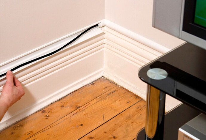

Mini D line trunking is what you need. Though the junctions in corners can be fiddly.
This kind of thing;
