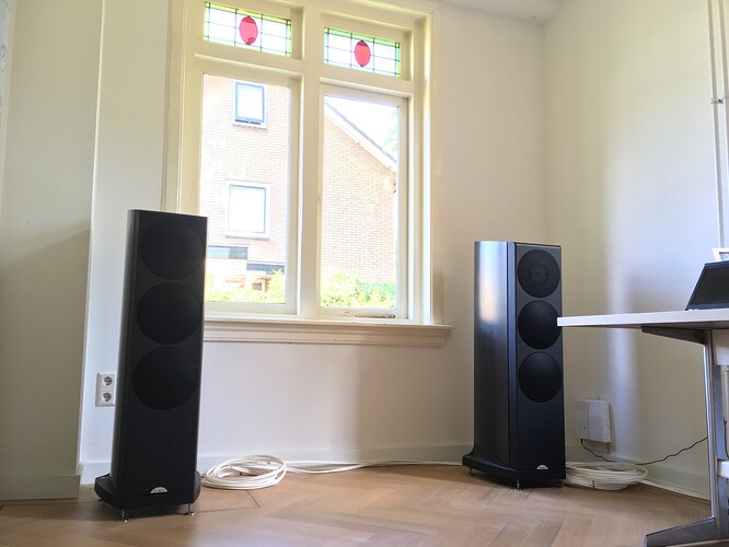

These are mine (shock horror, coiled cables, too close to the wall, desk in the room), they have shifted a bit:

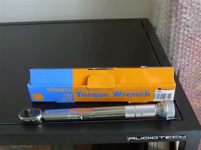

@Darkebear: do you have a recommendation for a torque driver? I can go to the shop and buy a random one, but many times there are types around which are preferred for usage with Naim gear.
I have this. However i’d prefer one with digital scale or more convenient reding scale.

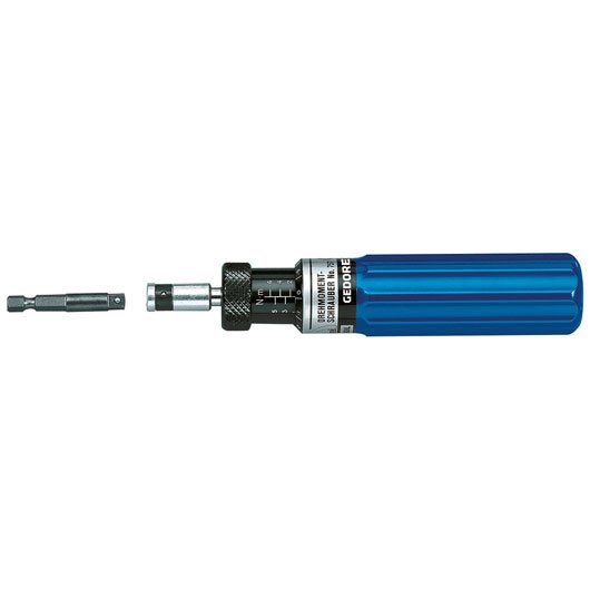

I borrowed what my Dealer used - then was so impressed I got my own one for the very occasional times every few years I’d use it:
Also get a set of bolt-heads and find the one that just fits snugly without rattle in your speaker bolts and use that for the job.
I use one of these that covers 1 to 5 range - you only need 2 to 3 for the Ovators.
From memory the Bass driver bolts were 3 and the BMR a mix of 2 and 2.5 - and the underneath a mix of 3.5 and 3. Naim or Dealer should be able to give you a PDF or sheet with all this on an exploded-view of all the bolts - I’d rather personally just confirm to do it to their values. More is not better - more usually sounds horrible and in extreme breaks the thread, so you need enough to tension the housings such that their resonant-modes are as intended by the design.
My advice is not to touch the BMR assembly itself, but do the front and rear housing that fixes it to the main box. Too tight and it will sound dull-blunt, too loose also dull-blurry - nearly right but loose zinging brightness - then just right sounds …just right!
