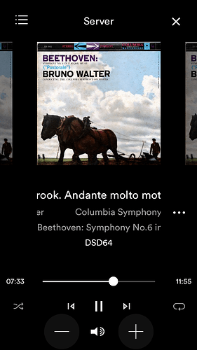

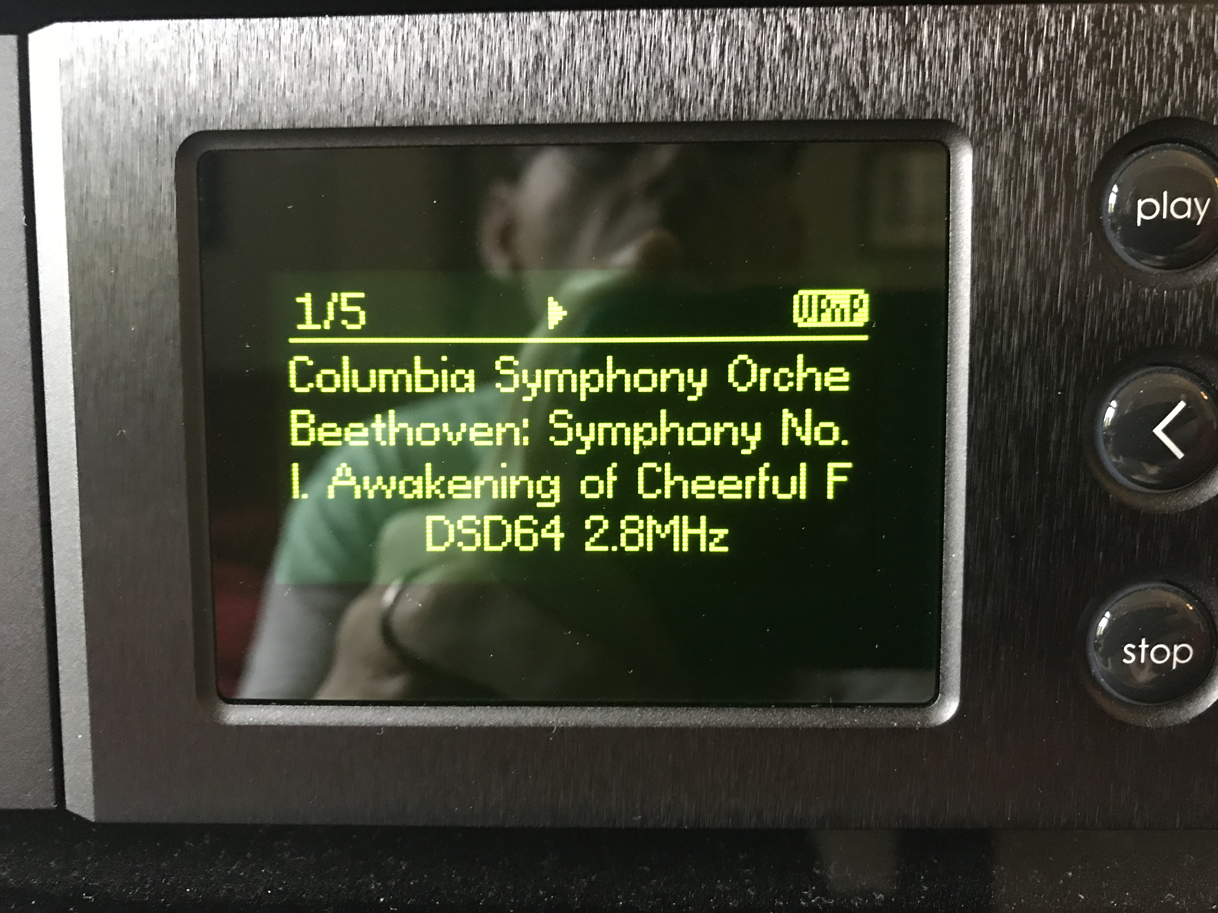

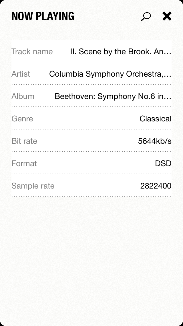

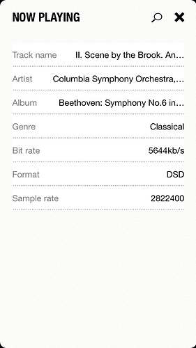

IainO – The most important thing is that you are happy with your outcome/sound. However, I don’t know why your 272 would not read your DSF files. It certainly has that capability. Also, although I am not an engineer, I don’t think the 272’s spec with regard to PCM has anything to do with DSD, since DSD is not PCM. The “64” in “DSD64” refers to the native DSD format having 64 times the sampling rate of the Red Book CD PCM spec (albeit at 1-bit resolution vs 16). If you look at my attached photos, you will see my 272 handles DSF files. The last shot is especially telling (it is from the “Open Booklet” function in the Naim iOS app). Lastly, unless I’m missing some information or misunderstanding, converting DSD to FLAC is unnecessary for your system, which leads me to ponder whether your “native” DSD/DSF files are what you think they are. (With all due respect.)
Many thanks for the screenshots, made me revisit my thought process.

By the way, were your system stat readouts when playing DSD64 like my screenshots, or did you see something different? Just curious.
