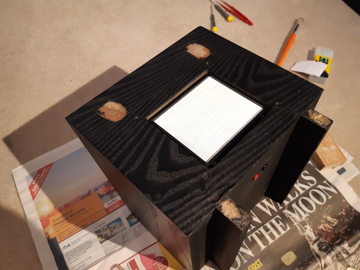

I filled the original holes with ronseal as instructed and rubbed down:

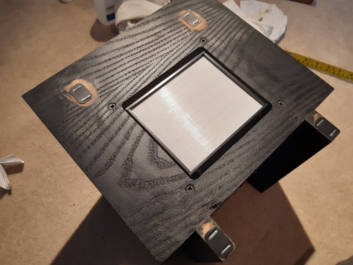

Then stapled the new aluminium pads:

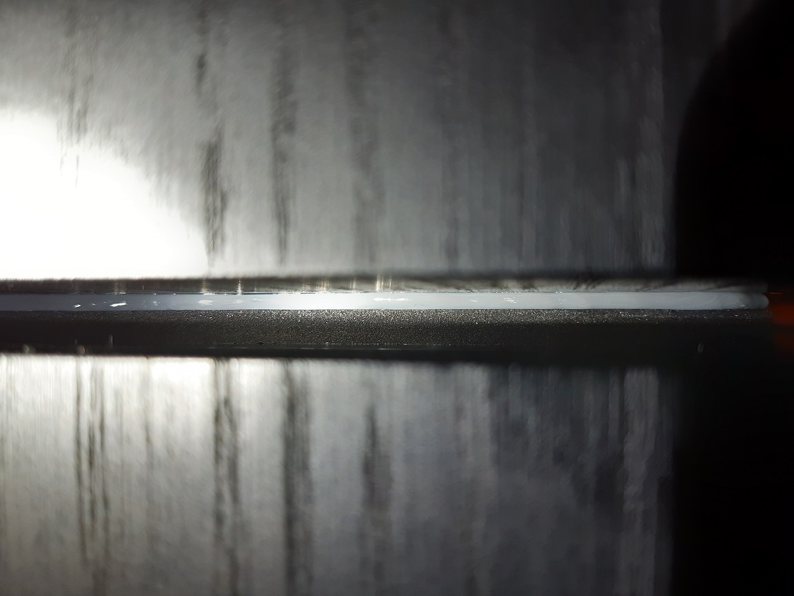

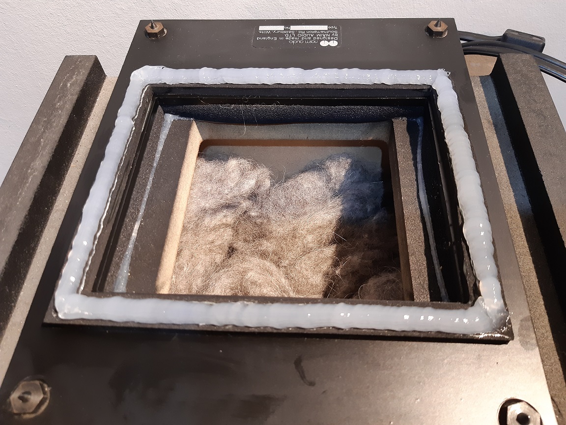

Next, laying down 6mm wide silicone:
Before finally locating the mid/bass unit on the spikes and re-forming the seal:
The only tricky part was when I found that one of the mid/bass units didn’t sit level on the spikes and rocked - it wasn’t the unit cos it was fine on the other base so must have been the spikes - probably only half a mm but it needed sorting. I had to sand down beneath one aluminium pad to get it to sit flat without rocking. This also explains why one of the splikes had completely pierced through one of the pads when I bought them.
