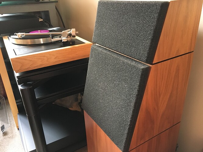

My front end si a TT Rega P6 (new model) with Exact…
My room is the living room (7mt x 3mt)… system on the center of the long side… i listen at 3mt and the distance beetwen the speakers are the same (3 mt)… so perfect triangle…
The wall is very very solid… so i think no problem… but it’s the same where i have placed the TT shelf…
A Rega P6, good room size, and a solid wall, sounds very promising : )
You could consider moving the rack & TT shelf further away to another wall [but avoid corners] and use longer NACA 5 if necessary.
Unfortunaly i can’t move the rack and the TT anywhere…
Do you think i can try anyway?
With a smaller size NAP [ 200 or smaller ] i’d say yes.
With a bigger amp [ = more bass ] it maybe feasible to compare the TT on a rack shelf if the floor is concrete vs wall shelf, but only one way to find out : )
Which TT shelf have you got?
SX466
These one… Pro-Ject 3861 Wallmount 1
