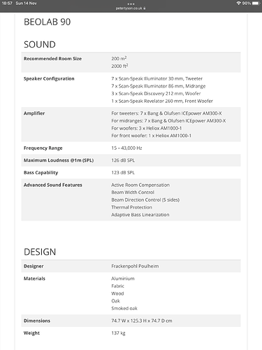

They are quite something. These specs are from Peter Tyson - I assume they are accurate.

Curious, the maximum bass output (it doesn’t state over what frequency range) is half the ouput power of the overall output - so at ultimate peak level there will be power compression or distortion at the bass end. (I’m assuming that at lower levels the bass output matches the rest of the range?)
Of course it is likely to be academic in smaller living rooms even at realistic listening levels as only the Telarc 24 bit version of Tchaikovsky’s is might hit that, however could be significant if played in uk typical(!!) living room of 2000m2…
