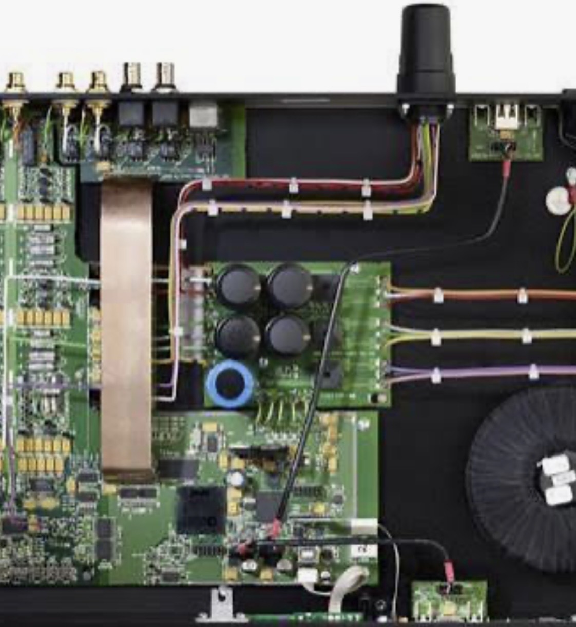

Well, that is what naim have told us, but have they actually tried to do a service? As we know a number of naim products are now being revealed as being “ unservicable”. NDS, Superline……reasons tend to be around poor design of their PCBs. Naim are also now telling us that some items ( ndac) dont need service. For that I read that they cant, rather than they dont need it. Items that contain caps, degrade. We all know that, yet naim have designed PCBs that make cap swapping near impossible.

Naim’s tune on servicing changed a couple of years back when they realised they couldn’t service their own designs. Some due to part supply and some due to design of their own PCBs.

naim and dealer both said nDAC didn’t need a service when we bought ours a few years back now.
However, they did replace the PSU caps when we pushed for service - although they said being a low power device there is little load related degradation (2011 box).
The rest of the device was inspected and everything found shipshape so left untouched.
I believe current naim guidance for the nDAC is send to service on fault only. Which is what we were told, but asked to ignore, several years ago!
We really just wanted peace of mind.
The band 7 service charge should put most people off a service - was almost as much as the box cost us.
We would be gutted if ours had a real fault and couldn’t be repaired, but being realistic it is nearly 15 years old. Trouble is it sounds so damn good.
I suspect it’s all a balance. The psu caps ( 2 from memory) will degrade and benefit from exchange at some point. The time/trouble/cost will likely put 99% of people off. I will likely exchangethem myself in a few years.
The Ndac is another of those naim items that improves with a better psu, be that xps or 555, so the benefits of changing the psu caps must be significant for thise that dont use an external psu?
Well, nDAC uses internal power for some sections EVEN if you use external PSU. 2 powerlines required :laughing:
I think the big caps in centre will be what were changed out at service. Pretty sure service sheet just said “PSU caps” or similar.
So not unused even with 555DR connected. Hence why we wanted them checked and changed in line with the 12-15 year recommendation for other classic boxes.
Without an external PSU these feed analogue board too, obviously.
