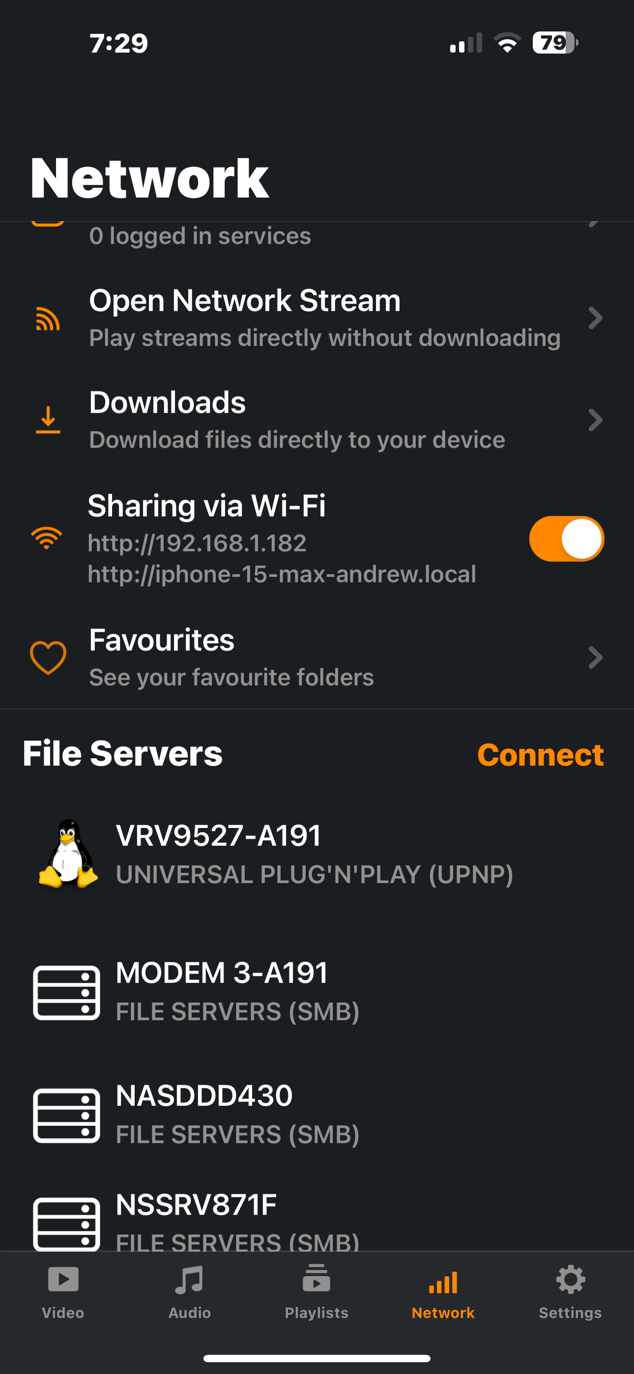

I have downloaded VLC and can see them both. O problem so happy they are running ok in server mode. Also I have run net Analyser and can see both albeit no “u” is showing next to them.

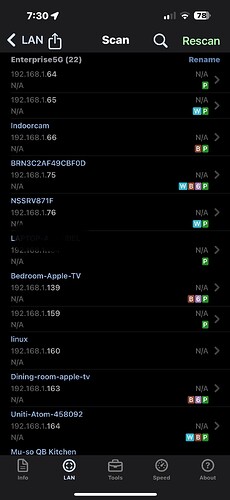

Tried as suggested sequence and this has not worked. The only item I can see is a hard disk attached to my router USB which does surface by I assume the UNPN - this was available before. The VLC app as mentioned prior can see the QNAP and Unitiserve. See pictures below

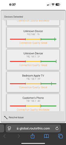

Try running the network scan option in the Naim app. Go to the “rooms” screen (where it lists your nova, qb etc), click the ? in the circle, scroll to the bottom.
Thanks I ran this now and it can see the Unitiserve IP connection below but does not recognize it as a name product see screen shot below …76. Where to next?

According to VLC, everything else is just file shares (SMB). You will not see those one most current Naim streamers. (Not sure e.g. about Star, because it can access file shares to access storage for ripped music.)

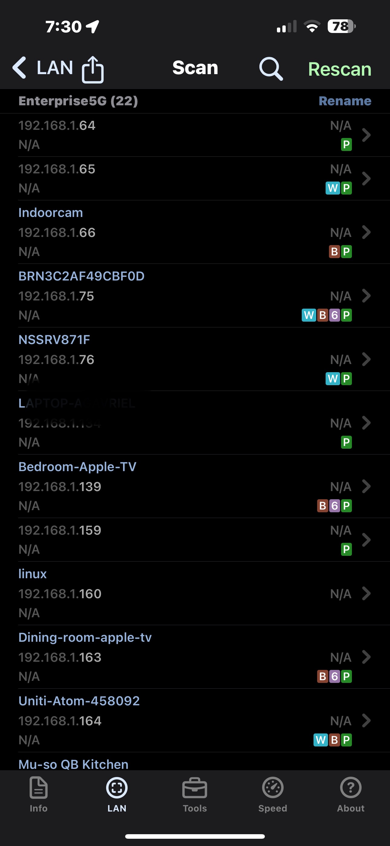

Have done this see post and screen shot
Any further options to investigate? The unitiserve should be showing as. Upnp server when looking at it from the other Naim items I have. The other tool does not show net analyzer tool does not show a “u” next to the US.
